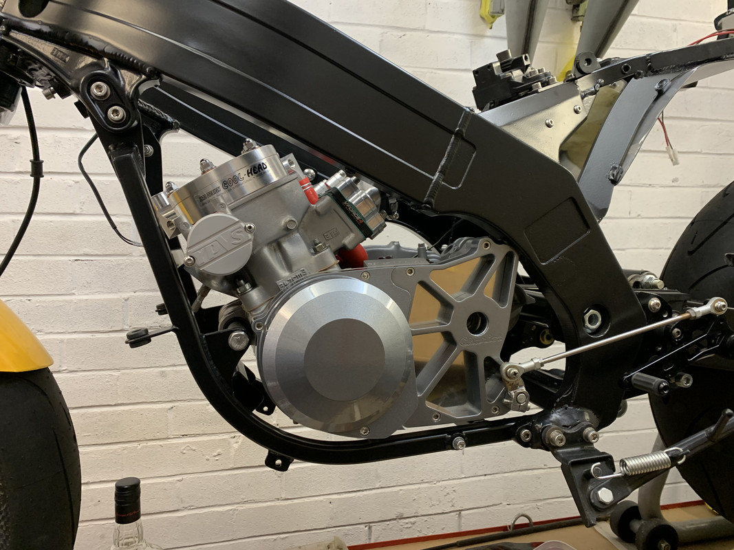

The engine is in. So hopefully some good progress will be made now The gear shift arm will be changed π³π

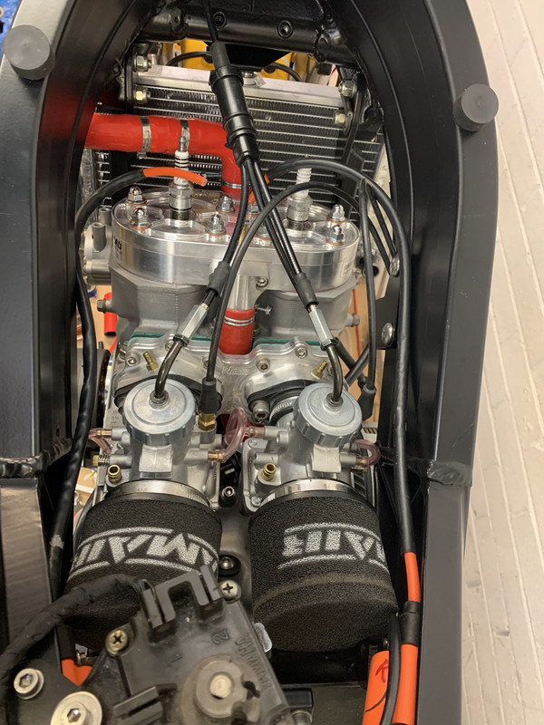

Post by botty on Dec 13, 2020 2:55:11 GMT 1
New parts , refurbished parts , old parts. Coming together now. The dark side is looming........ wiring π¬π¬
Post by botty on Dec 25, 2020 18:50:13 GMT 1
Late night, early hours got the carbs, filters and cables sorted

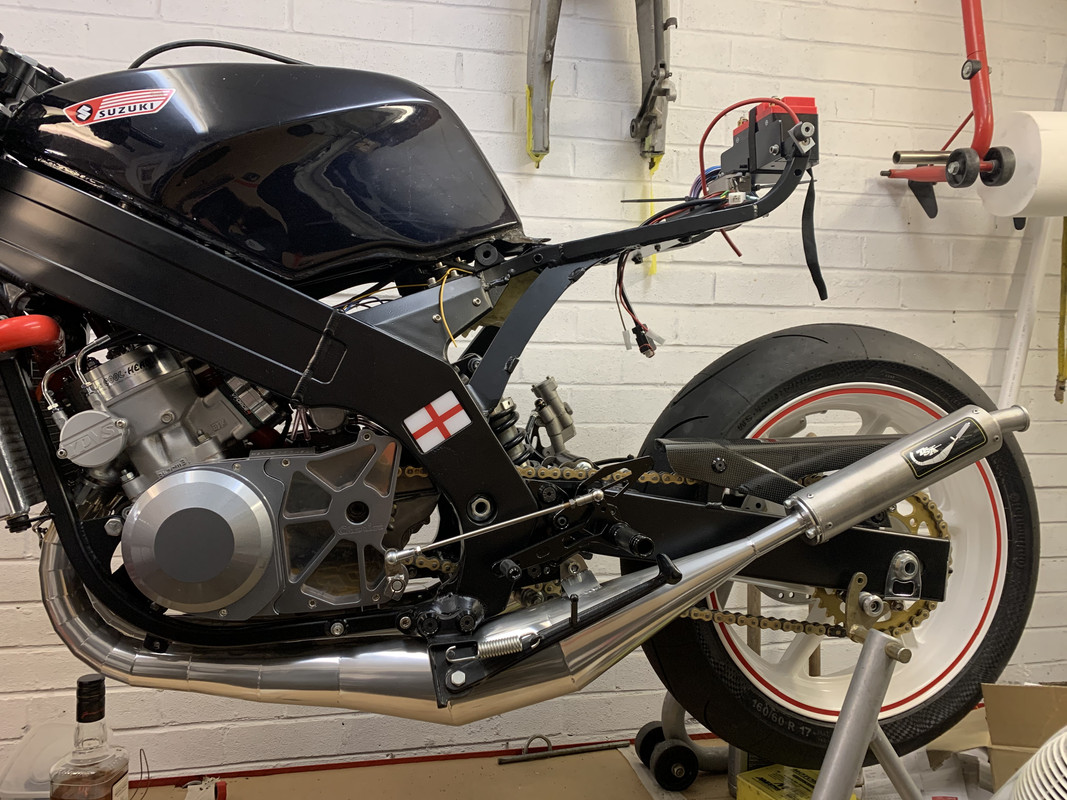

Post by stusco on Dec 25, 2020 19:01:07 GMT 1
Thats a big looking front sprocket
Post by rich on Dec 25, 2020 20:25:35 GMT 1
Thats a big looking front sprocket 17t is standard size. Maybe looks bigger as it's offset?
Post by dusty350 on Dec 25, 2020 20:28:35 GMT 1
Looks like a Talon. 9mm offset ? Dusty
Rgv Ypvs
Dec 26, 2020 1:12:28 GMT 1
via mobile
rich likes this
Post by botty on Dec 26, 2020 1:12:28 GMT 1
Thats a big looking front sprocket 17t is standard size. Maybe looks bigger as it's offset? Glad you said it was standard size.. I doubted it for a minute. ππ
Rgv Ypvs
Dec 26, 2020 1:13:11 GMT 1
via mobile
rich likes this
Post by botty on Dec 26, 2020 1:13:11 GMT 1
Looks like a Talon. 9mm offset ? Dusty Correct ππ

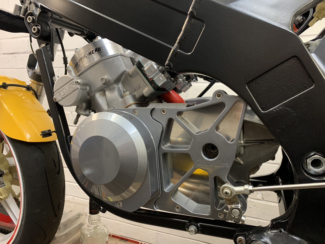

Post by 4l04ever on Dec 27, 2020 14:29:29 GMT 1
Make sure to run an earth from the engine to the frame/battery earth, as the Power dynamo has no earth connection to the engine, whereas the OEM loom does.
Rgv Ypvs
Dec 28, 2020 1:49:07 GMT 1
via mobile
Post by botty on Dec 28, 2020 1:49:07 GMT 1
Make sure to run an earth from the engine to the frame/battery earth, as the Power dynamo has no earth connection to the engine, whereas the OEM loom does. Taken on board and noted Robπ Will make sure I do this.

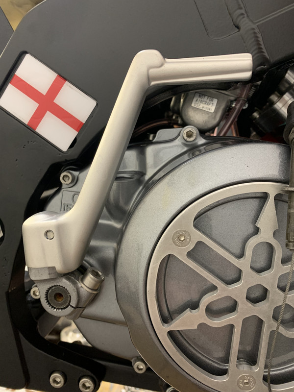

Post by botty on Jan 30, 2021 21:11:43 GMT 1
Earth done Rob. A bit more progress

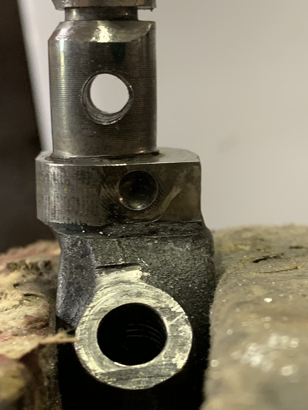

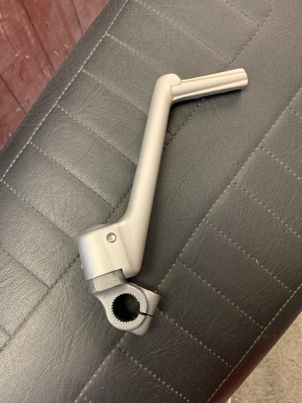

If anyone is thinking about doing the Yzr alloy kick start swap. Make sure you have some quality drill bits. I trashed two Dorma bits drilling the knuckle. Itβs case hardened. Then you need to chamfer the groove to accept the bolt All done now
Post by botty on Feb 7, 2021 16:03:09 GMT 1
Happy with that

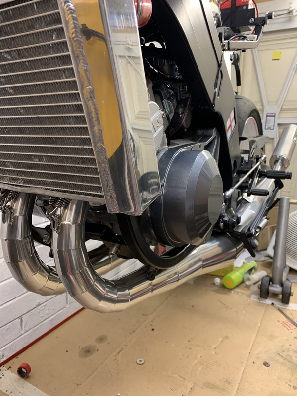

Post by botty on Feb 9, 2021 16:44:21 GMT 1
Today is a good day. Got my pipes back from Camcoat. Had them Ceramic coated Plus my oil pump came back from Arrow ππ image sharing
avb
andys vapour blasting
Posts: 389
Post by avb on Feb 9, 2021 22:17:15 GMT 1
nice me likey shiny
Post by Tobyjugs on Feb 9, 2021 23:24:19 GMT 1
Hi Botty are you going to fit a de-aeration line in on the highest point of your engine? The fitting in this picture is no good, it was replaced with an elbow.
Post by botty on Feb 10, 2021 0:25:43 GMT 1
Pipes are looking good. Happy with them π
