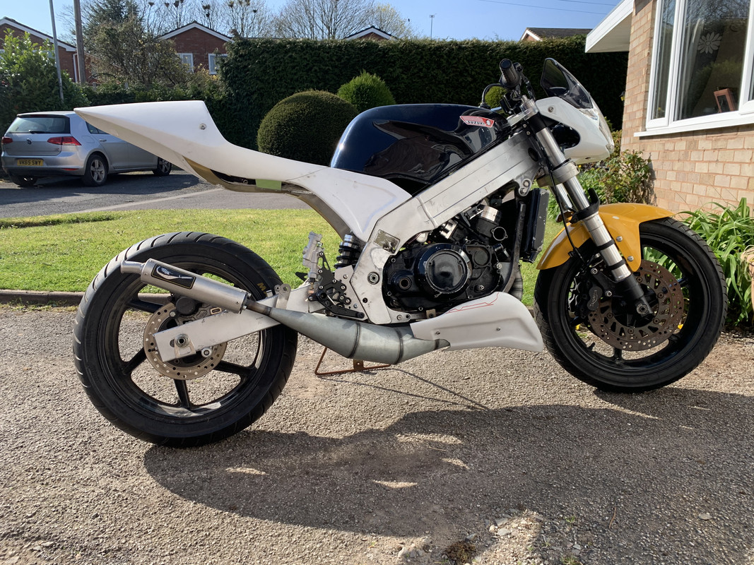

Here are a few pictures of my project. Getting a fair bit done in lockdown. Not able to get the outsourced work done. Waiting for parts to be delivered too.

That is looking nice.
Same story here too. Getting lots of things done but spending too much time waiting on the postie delivering stuff.

I opened this post with some trepidation’yawn another rgv hybrid well blow me down this has the potential to be pretty bloody awesome and not yet another rgv hybrid 👍
Post by donkeychomp on Apr 24, 2020 21:59:07 GMT 1
Really like that. Hurry up and finish it lol.

I opened this post with some trepidation’yawn another rgv hybrid well blow me down this has the potential to be pretty bloody awesome and not yet another rgv hybrid 👍 😂😂😂. I know what you are saying. Done to death . Looking forward to getting this one done

Botty Did you make your own pipes and if so, can I steal the dimensions from you Cheers As Jon says they are TSA. Contact Kenny.
Post by steeley on Apr 27, 2020 13:58:57 GMT 1
Kenny is a good exhaust builder , one day i will ask him to build me a pair of cross overs for the LC .

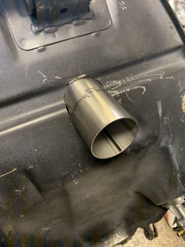

Post by botty on Jul 17, 2020 20:51:29 GMT 1

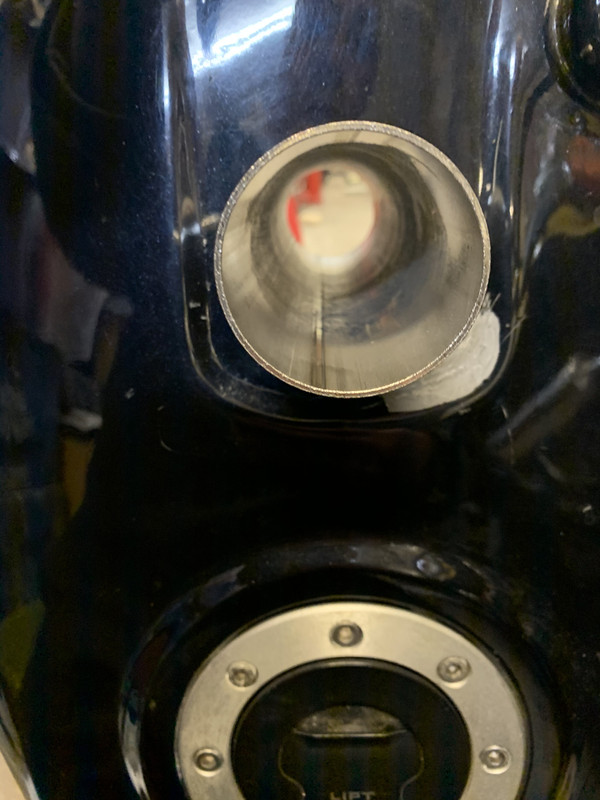

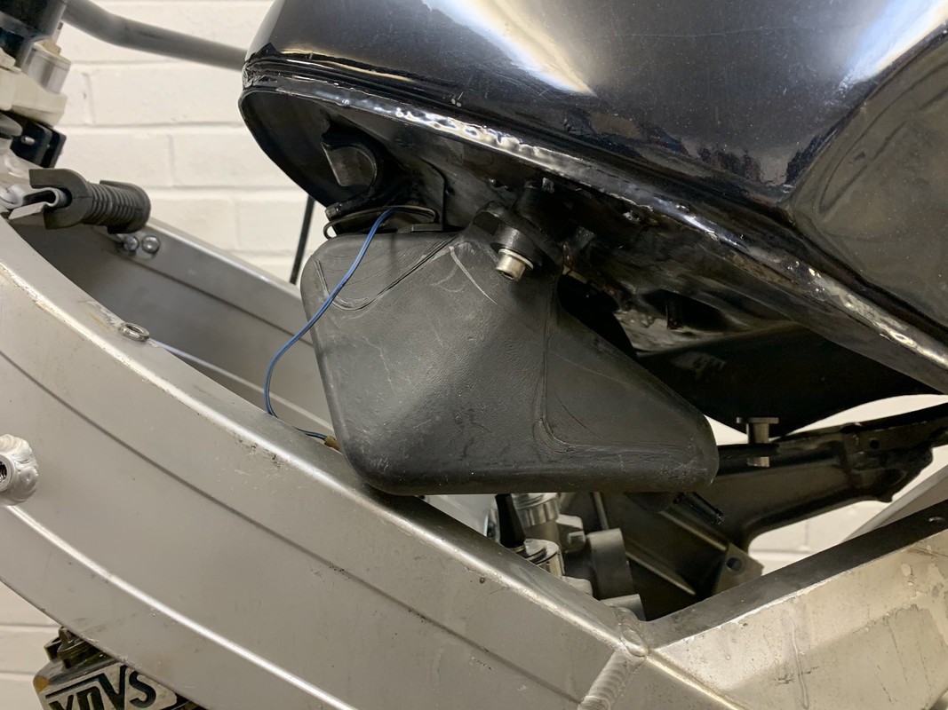

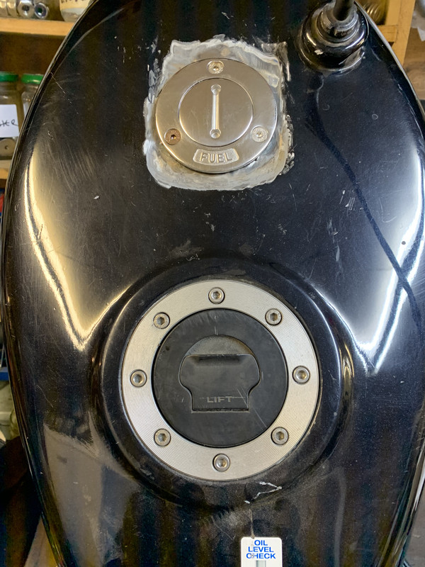

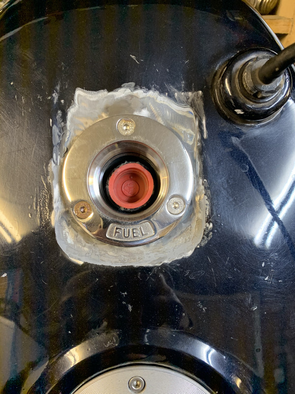

Using the Tyga seat unit, means you have to lose the oil tank. Not really an option for me personally. I’m pre mixing my Tdr. I know all about the pro’s to it. So I needed to fit an oil tank somewhere. I have gone Gamma ‘ ish. Fixed an oil tank to the underneath of the fuel tank. The tube was welded into the tank to allow a void for the oil tank filler pipe to pass through

Love that solution on the tank A lot of people would just go with premix for ease, but I love that you have engineered a proper fix for an autolube system. Looks trick too Dusty
Post by Tobyjugs on Jul 18, 2020 8:43:00 GMT 1
Great idea.

Post by botty on Jul 25, 2020 0:21:24 GMT 1
It was a bit scary cutting two big holes in a perfectly good tank. Ideally need to do a pressure test on it. Rig up a manometer some how.

Love that solution on the tank A lot of people would just go with premix for ease, but I love that you have engineered a proper fix for an autolube system. Looks trick too Dusty Pre mix isn’t for me personally. I see the logic, but no.

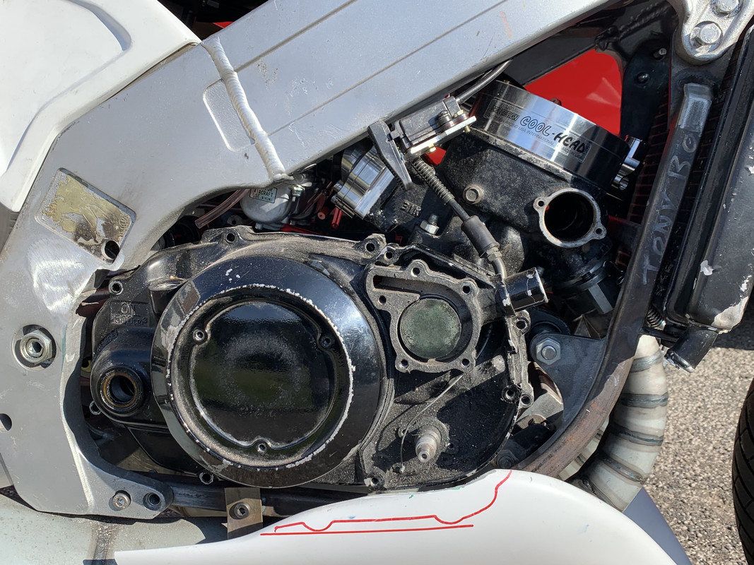

Slowly but surely. Waiting on motor to come back with squish sorted.

I love all of it, but I particularly like those forks They look awesome It's gonna be a stunner Dusty Yeah the forks look ace. My mate fitted them on a hybrid and I copied him 😳. Looking forward to getting this one done. If I enjoy this one as much as I do my Gamma. I could be letting a couple go. I have an itch for a JCW Mini.

That rolling chassis looks perfect.
Post by JonW on Aug 17, 2020 0:27:35 GMT 1
What are the forks off? I assume a Honda?
