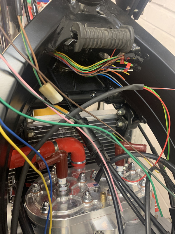

Hi Botty are you going to fit a de-aeration line in on the highest point of your engine? The fitting in this picture is no good, it was replaced with an elbow. I think Iโm going to tap the fitting to accept a bolt, or just bung it. Bleed the system then block off with one of the above methods.

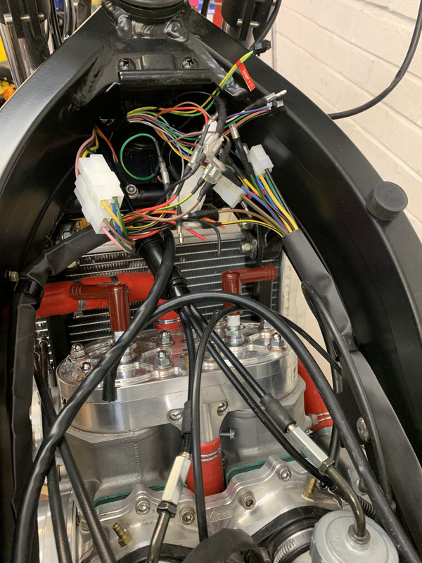

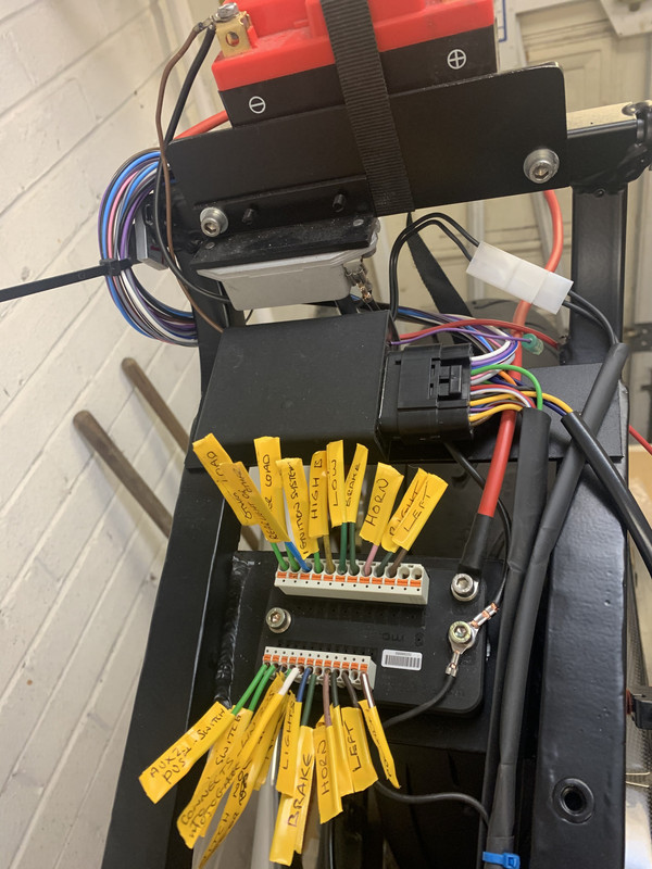

Marked the different ports on the M Unit. Trying to make sense of it without reaching for a magnifying glass every two minutes. Stated to make a loom for the input side. All negative feeds
Post by JonW on Mar 3, 2021 0:30:21 GMT 1
Loving the work on the wiring! Super job.
Post by botty on Mar 11, 2021 18:51:44 GMT 1

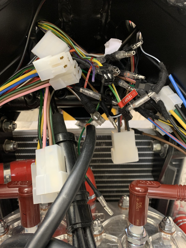

Been doing a bit more wiring the last few evenings. The M Unit has an input side and an out put. Input from the switches are all earth . The unit converts it to positive on the output side. So mainly input on the left loom and output on the right

Post by jessy03 on Mar 11, 2021 21:34:02 GMT 1
Jeez youโre a brave man, nice work

Jeez youโre a brave man, nice work Thanks pal. Itโs beginning to make sense now....... hopefully ๐ฌ๐ฌ
Post by Mr Kipling on Mar 13, 2021 17:01:20 GMT 1
looks like youre doing a terrific job on the wiring, its coming along nicely....
Post by abar121 on Mar 13, 2021 19:06:51 GMT 1
Love the project and clean wiring. It's going to be quite something when finished

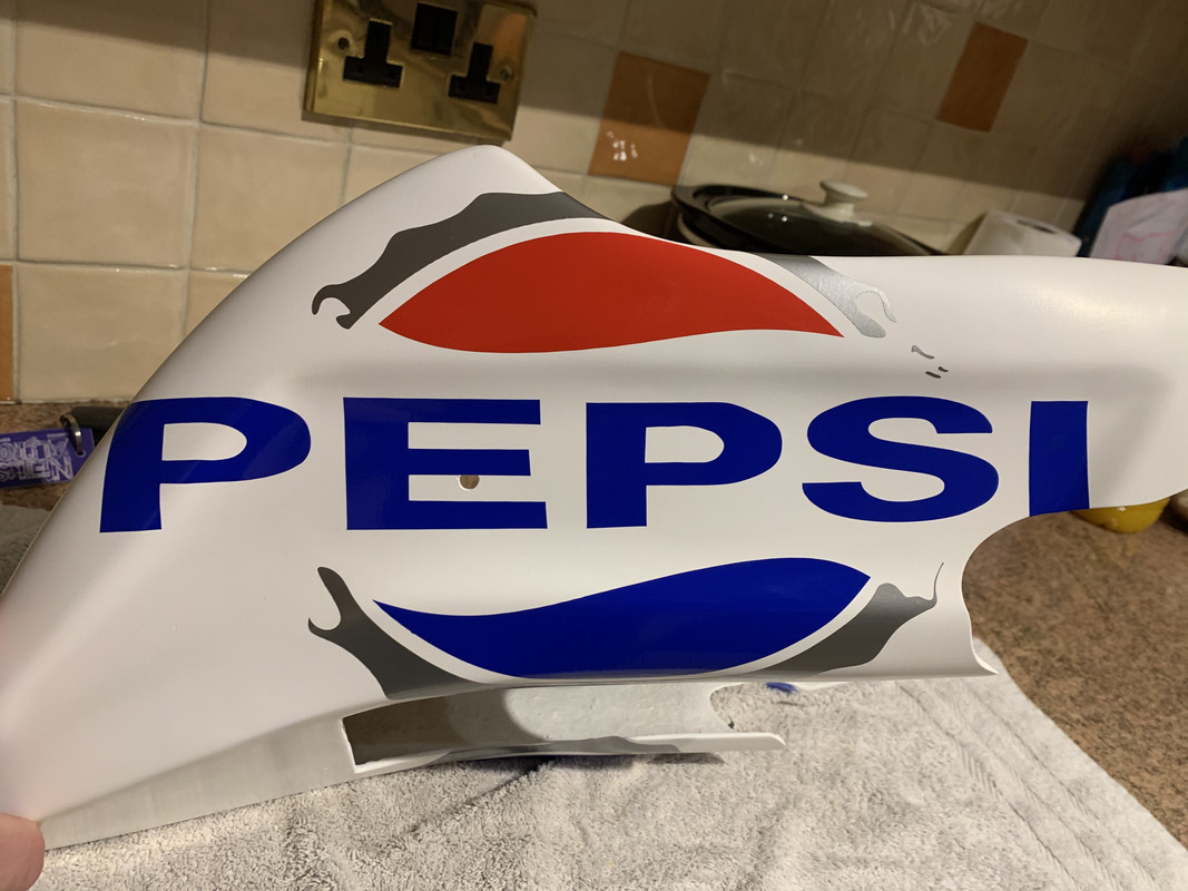

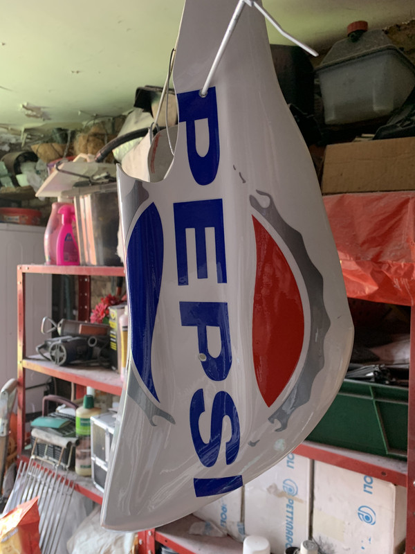

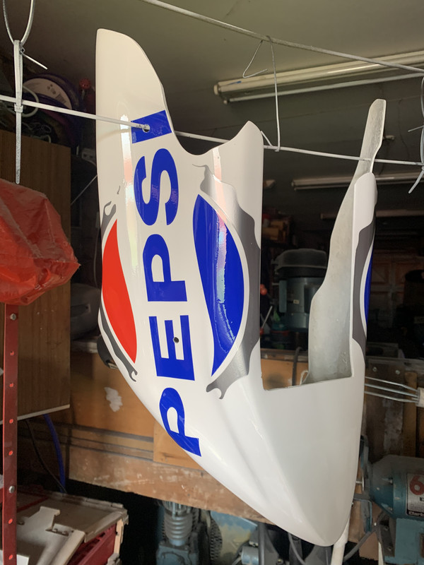

Primed, base coat and decals done Few coats of lacquer

Post by avb on Mar 28, 2021 14:45:39 GMT 1
nice work tony paint that ceiling while your at it

Post by botty on Mar 28, 2021 14:57:01 GMT 1
nice work tony paint that ceiling while your at it Thanks Andy. The ceiling will be coming down soon. Will be part of her new kitchen ๐ณ
Post by abar121 on Mar 28, 2021 15:05:39 GMT 1
Looks great. What lacquer are you using?

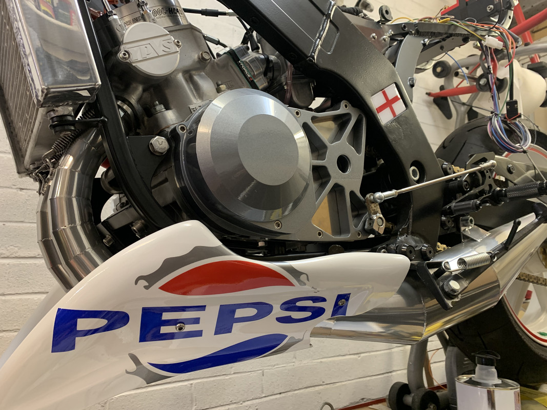

Itโs beginning to take shape
Post by dusty350 on Mar 29, 2021 19:45:23 GMT 1
Love this build Dusty
Post by donkeychomp on Mar 29, 2021 21:38:44 GMT 1
That paintwork is unreal. Can't wait to see more of this.

You got an eye for them pal. I hear what you are saying re.. belly pan and some say nose cone. I like them both and my decision is law๐๐ Yeah itโs Lumpy. Shame you have to sell your bike... one of the best out there tbh. And the cars going too ๐ข๐ข๐ข. Iโm doing good. Hope your hospital results are ok. Nothing too serious I hope. Might see you this year if I get up to Squires ๐ Your bike, your rules.... build what you want! its looking good, and your wiring efforts are amazing, I've often thought I'd like to build a new loom, not got the patience though. Phil My sentiments too pal. However constructive criticism always welcome. The loom was relatively easy. Literally one loom going to the input side of the M Unit and another to the outputs. The hardest thing by the look of it is programming the damn thing.๐๐

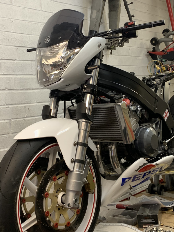

This is how itโs going to look. Needs painting and decals. You get the idea though
Post by Tobyjugs on Nov 4, 2022 18:52:41 GMT 1
That looks very nice and very special
Post by dusty350 on Nov 4, 2022 18:55:35 GMT 1
Looks awesome Botty I really like this build Dusty
