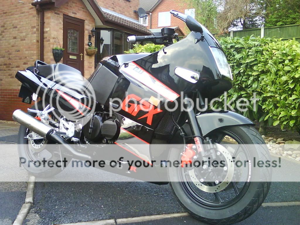

and OK, its not an RD350, its my last project..gpx 600 ninja...just to show folks out there that i finnish my projects .LOL. i know so many that never do

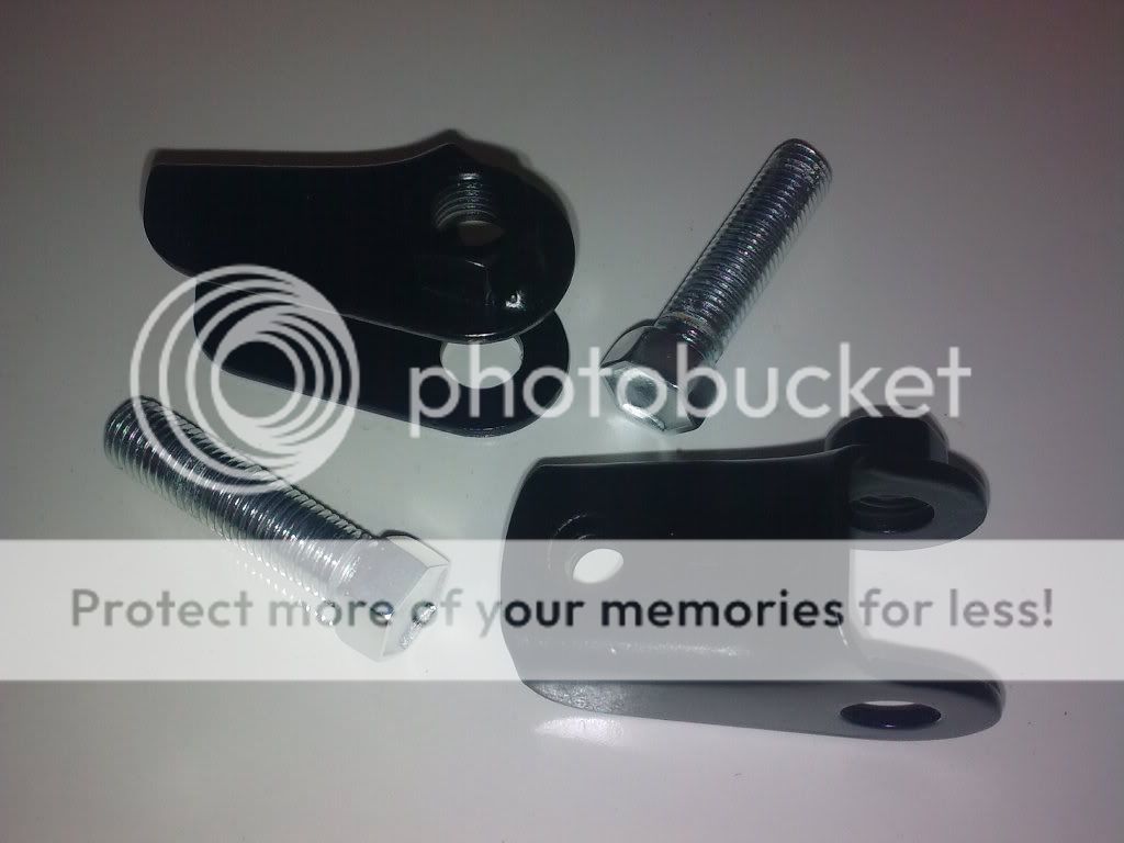

had a few bits cleaned and plated..just to keep me ticking over . to those who asked how long will this one take, ill probably go for a couple of years, no rush .just steady and enjoyable. engine mounts and bolts nice and shiney and repainted (blasted, epoxy primer and black satin paint top coat

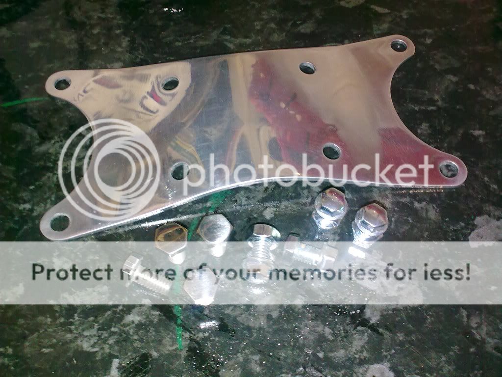

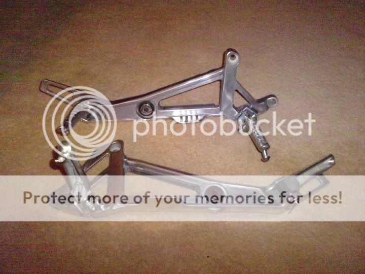

engine carbs and lots stripped out. polished, new rubbers cast in 2 part polyeurothane rubber, i worked at an aircraft restoration company up untill a month ago, so had access to lots of equipment, and i made and machined my own fittings washers etc for these footpeg brackets, all steelwork has been plated all ally polished...looks better than on the pics
