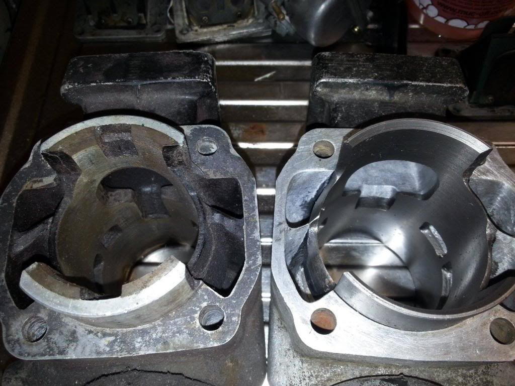

This is for anyone interested in the 370cc conversion (relined 250cc barrels): Barrels just back from Ron at Fahron Engineering: Direct comparison of a std 250 barrel to a relined/re-sleeved and reported Fahron Engineering 370cc 66mm bore barrel ................ WOWZERS   Exhaust Ports compared:-  Inlets comparison from the bottom:-  From the bottom - woweee   More inlet and transfer shots  Exhausts and transfers  More lower barrel shots  more inlets - everyone loves photo's eh?  370cc transfer side'ies  250cc side'ies  370 inlets  250 inlets  Camera battery went flat before I could snap the reprofiled head so I will edit this thread over the weekend to include the shots of Ron's work on the head. EDIT:- Here they are (Pics of the reprofiled head)  Bit blurred - maybe coz I had too many ciders last night - heh heh! End of EditHe's gonna probably curse me know - as a deluge of you rush to convert loads of old knackered/scrap 250 cylinders - hahahahahahah  Nice for sleepers if you keep the 247cc on the outside of the barrels mine will be engraved with the new cc and Fahron somewhere - as my bro' in law is a jeweller  Fab work for £400-450'ish (including new proper Mitaka 66mm piston kits and reprofiled 250cc head work) - I can't be exact as I had some other work done on The transfer ports came back very sharp (which Ron says is fine) but I think I will chamfer them back 0.5/1mm at 30 degrees, as recommended by some top US two stroke experts (saves ring snag when super hot as they try and expand into the ports) especially when breaking in the engine - but I welcome peop's thoughts on this. I have some tuned reedblocks with dual-stage Boyesen reeds to go on this, and maybe the big fack-orf K's you can see floating around in the background. + some 6mm carb/reed spacers as well. Oil pump is off to be refurbished and uprated for low revs delivery by Arrow from here shortly - then it's time to put it on the freshly rebuilt motor and run a few heat cycles - whoop, whoop!

Great pics - just shows how poorly finished the factory castings were, guess thats mass production in action at a price. Should be a strong motor in the end.

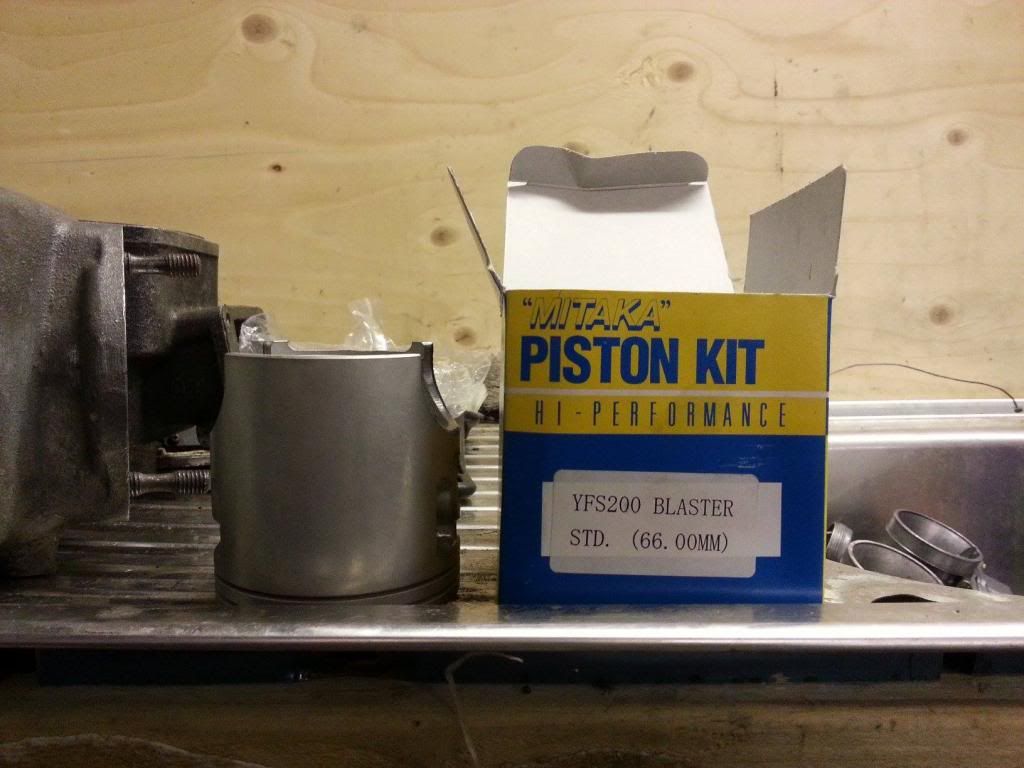

any pics of the pistons really nice job on the barrels

2mm worth of re-bore potential. Mitaka Yam blaster pistons.

A LOT of expensive man hours turning 250barrels into Ersatz 350's. Why? That's an Odd approach considering the downsides of a re sleeve. Regardless, DO rethink fitting Trap door Boysens. IMO you might as well only fit a plug to one cylinder.
Post by andygasgas on Jun 21, 2014 10:39:15 GMT 1
Bare do u ever say anything other than criticise what others are doing ? Just thinking out loud lol when u consider the price of a set of 30 odd year old 350 barrels if u can find some then possibly a rebore etc it's not that much more and as 250 barrels cost a 1/3 the price it's even better

any pics of the pistons really nice job on the barrels They are std 66mm Mitaka Yamaha 200 Blaster pistons - but slightly modded on the tangs see below:-

A LOT of expensive man hours turning 250barrels into Ersatz 350's. Why? That's an Odd approach considering the downsides of a re sleeve. Regardless, DO rethink fitting Trap door Boysens. IMO you might as well only fit a plug to one cylinder. Its a better proposition than forking out £300+ for a set of std 350 barrels (I was looking for quite a while). Plus the wider bore and optimised port work and revised timing give better torque characteristics than a tuned 350 (read : Accelleration  ) and after doing a fair amount of research last year, I realised this was probably the best proposition for what I had in mind (a 4l1/0 "special"). I have some spare YPVS units, one with a +4mm stroker motor that is mildly tuned, which will probably go into the second 4l1 frame I have (or the Mito or the 3MA .....//  and running gear will be a Gixxer6 SRAD RWU forks/triples with CBR400RR NC29 swingarm and wheels etc) But this one is being built to reflect a special that would have been built circa 1980-82 so YPVS engine was not even considered an option. & value / money never really came into it, although its a fab job for the actual cost It's really just been done "because it can be" and will set it apart from other specials (not "better", just "different") ..... I like different ....... I'm a bit "different" - ROTFL Dual Stage Boyesen have a mixed feedback - I'll suck 'em (or rather they will) and see - I have others (fibreglass etc) so it's all about the tinker and tweak, till the best combination is worked out - ditto the reed spacers 6mm/8mm/10mm etc. And of course I have the 34mm PJ's - which'll sound awesome but probably make it totally unrideable - #smirk Right .................. off to the Pub for my little bro's 40th B'day bash - should get pretty messy so won't be responding until mid afternoon tomoz.  Ciao Bella's JB

see where you have taken the tangs off the pistons file marks still evident.get some wet and dry and smooth the file marks out.could start stress cracks in em

see where you have taken the tangs off the pistons file marks still evident.get some wet and dry and smooth the file marks out.could start stress cracks in em  Cheers Mars - the barrels trf ports have to be chamfered as well, so I'll do these at the same time. Another point to note is that these pistons need to run 350 top end bearings NOT 250's Has anyone got any feedback on running the silver plated one's (Norbo has some I think) vs small end standard bearings? Cheers, JB
