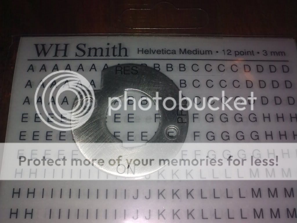

im my quest to try and do most of the stuff myself, i tried the old school letraset rub on letters, should be good with a coat of laquer, this has resurected the old worn fuel tap plate .......its another litle win !

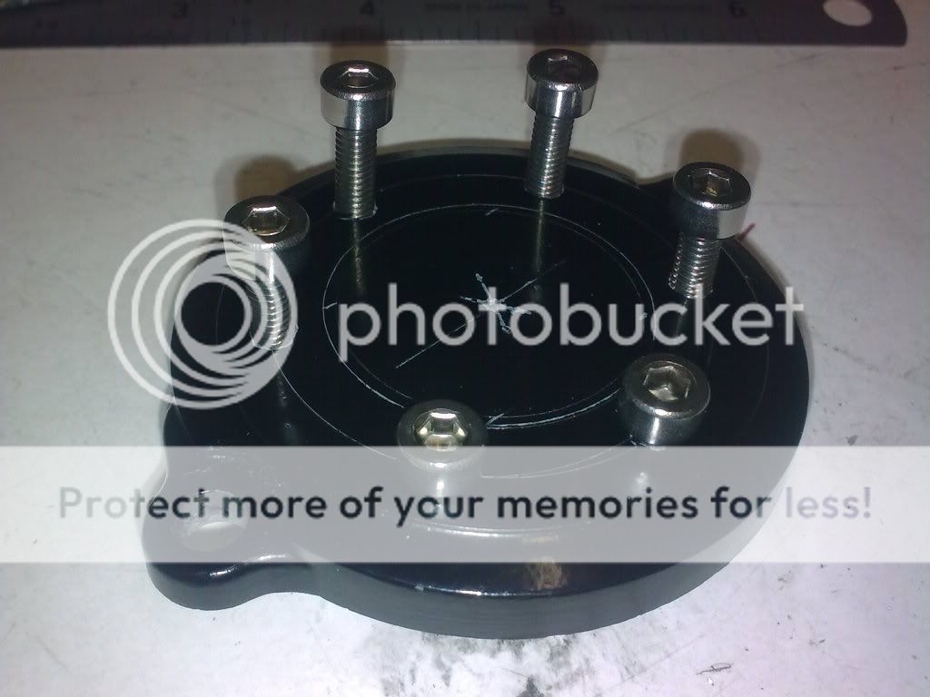

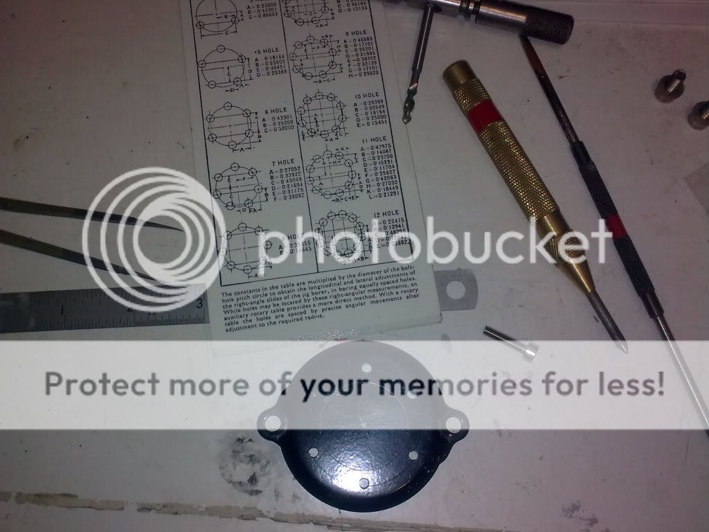

i saw a little bit of inspiration at the last uttoxeter bike show, and had to "Borrow" the idea, so im adding a little "inspection window to the powervalve cover.

Post by kennyroberts on Aug 3, 2011 20:29:24 GMT 1
job done !

Post by wilko on Aug 4, 2011 19:00:20 GMT 1
thats a bloody good idea what did you use for the window, your project is starting to look really good, oh and nice zeus book
Post by kennyroberts on Aug 4, 2011 21:56:15 GMT 1
hey wilko, thanks,cant take credit, i knicked the idea from Robs 350 ypvs in the previous pics, ill get around to doing the clutch cover one day, but as this PV cover is not sealed, thought this would be easy, i used std 3mm perspex, and hey. we all need a good zeus book !, used to use it a lot at my last aircraft engineering job, find it handy at home now for ods and sods !

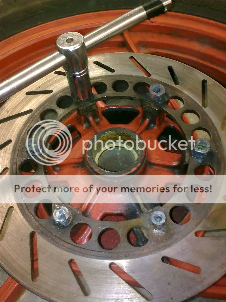

had a B@$t#*d job getting the rear brake disc off the rear wheel, this has had penetrating fluids off and on for over a year, and i have tried impact drivers, oxy acetyline heat etc etc,......nothing......so had to resort to TIG welding some nuts to the disc bolts, and using a T bar,this has just about shifted the.........HURRRAY!.......now onto the exhausts
Post by JonW on Aug 28, 2011 9:06:45 GMT 1
WOW! Mine came off pretty easily compared to yours and also compared to many other bikes ive done... well done for finally getting em off!
Post by kennyroberts on Aug 28, 2011 22:37:47 GMT 1

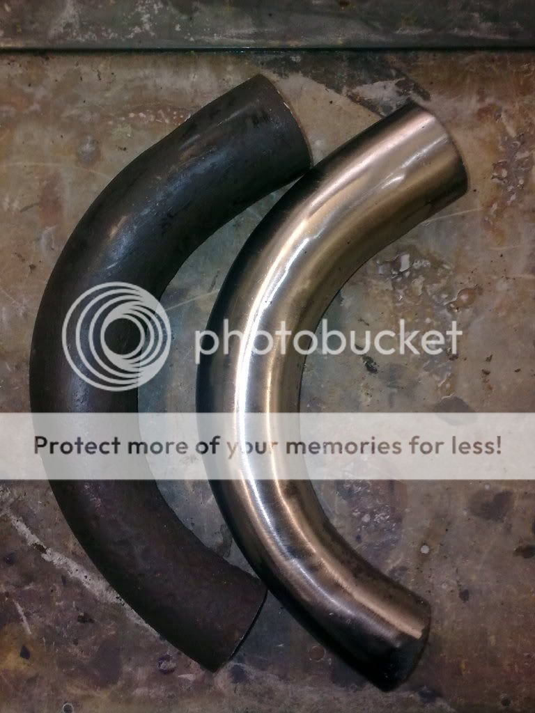

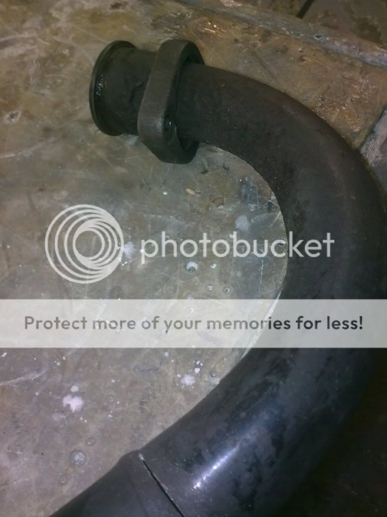

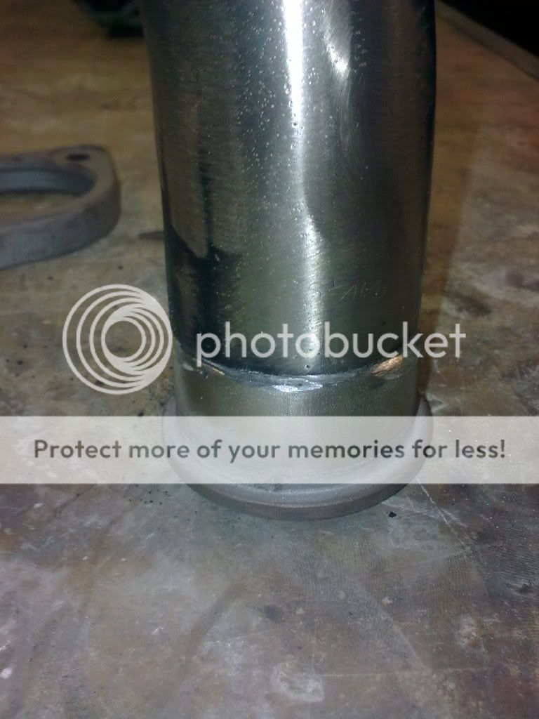

got to do some work on the exhausts, have decided against making my own full system from scratch, as the f2 exhausts are looking pretty good, some rot on the down pipes, so i have cut these off and will graft in some new bent pipes, then i have sawn off the cans, this will enable me to weld on some flanges to bolt on some nice cans, (old ones were a bit knocked about
Post by mellow on Aug 29, 2011 19:51:21 GMT 1
nice job m8 The disc bolts are a b*****d coz they probably used loctite to fit them and the steel bolt and alloy reacts but i bet u knew that
Post by kennyroberts on Aug 29, 2011 20:12:58 GMT 1
Thanks, ...i actually thought i would never get them off!! still got a few of the front disc bolts to sort yet (about 5) ......gotta get the TIG welder warmed up again next weekend !, then i can sort out the wheels ready for powder coating
Post by kennyroberts on Aug 31, 2011 21:32:57 GMT 1
had some pipes bent up to replace the pitted downpipes, just need to get into a workshop and get some heat on them for a few final tweeks to make them fit

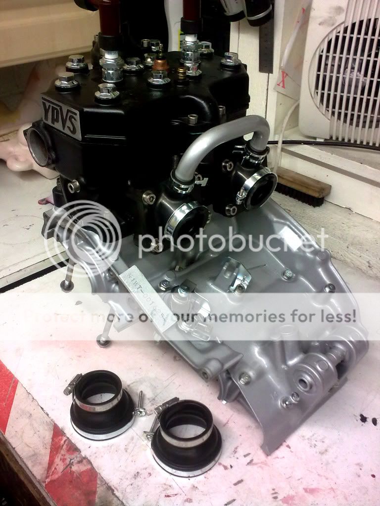

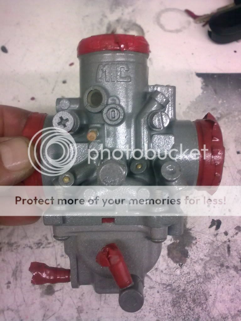

Post by kennyroberts on Oct 1, 2011 23:07:57 GMT 1
had a few hours free to do some work on the carbs, i was going to aqua blas them, but didnt have the inclination to sen d them away and wait, so i glass bead blasted them myself, aftyer some vary careful masking and sealing, (there is nothing inside the cases, they were stripped of all parts internally) before masked ready ! fuel resistant laquer (handy, cuz apparently there is fuel in these things !) and in place with a few blingy bits fitted im quite happy with the results, and it saved a few quid on the aqua blasting,
Post by mellow on Oct 1, 2011 23:11:14 GMT 1
nice job as ever m8 Yet another engine that it will be a shame to put oil and coolant in ;D
Post by kennyroberts on Oct 1, 2011 23:20:59 GMT 1
cheers mellow, i have to try hard cuz some of the work on this forum puts my work to shame, i have a lot to aspire to! but as ever, im enjoying it all ,and the advice and feedback from others is an inspiration to me all i need for the engine is the castle seals for the PV, then it should be ready for a proper build up and all the fluids.
