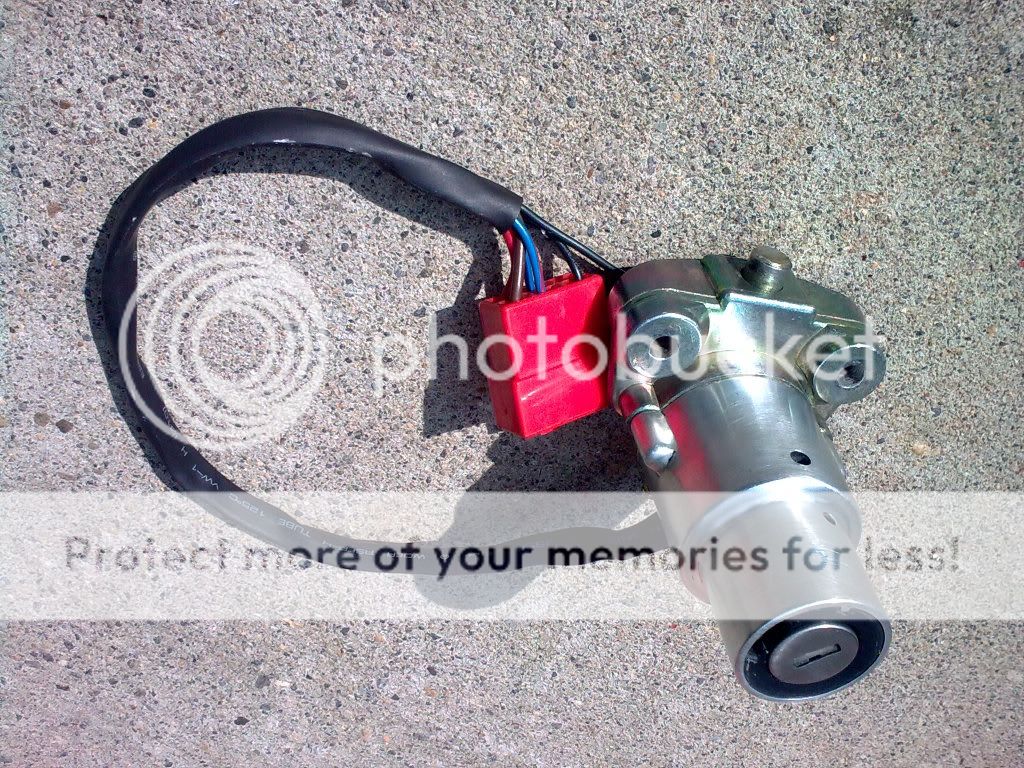

ignition arrived in the post this morning, a little bit tatty on the cables but i recon a day on it on sunday will see it right, i dont mind putting the hours in rather than buying a new pattern one for an extra £15, its all in the pride of doing the job yourself, iull be sure to post some before and after pics on sunday night
Post by kennyroberts on Apr 17, 2011 22:16:52 GMT 1

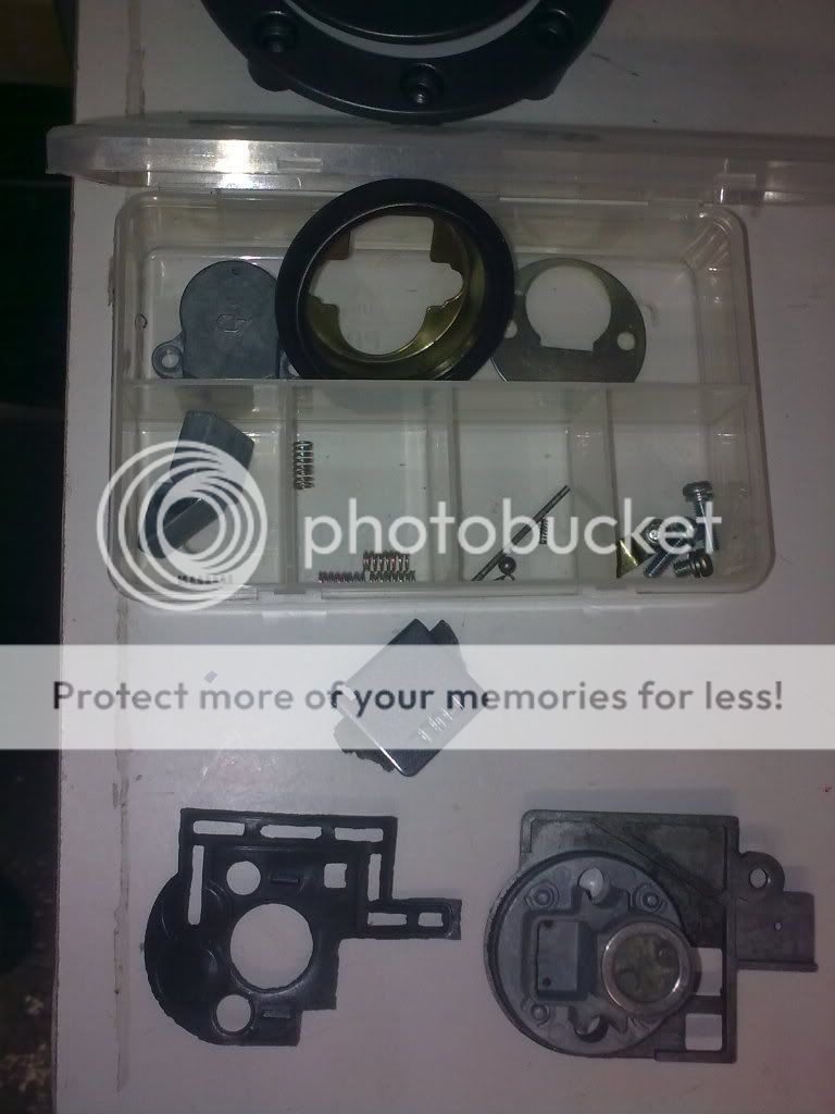

a little bit tatty ,but i think it will scub up well, strip the thing apart, clean up the seperate components, including the wiring and end fitting, a bit of a polish up and >>>>>>>>>>> just need a new decal off this fine website shop to trim it off and its as good as new !

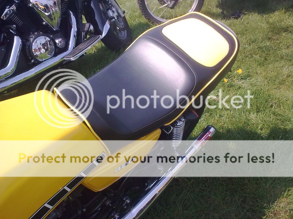

a few more bits of bling........£20 for more than twice what is shown here ! before..... after.... i quite fancy the look of a seat like this to go with my Kenny roberts rep colours, marked out for rough pattern, im thinking of smooth vinyl outer, textured vinyl patches with yellow beading all round. or this is quite cool and simple,

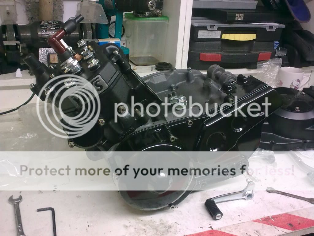

Post by kennyroberts on May 6, 2011 22:10:03 GMT 1

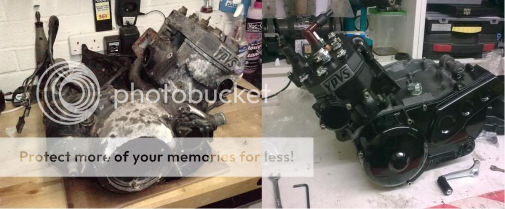

got a bit bored, thought i'd do a dry build on the engine tonight to see how stuff looked, and im quite pleased so far, it will look ok with a few more blingy bolts and fittings as well,

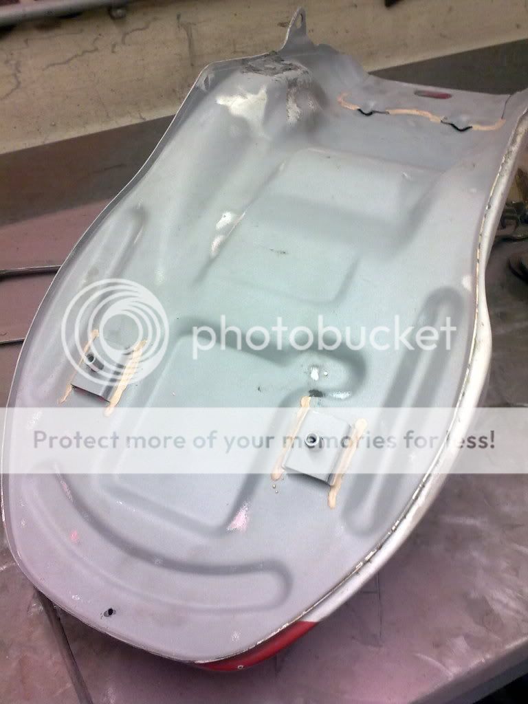

an afternoon off work, so............. a bit of shot blasting, roloc the paint off..... re silver solder any dodgy looking joints and seams with the oxy-acelylene cut hole in tank to drain out the rust eater and gravel (exfoliator) :-) silver solder a patch over the hole another shot blast and roloc and then prime with Zinc primer. and a little tin solder plate on the inner petrol recess.(as a rust prevention) all ready to check over for fine dents and scratches to fill...... and primed ready for action

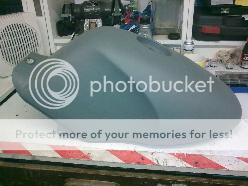

Post by kennyroberts on May 18, 2011 20:45:40 GMT 1
few dents filled and smoothed off and a coat of primer and im ready for the start of the yellow , black and white kenny roberts colour scheme
Post by mellow on May 19, 2011 17:00:16 GMT 1
NICE!!!! Thats the shiniest primer i've ever seen m8 ;D
Post by kennyroberts on May 20, 2011 20:46:51 GMT 1
it was still wet :-) i just have to seal it on the inside now to cover all the crud that the rust remover didnt shift.

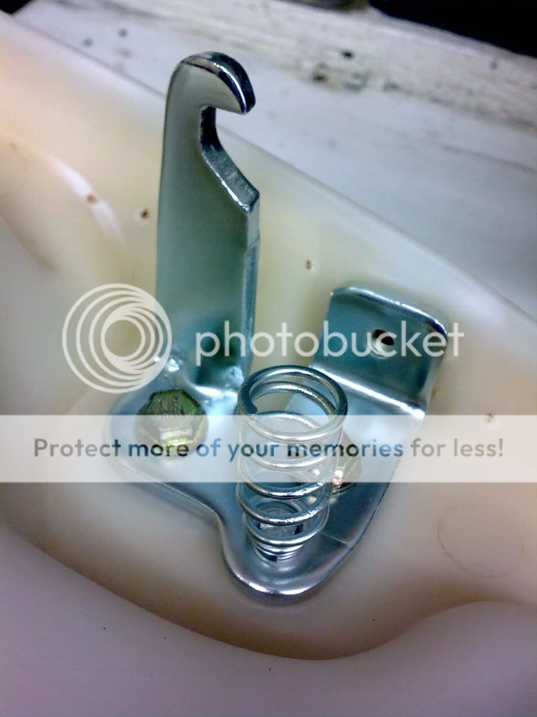

before, (crap photo, but to be honest the switchgear was crap also) and after ! right onto the other side !

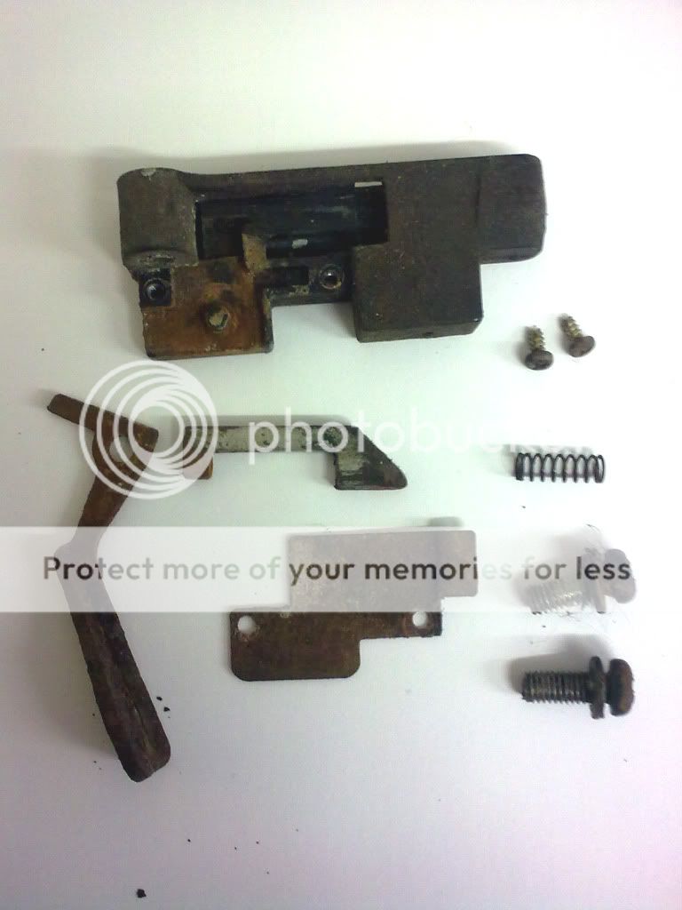

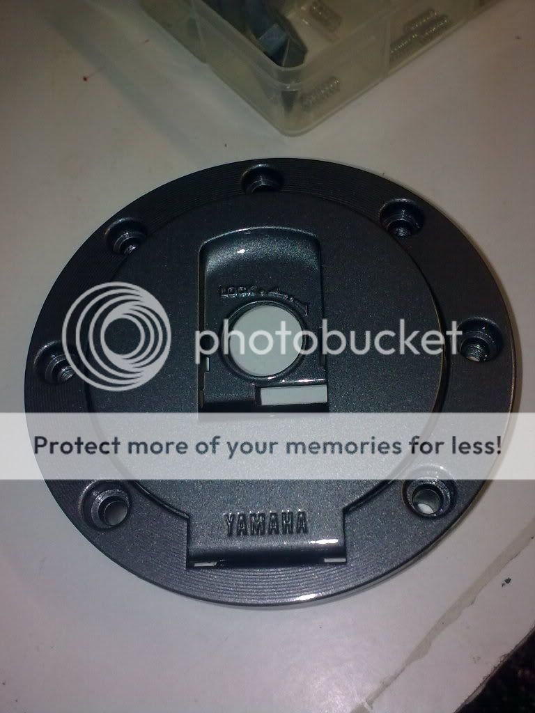

Post by kennyroberts on Jul 6, 2011 23:46:31 GMT 1

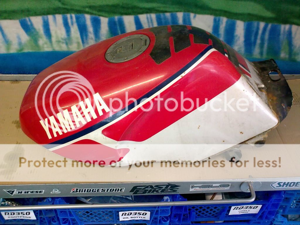

Uttoxeter classic bike show last weekend, great weather,ad some nice bikes, a couple of nice finds in the autojumble, F2 tank cap with key £10, looks nice after a clean up and refurb, the pic below shows the repaint, just need to apply the petrol resistant laquer later, Before: and also found a front master cylinder that looked like it got thrown down the road, with an excellent rubber diaphram and recent piston seal kit in it for £2, that saved a few quid this and a few stainless nuts and bolts and a 30th anniversary 350 lc t shirt, job done ! also saw this piece of art !
