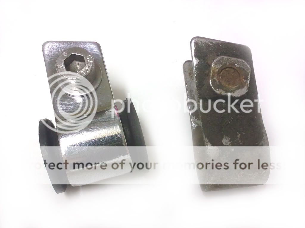

Post by kennyroberts on Oct 1, 2010 21:23:42 GMT 1
just had an hour on this bit,, its amazing how well the chrome held up under the crapy storage conditions of this bike, just a bit of rubbing down and a polish with some ally cleaner and it came up great, the addition of a new stainless allen bolt and its job done, just the second one to do p.s , thanks scruff, i have found it now, ill get a few quid in the post and send off for some stickers, i need to get the switchgear back together , thank god for the several dozen pics on how they came apart, !! if anyone needs any pics taken of stuff in bits or whatever, drop me a line, im building up quite a library !

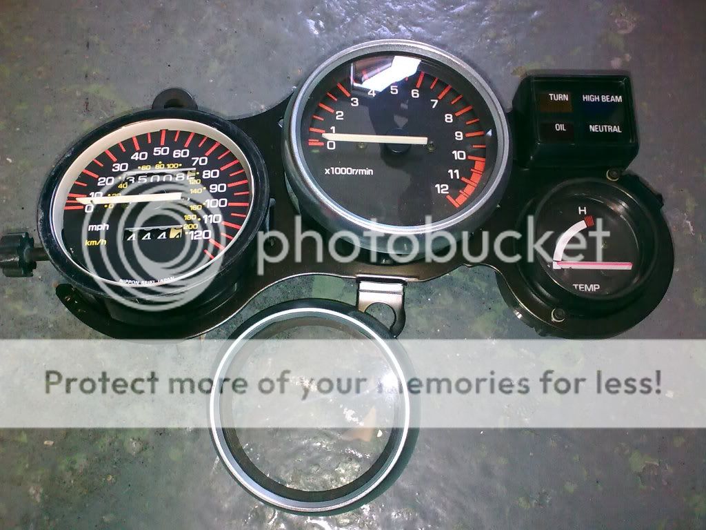

Post by JonW on Oct 6, 2010 2:21:44 GMT 1
Great work! Can I ask how you got the tops off these clocks? I thought they were fixed and Id love to get in a clean mine up..
Post by kennyroberts on Oct 6, 2010 20:41:25 GMT 1
very long winded, they are supposed to be factory sealed, but where there is a will there is a way, :-) (and i was a good boy and never touched the milage) take a sturdy fine screwdriver, and the metal lip that is folded back at the rear of the casing, just carefully prize it up and work around the edge a bit at a time, two or three laps to get it higher and higher, and the plastic case will pull out,i have pics on my mobile, ill sort them out, the speedo is a pain, as i couldnt find a way of taking the trip dial out of the side, so i couldnt take the gubbins out of the case to clean it properly,but the rev counter is easy. putting it back is a bit easier, just work around re tapping it flat ,but just a bit at a time, again, 2 or 3 laps, dont rush it, the other clocks are a doddle, and wash well in hot soapy water,just be carefull of the fine seal on the temp guage, they get brittle with age ill post pics a bit later !

Post by JonW on Oct 6, 2010 23:35:35 GMT 1
Cool cheers mate! one of mine has a tide mark on the dial where it was left in a box of bits outside by the PO, this may be just the ticket

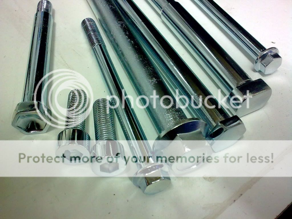

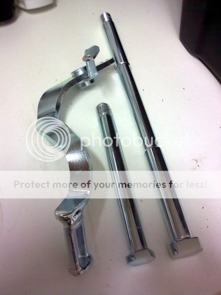

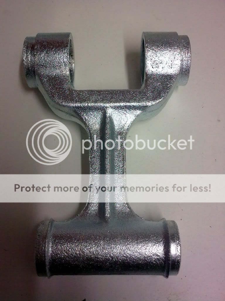

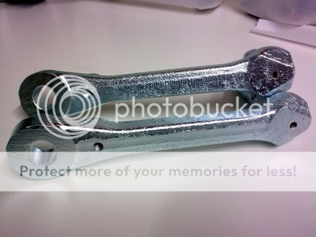

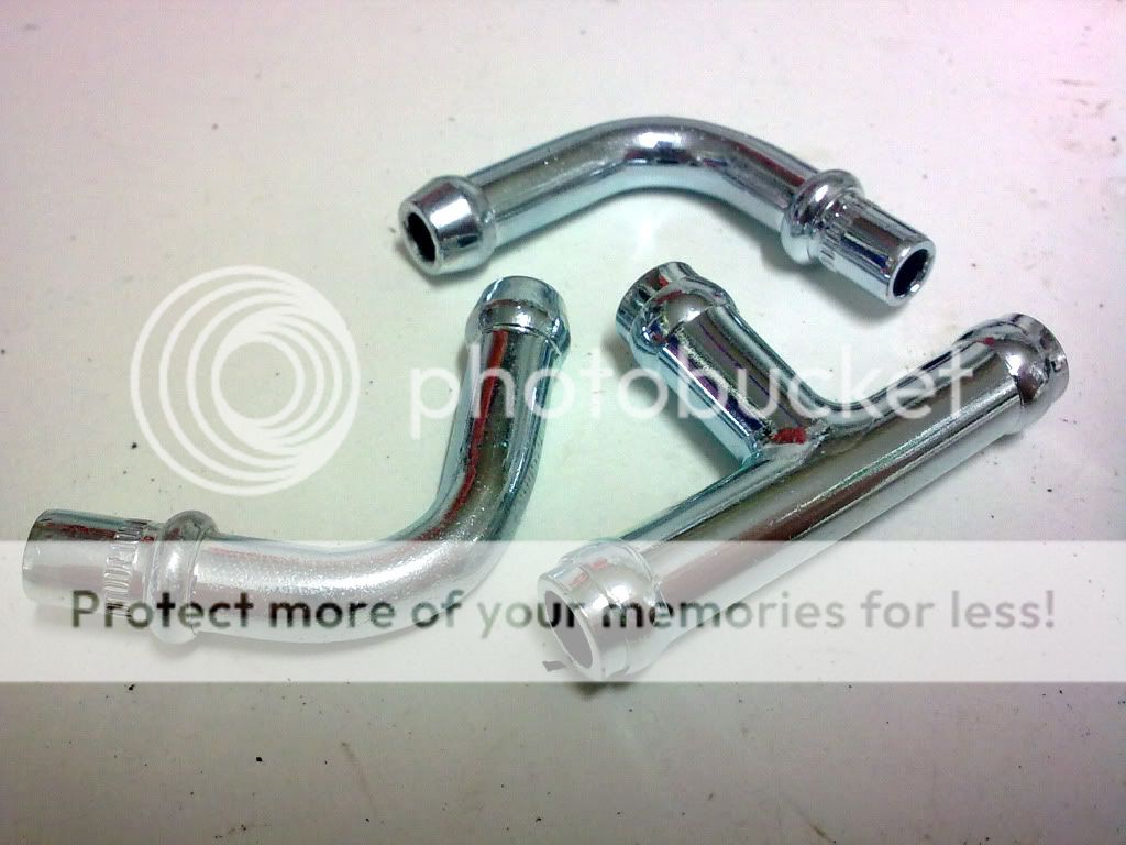

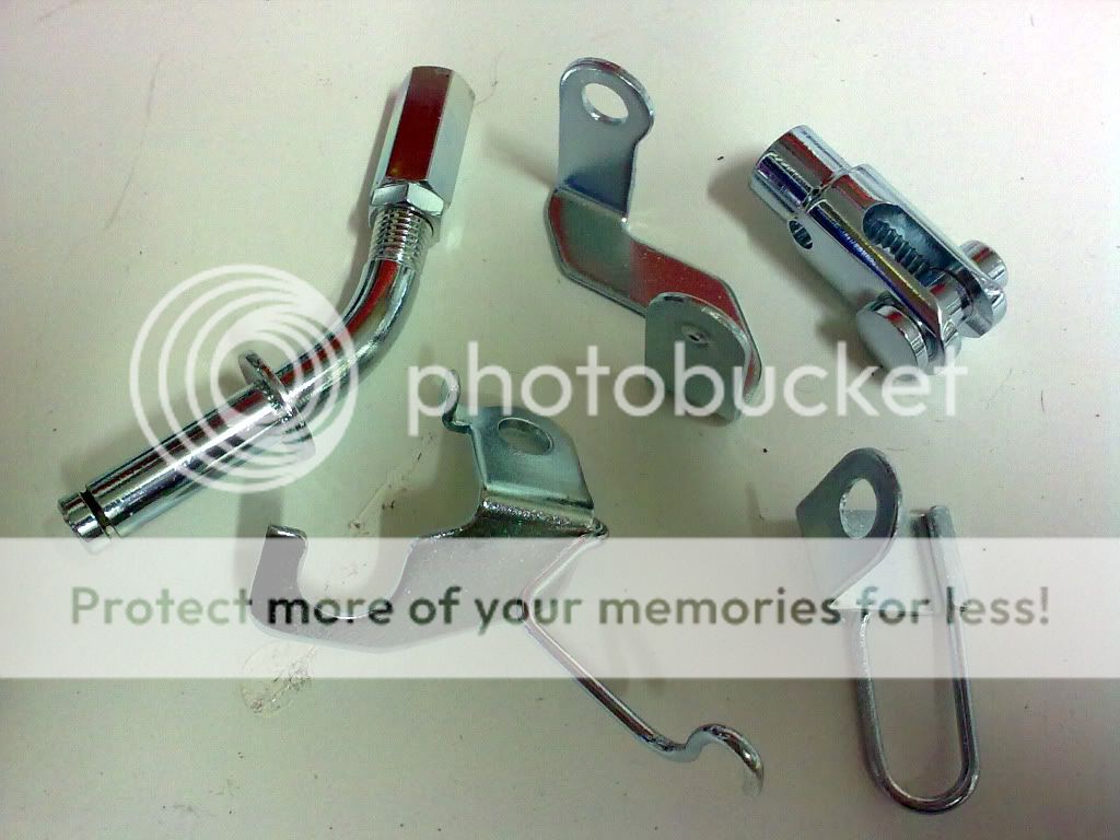

Post by kennyroberts on Oct 14, 2010 0:32:42 GMT 1
just had a shed load of plating back, this should keep me busy for a while, some pieces are plated as a base for painting (the suspension linkages) most will be the final finnish so i have quite a few nuts and bolts as well as linkages, tank brackets joints and screws for the carbs,engine brackets,brake lever, etc etc the finnish i think looks good, and im happy with the colour and brightness of zinc plating
