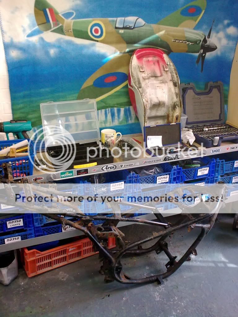

first move was to strip down and asses everything, and to keep things ticking over just go to the classic bike shows etc and buy whatever i saw that i knew i needed ,irrelevent of a plan or order of work in mind.

i have all the frame stripped of everything ready to shotblast and powdercoat, i also have 4 small boxes of shotblasted brackets, nuts and bolts and bits for zinc plating, my local platers can do quite a batch for £10 or £20 for cash ! :-)

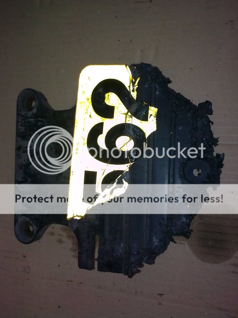

had a few hours in the garage today, stripped 2 carbs down to seperate components ready to clean up, stripped down the fuel tap removed the tank rubbers and sheared a nut in the tank, had to drill out, try to remove with an extractor, but ended up drilling out fully and re tapping .....bugger ! cleaned the frame off and found my number........matching the engine.....woop woop ! Question for anyone out there , does the filter stack pull out of the fuel tap?, or is this bonded...dont wanna knacker it by trying to clean it better. bought a bargain seat a couple of months ago...£8 ......mmmmm, not so much a bargain as i found it in a batch of rd bits in a show and founs out it was a suzuki GS seat....another bugger ! another question, i have a seat plastic base, (no foam etc) can this be made into a seat well, or is it better ans cheaper to buy a seat with foam and get it re covered, i want a nice piped custom seat cover....anyone recomend a good company ? dont know if i should just trim this back to the line....dont think it will be noticeable much ? chewed by wild animals ?

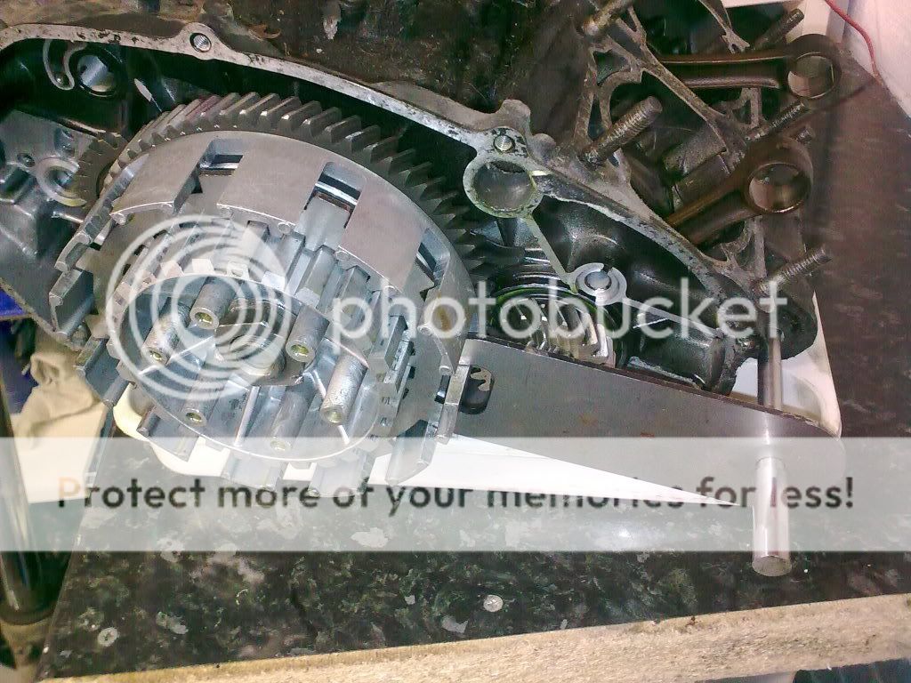

finally underway with the clutch and rotor, soon have these off and that case split in two... and Guiri, many thanks, alot of patience and a bit of sweating and the fuel filter stack slooooooowwwwwwly loosened and pulled free.after about 15 mins of wobbling loose and pulling
Post by kennyroberts on Jun 22, 2010 22:12:55 GMT 1
rotor and stator removed , just need a couple of large sockets for the front cog removal and the clutch basket removal.....sorted !

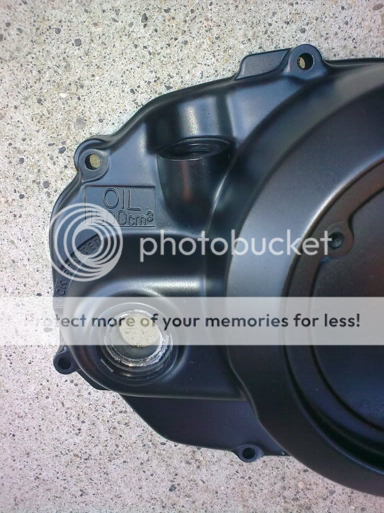

engine now fully stripped down, i can de grease and prep the crank cases for some of that black glossy BBQ paint i hear so much about on this forum :-)

mind that barby paint on engine bits! if you get a sniff of petrol on it it comes off!
Post by kennyroberts on Jun 28, 2010 20:59:03 GMT 1
thanks for the advice, ill keep my eye on that,, i thought it was supposed to be good stuff !?
Post by mellow on Jun 29, 2010 17:49:43 GMT 1
I'VE NOT HAD ANY COME OFF YET
Post by kennyroberts on Jun 29, 2010 21:03:05 GMT 1
thats reassuring, cuz im painting stuff with it like a madman....and i have waited to polish this bit after painting for ages.........NICE !

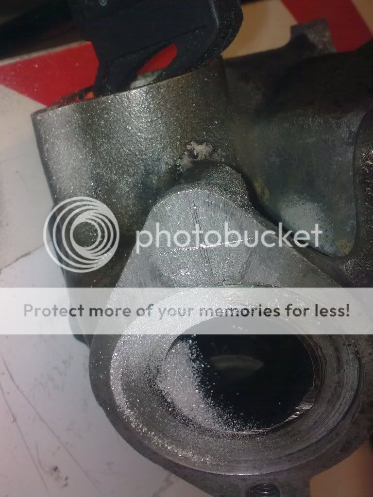

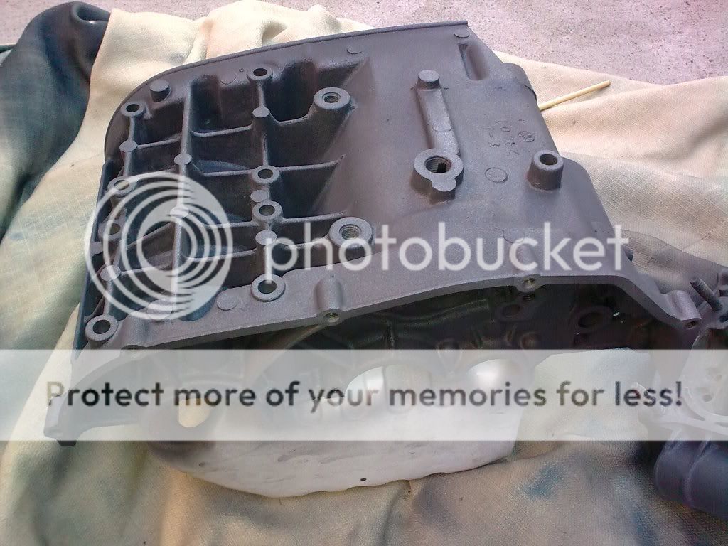

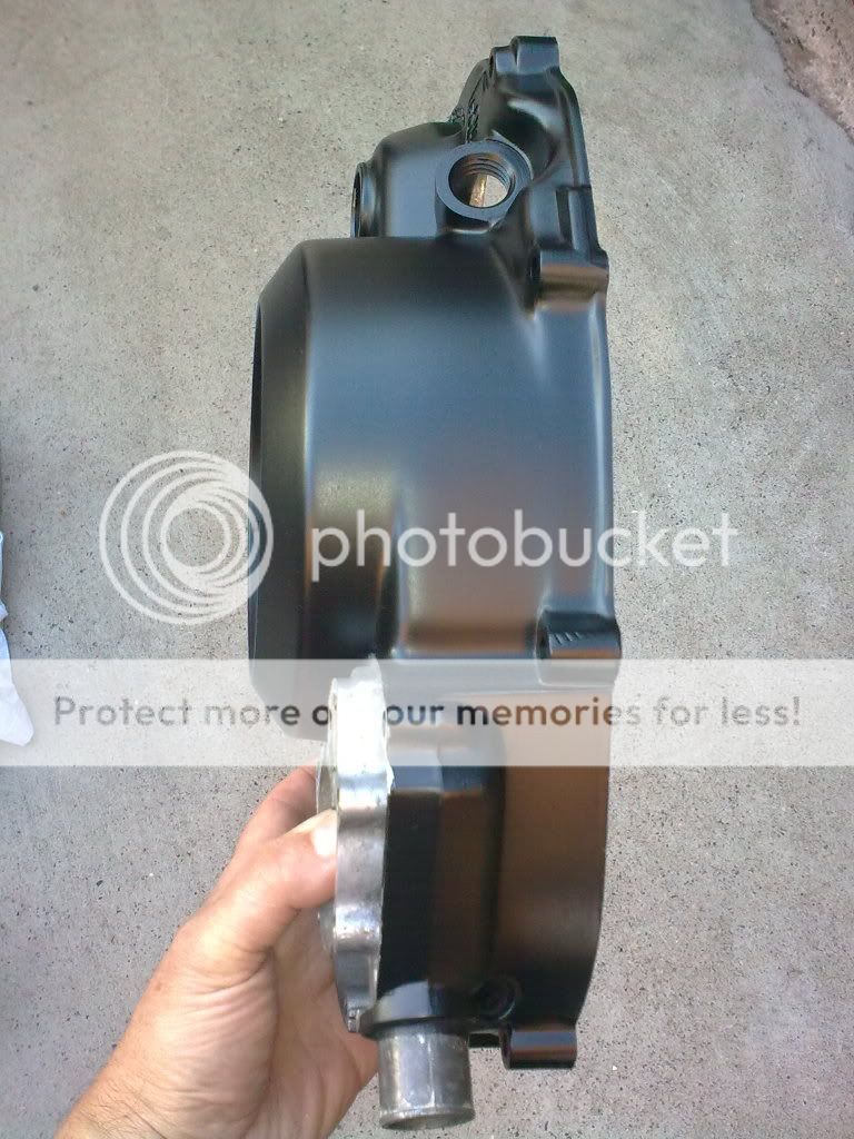

engine casing was a bit rough, just a bit of TLC on the engine casings, it been a while since i have had the time to do anything on the bike, just a few bits and bobs, some electrical progress to post a little later, and the ally welding to the dodgy barrel .

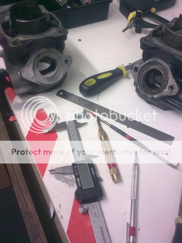

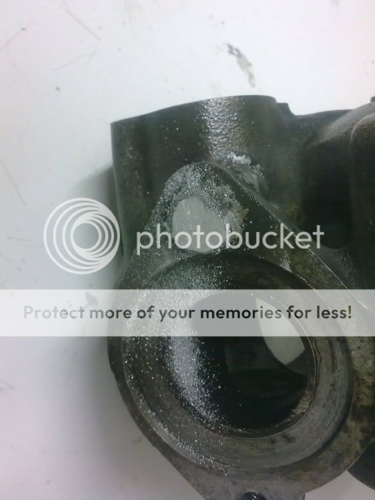

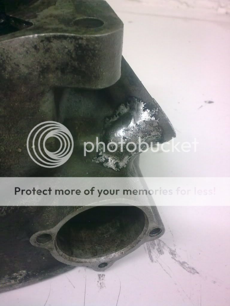

some pratt drilled through the whole barrel to hold the exhaust on with a 8mm nut and bolt. time for a bit of ally welding. drilling and tapping next on the list

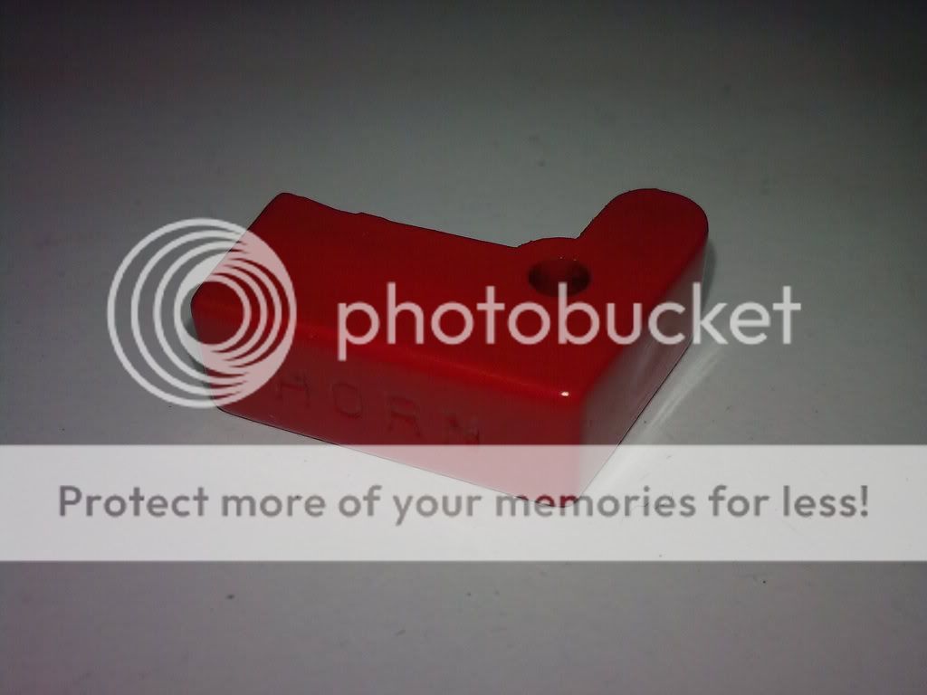

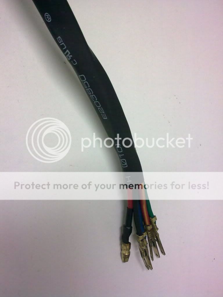

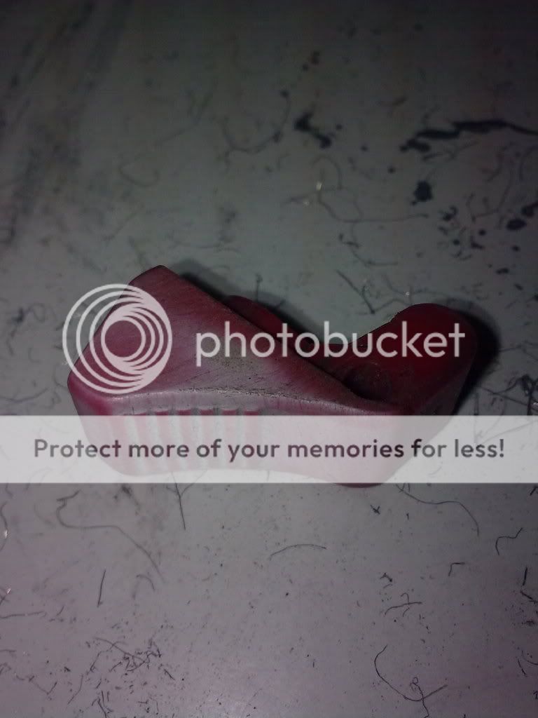

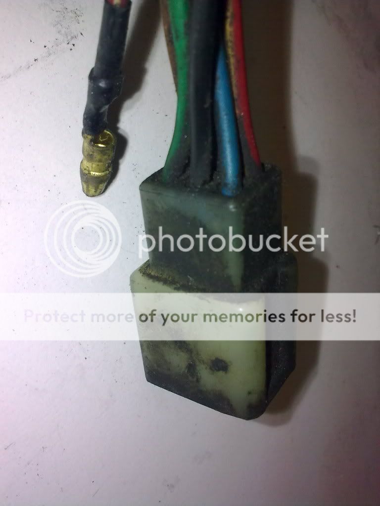

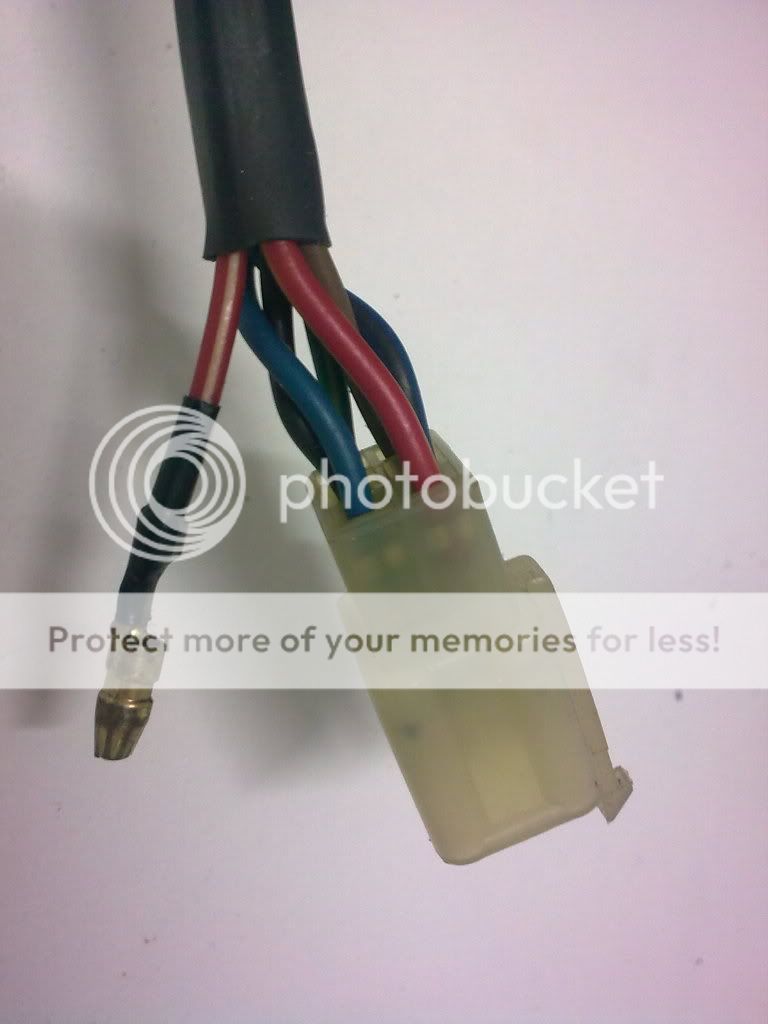

sun faded red plastic......too much even for t cut and plastic polish......bring on the plastic paint ! quite a bit of time stripping down the wiring in the switchgear. pretty sorry state with grease, oil and dirt in the fittings and in the wiring, i have taken both switches apart, stripped down the switches and the wiring , cleaned each wire and the re - heat shrunk the sets of wires......worth the hassle !!! a bit fiddly drawing out all the wires from the 2 blocks, but it hels to remove these so the heat shrink can slide on !
