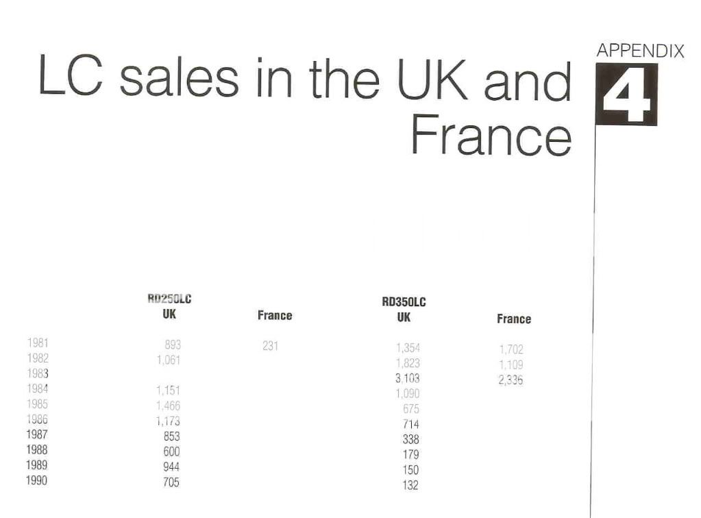

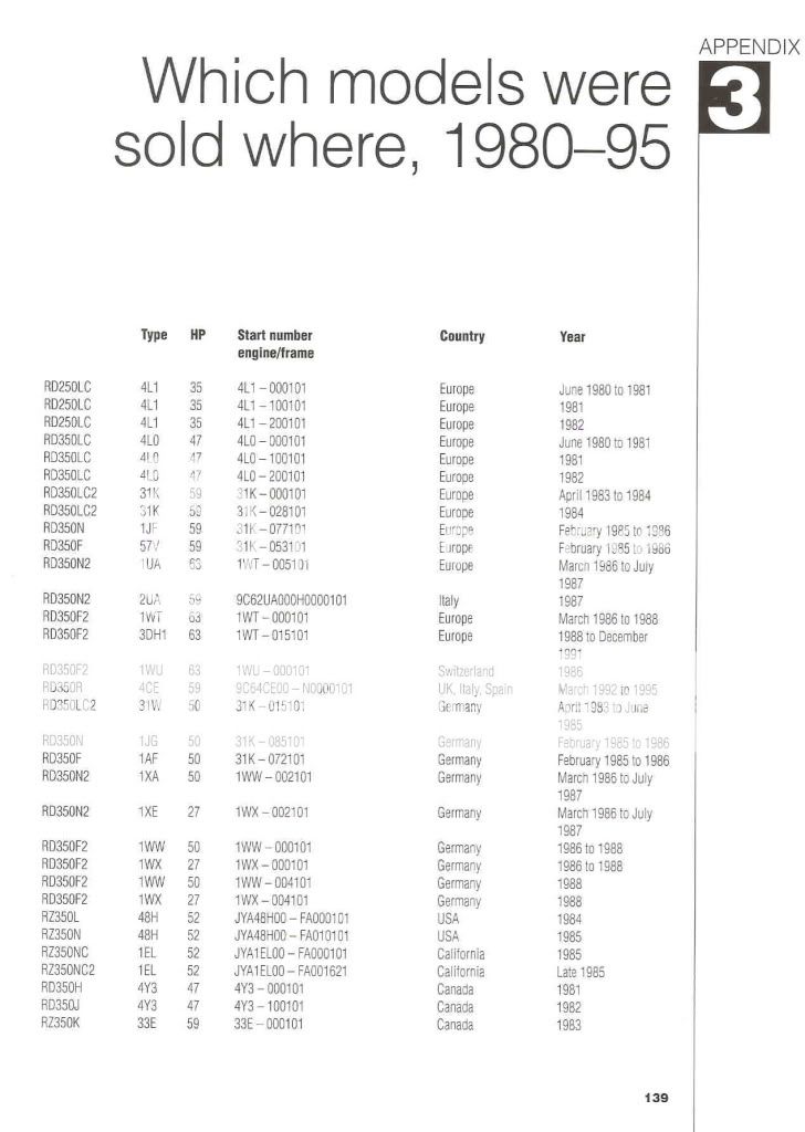

Post by hoist1 on Apr 2, 2021 10:47:46 GMT 1
random info and a good read S Something I read the other day made me think this was worth resurrecting.
