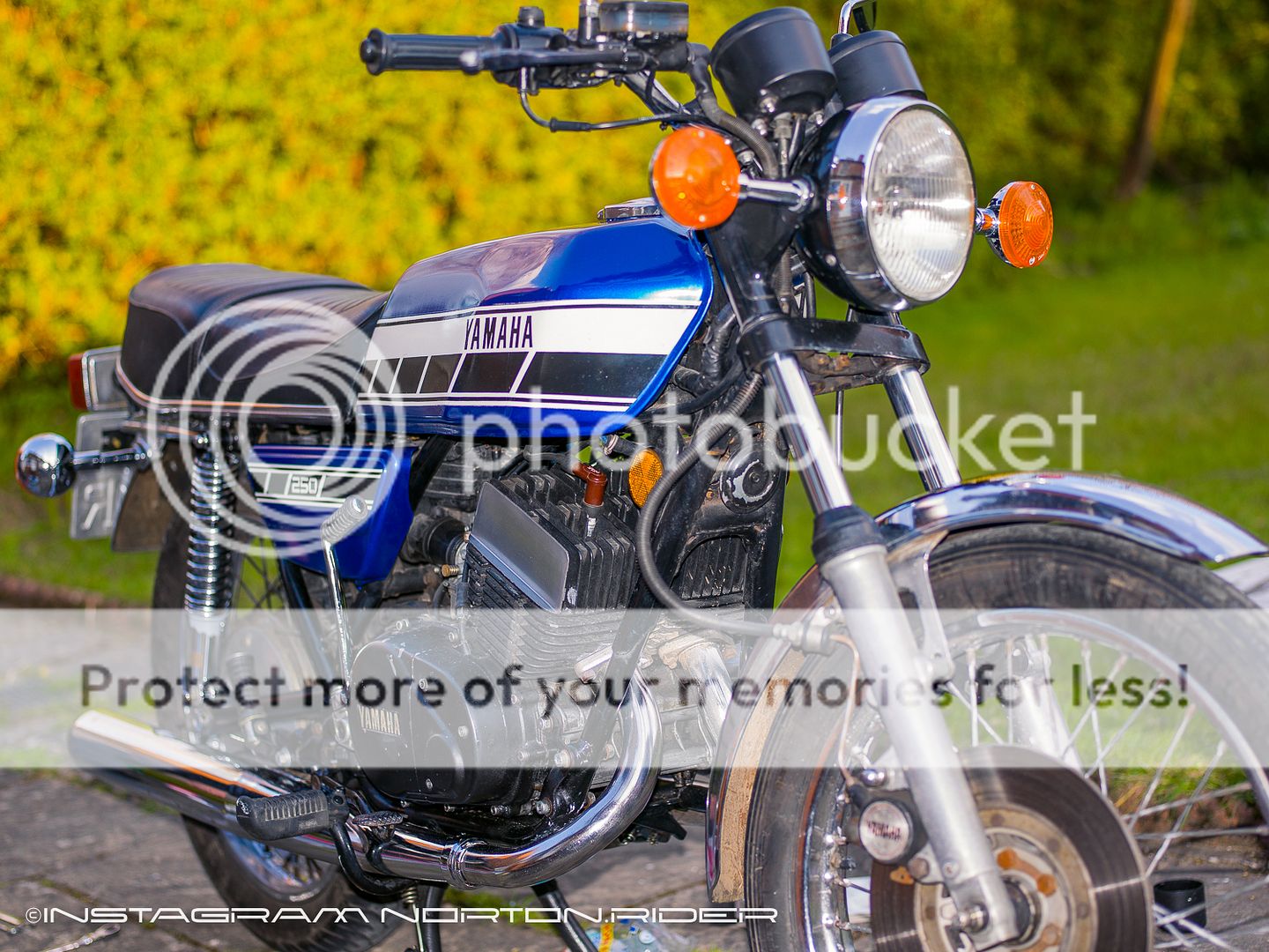

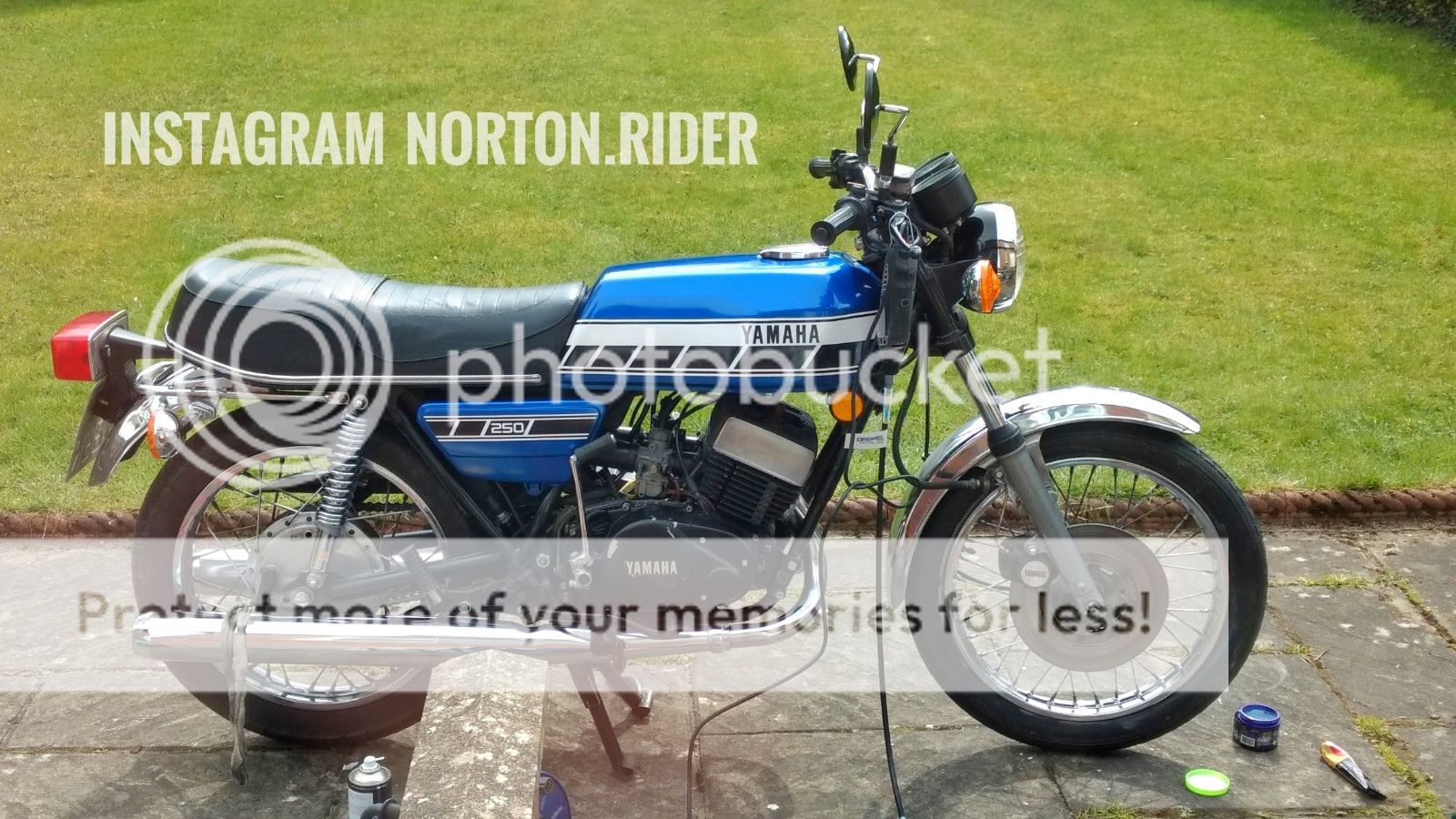

Hi Great write up and great progress so far The old aircooleds are great bikes, full of character and simple to work on too. Looks like you've found a good one to start with. Enjoy riding and fettling Dusty

Cracking looking bike and a fantastic basis for a really nice resto.
Best of luck and most importantly, enjoy.

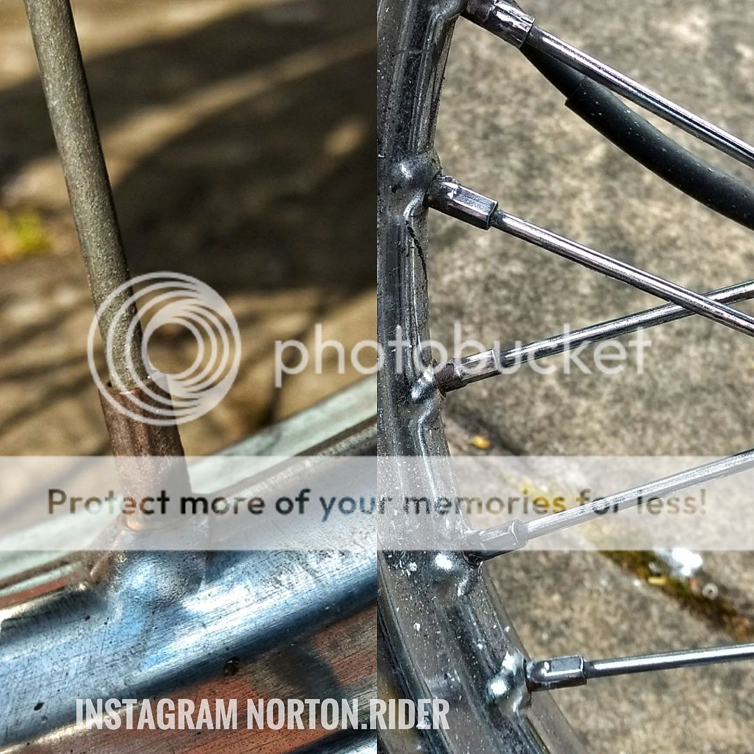

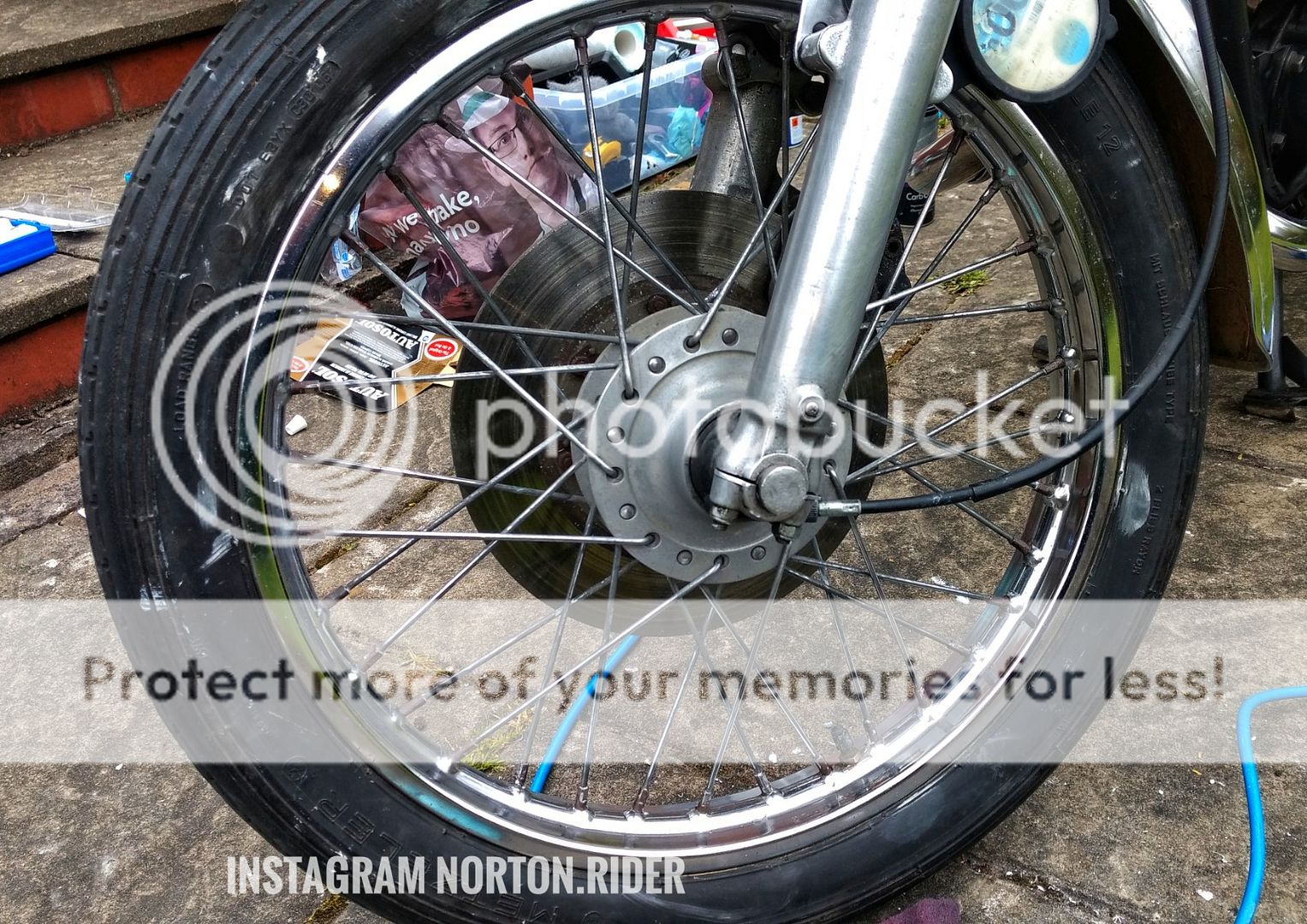

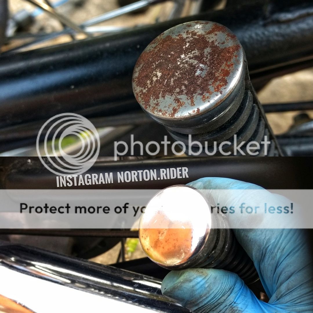

Totally agree Dusty an Brit it's in quite original condition just needs a tonage of cleaning an I need to do something tank wise as it's had a really bad repair working on sorting that out though.
Haha todays plan is endless cleaning on the wheels again LOL.
Dunlop got back to me today and K82's (TT100 replicas) come in the correct 3.00 and 3.50 fitments for the super narrow 160 front rim an normal ish rear rim so might grab a set of those.

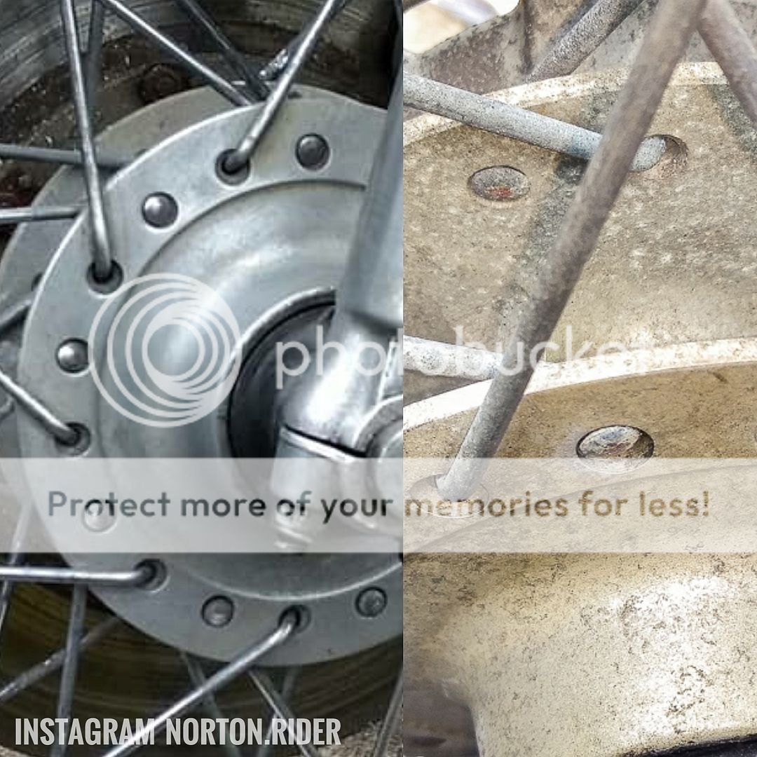

Hi, Really enjoying seeing your progress. I see you had problems stripping paint... If you need to strip paint or powder coat use Starchem Synstryp .... rover.ebay.com/rover/0/0/0?mpre=https%3A%2F%2Fwww.ebay.co.uk%2Fulk%2Fitm%2F171147499207Use it in a well ventilated area , preferably outside and wear overalls , gloves and safety goggles - it’s strong stuff Don’t let the Synstryp go dry once you’ve applied it - leave until the paint or powder coat surface goes soft and jelly like - don’t try and remove the paint/powder coat too early when the paint/powdercoat surface is wet with the Synstryp either - if you put it on carefully with a small brush and follow this advice you can strip paint and powdercoat without damaging paint nearby - make sure you mask and protect areas that you don’t want to be stripped or damaged. ! Hope this helps. Cheers Paul

Thanks everyone really appreciate the comments an offers of help up nice an early an getting stuck in didn't realise Norbo did aircooled parts sooner give our main man my money than shambits had some issues before on my elsie parts myself just having a look at Norbo's ac page now. They are trying to sort it this morning so we shall see.

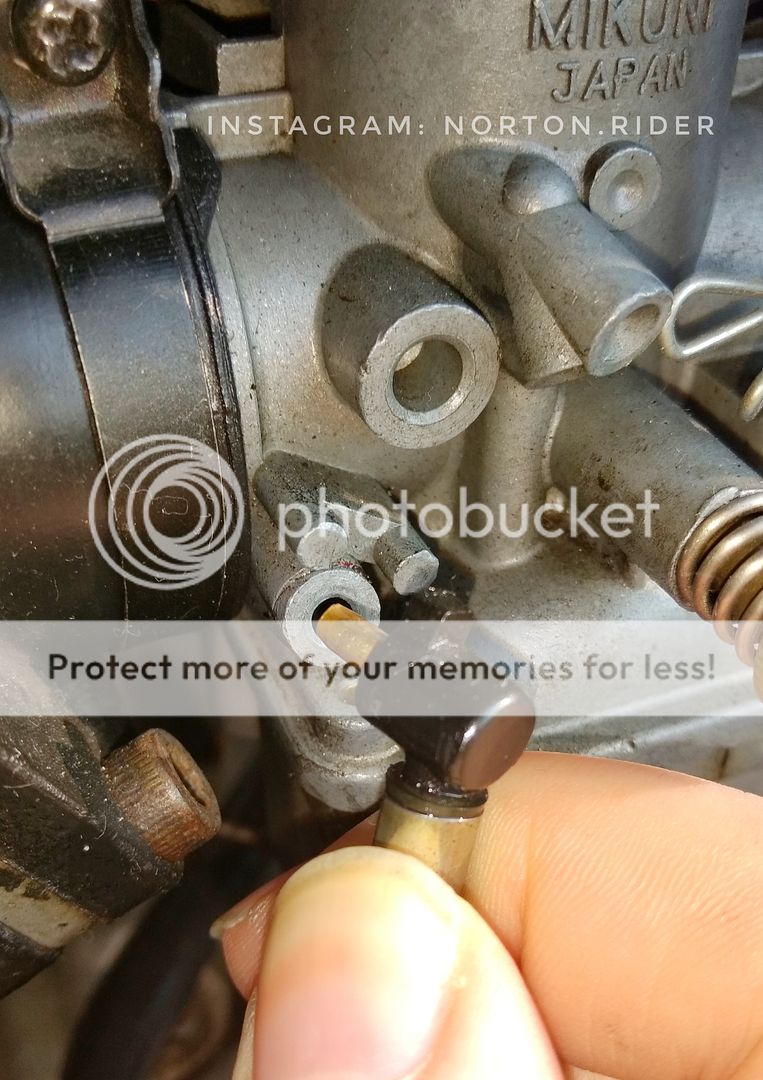

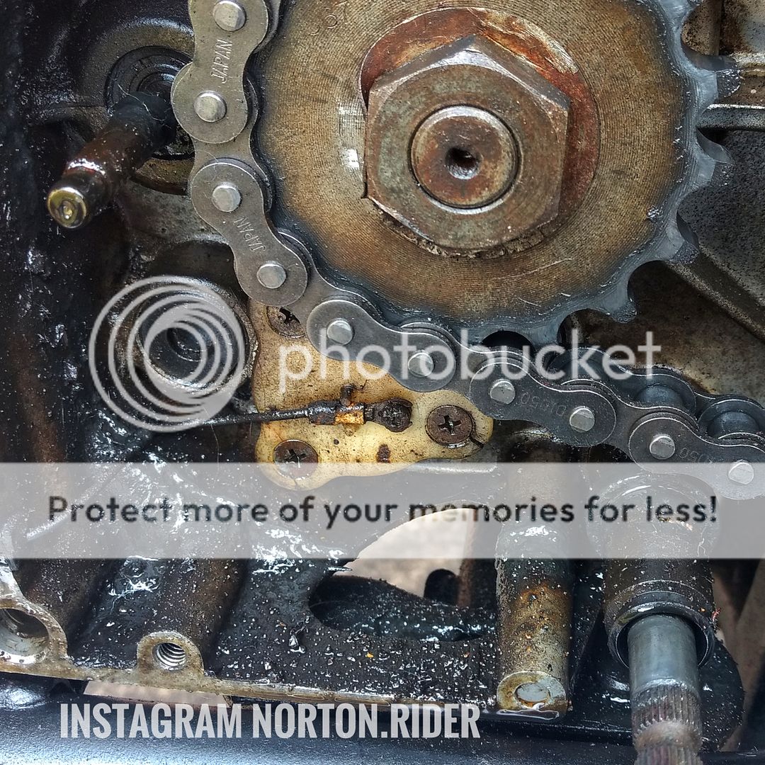

Well I'm really glad number 1 I'm observant an number 2 a lil lucky haha. That ive not run or gone out on it yet. Has anyone ever had to repair a oil feed like this? Guessing the easiest way will be to glue the plastic to the metal rather than metal to metal incase of blocking the feed but just wondering what to use. IF I REMEMBER CORRECTLY THEY WERE JUST FRICTION FITJust drawing up a list the bikes that original though not much to get

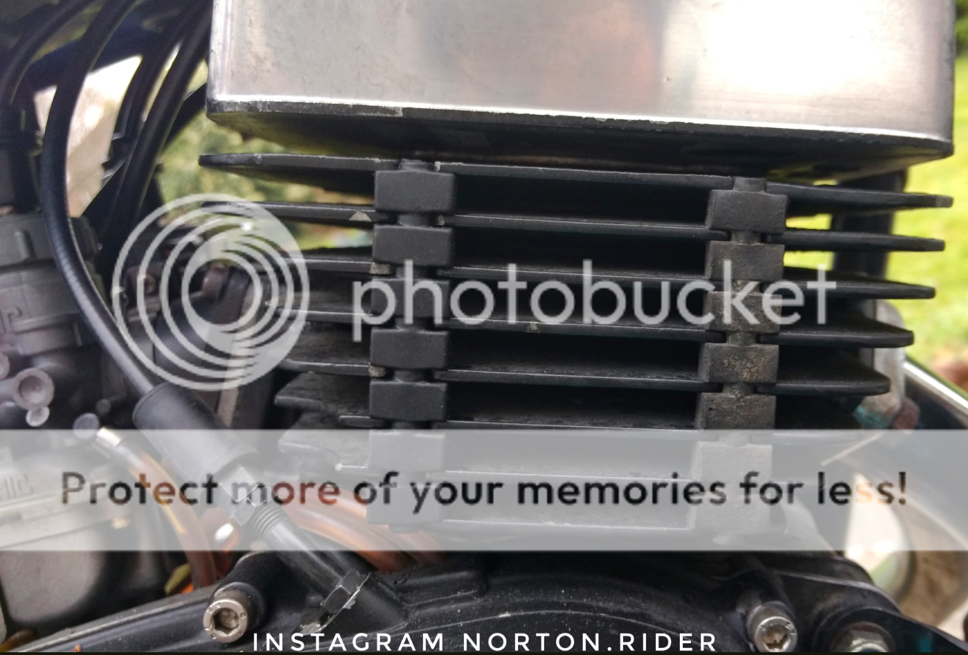

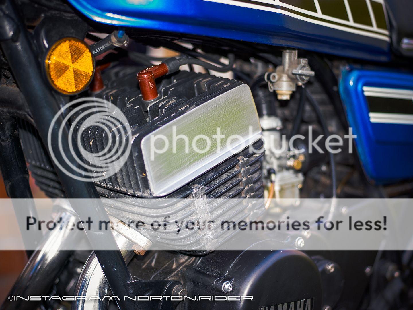

The cases and barrels have come up really well Makes a huge difference. Nice job Dusty

Thanks Dusty! It's made a huge difference to how fresh it looks on the flesh

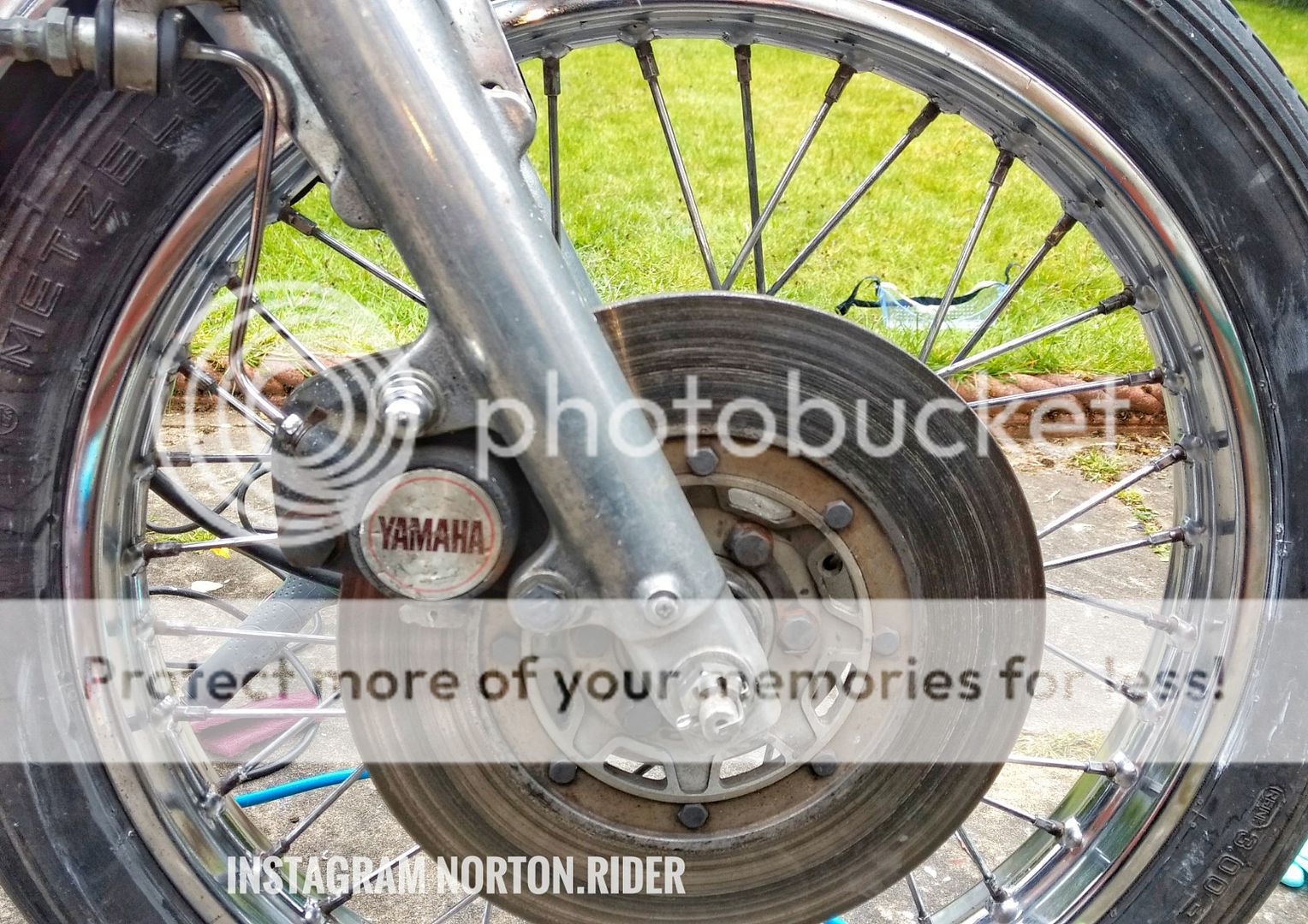

I'm only going by the pictures of course but how bad is the scoring on that disk?
Going by pictures 9 and 10, what's that sticking out below the caliper, looks like it's had the wrong brake pads in there? Maybe you should fit a new disk??

Hi mate the flash is making it look alot worse actually getting a new caliper this week as I'm not happy with how badly one of the pistons is seized in
