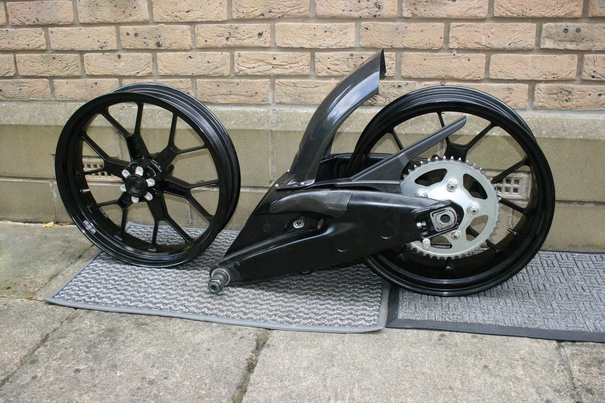

Found this If you squint a bit ........ Mike
Post by mick858 on Jan 3, 2019 16:33:37 GMT 1
I reckon you could get it looking like the top photo with these
