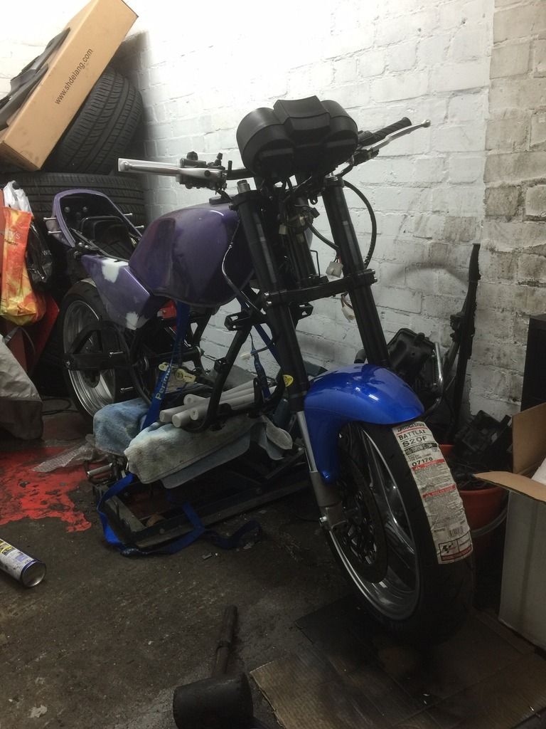

Post by Slabsideian on Feb 25, 2016 19:42:19 GMT 1
Got the forks back today from bring reassembled after anodising and I must say I'm quite happy with them. Couple of the mudguard bolt holes are a bit ovaled so I whacked them on just to see how it looks and make sure I can nut and bolt it on rather than relying on the threads. Clearance is good so off them come tomorrow to paint the bottoms of the forks. I can then stick them back in and get the calipers on and bled etc. I'll be able to push it outside for som better pics aswell
Post by Slabsideian on Mar 1, 2016 13:23:22 GMT 1
Got the xl rad from norbo plus some other bits and peices (thanks norbo) Needs some spacers to make it for so me old mate had the idea of these Exhaust rubbers for a Nisan. Had to cut the down a tad but did the job nicely Incidentally they also work nicely for the clock rubbers that bolt to the yokes.
Post by Slabsideian on Mar 1, 2016 15:21:55 GMT 1
Post by Slabsideian on Mar 1, 2016 16:46:35 GMT 1
Post by Slabsideian on Mar 1, 2016 19:47:19 GMT 1
Forks in, wheel on, calipers half on. Should be all on properly tomorrow, then I can get it moving around, get the wiring loom on with the battery tray etc. and get it outside so I can see how it's looking properly. It's hard to see in the little room at work. I need to sit on it to check the lock stops as one side misses completely and the other side perhaps doesn't quite have enough. Will get some more pics on as it comes together.

Post by Slabsideian on Mar 1, 2016 20:36:20 GMT 1
Thanks gentlemen. Tell you what I keep going on about smoothrite but it really is the dogs danglies. It goes on nice and dries to a perfectly smooth finish. No primer needed either. I even painted my cut down plastic rear mudguard and under seat tray with it. It comes in satin black, gloss black, silver, gold, blue, red, yellow and green. Yeah I'm looking forward to getting it out of the confined space to see how it looks and get some better pics. I'll stick the tank back on with the panels on to get a better idea but I've sent my seat away to a guy to do a guilliari conversion so I'm waiting for that to come back. Progress again! hallelujah!
