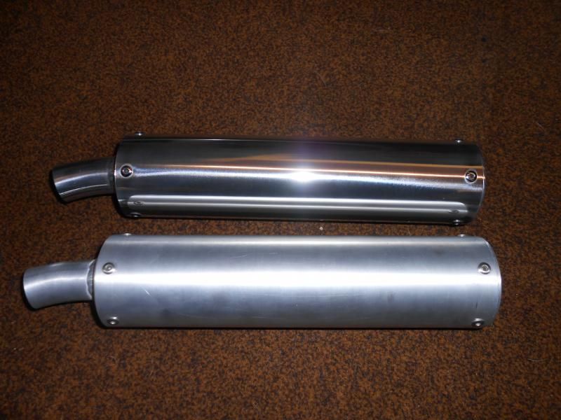

Hi I bought some polishing mops and soaps from Kempton autojumble last year, and used them in my bench grinder. Didn't take long at all, 5-10 minutes each can maximum. Not too blingy but nice enough. I bought 6" mops which last ages. Dusty

Post by dusty350 on Mar 15, 2015 20:59:43 GMT 1

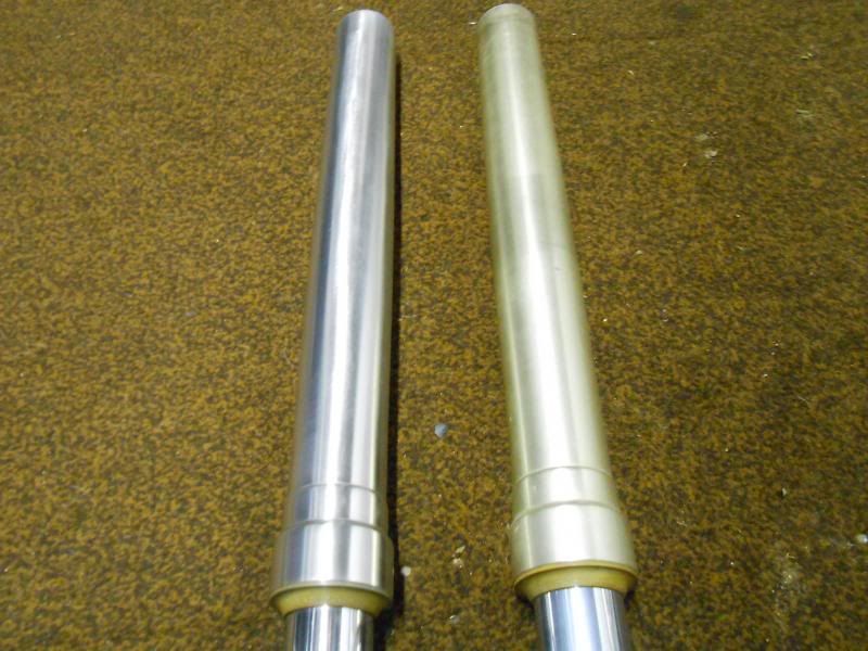

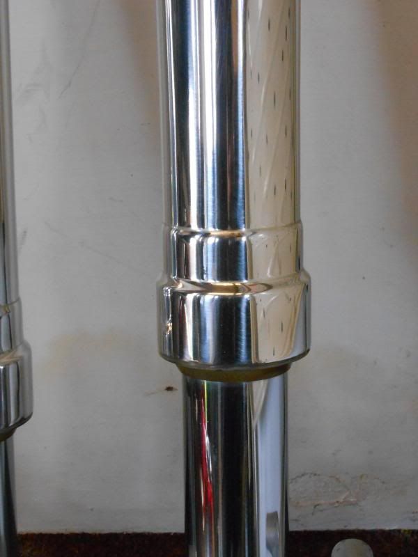

Hi, I bought 2 bars of polishing soap. Use the brown to start and finish with the blue. You can get finer soap for mirror finishes but I didn't want the extra bling. The ally on the TSA pipes was raw so it was quick and easy to get them looking shiny. I did my Belgarda forks too, that took ages as they were anodised and had a very fine milled finish to them that I had to polish out; The Rgv forks will get the same treatment at some point Dusty

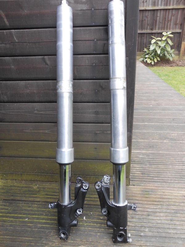

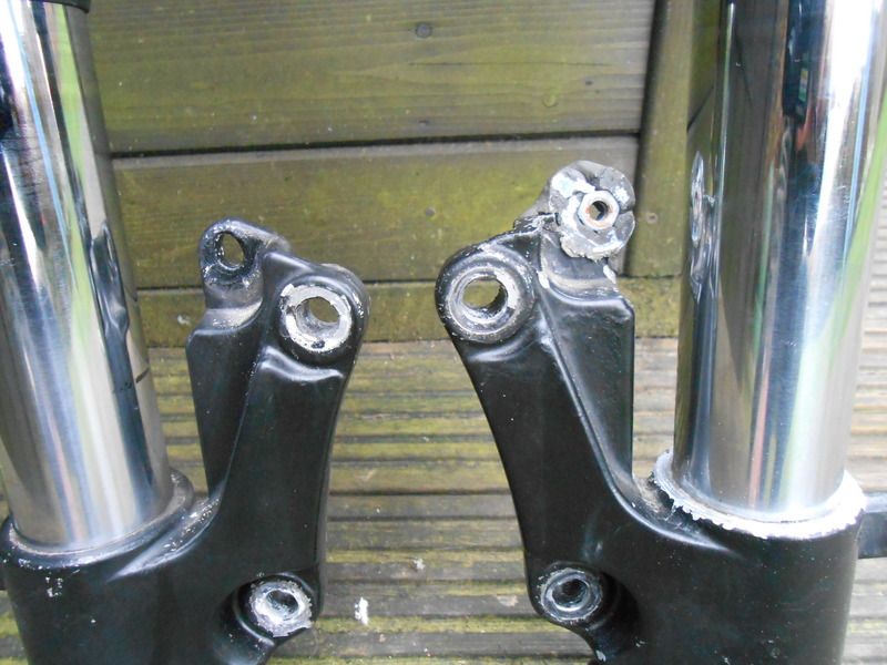

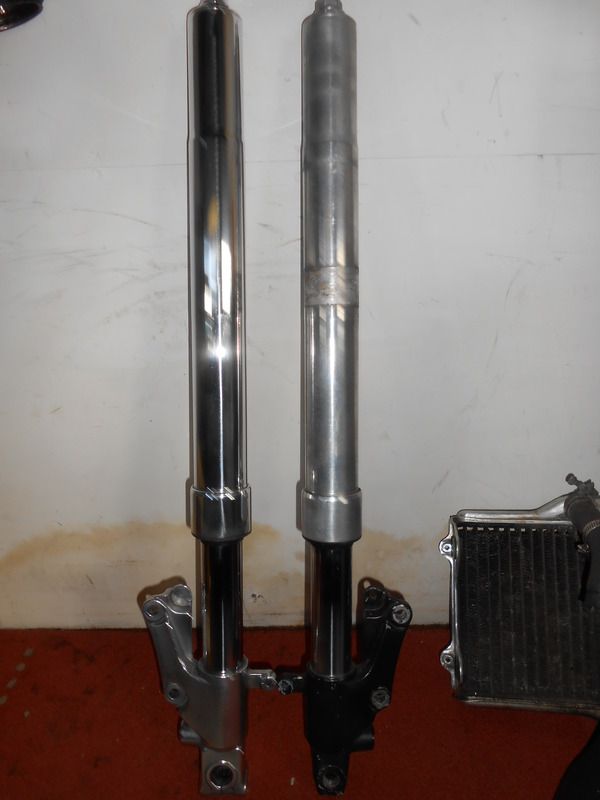

Hi This is beginning to escalate now !! Forks off today as I want to get a repair done on the mudguard mount. You can see the existing "repair"; It did the job but looks horrible, plus it meant the mudguard had top mount on the outside of the repair. With some light pressure the piece broke off, so I got the paint off ready to take it for welding next week; Whilst the forks are out I might as well polish them - be rude not too as they need some tlc; Now I am looking at the wheels thinking whilst the bike is jacked up I might as well get them powdercoated, not sure to go black or white ? Dusty

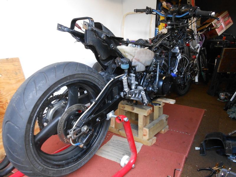

This was earlier this afternoon; Done a bit more since. All that's left now is swingarm, yokes , engine and rad which I'll do tomorrow if my back feels up to it. I dropped the fork leg off today. My local fella is gonna build it up with weld and I'll shape it and then polish it up. Then I need to get the engine out of the F2, so lots to do. Regards Dusty

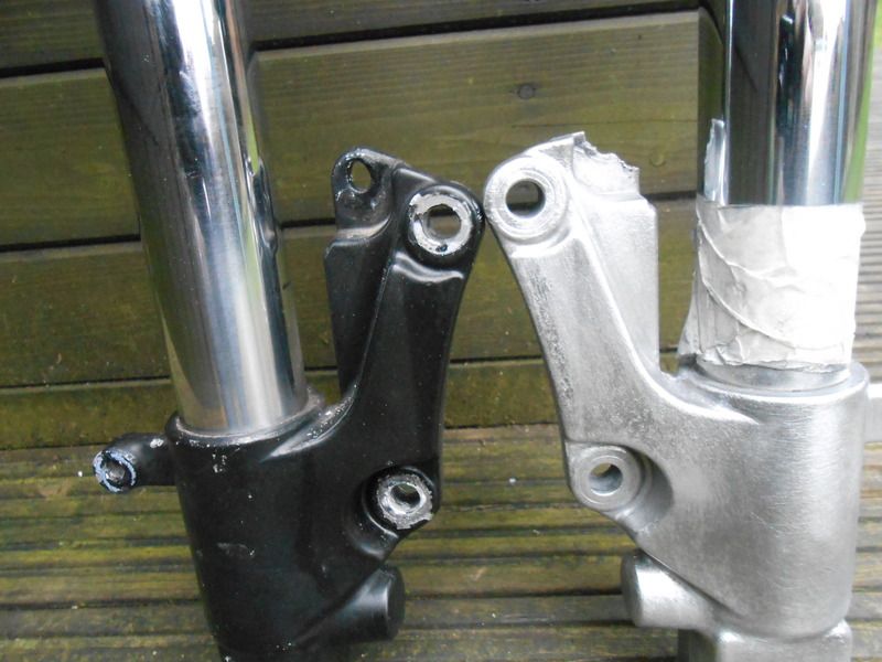

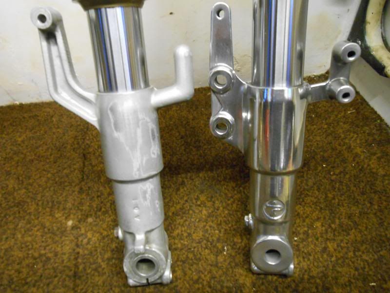

Hi Fork has been repaired and I picked it up today. The damaged area was built up with magnesium weld and shaped to look standard again. Cost me a fiver, though I did treat them to donuts which got them very excited !! Not sure whether to polish the fork bottoms or paint them. Does anyone know how you remove them from the chrome sliders ? I have also looked into getting a Metmachex swingarm that will accept the Rgv wheel. I saw the add on ebay -£715.00 posted. When I sent an email today confirming a few things, I'm told to fit a chain protector is £25.00, mounting tabs for, and including a chain guard is £40.00, and postage is £30.00 I know they are nice, but £800 for a swingarm I have a Lc Metmachex for a Ypvs wheel, but it's approx. 25mm narrower at the wheel spindle than an Rgv arm. I had a quick look the other day to see if the Rgv could fit this, but I will be looking a bit more closely this weekend !! Forgot to add that if I wanted slotted adjusters as opposed to concentric, that's another £60.00 ! Dusty

Hi The Lc is now completely stripped of all parts. The frame looks in really good condition which is good. I'm not sure whether to get a bracket for the pv motor welded in like the last one I did, or make a bracket that can be bolted in. Will research the second option a bit more. I need to improve the lock stops on the bottom yoke, and I need a better side stand, and once that's all done the frame and parts can go off for powdercoating - gloss black again. Wheels will be white gloss. Rear end will be a Metmachex, hopefully, and the front end will have the Rgv forks fitted. I started to polish one today, taken about an hour and a half so far with a bit more to go; Not a great pic, but you can see the difference. You can also see the repair to the mudguard mount on the left leg. Just needs a hole drilling in it. Footrests will get polished too. The engine and loom from the F2 will be going in this, and I am swapping my TSA pipes for some chrome small can Allspeeds. I am selling/breaking the F2 rolling chassis to fund this, so hopefully it will be a quick build. More soon. Dusty

Hi The Lc is now totally stripped down, and I am in the process of collecting parts. I have ordered a Metmachex arm that will take the Rgv wheel - should be delivered this week hopefully. I have a nice pair of chrome Allspeeds out of a Ypvs/Lc hybrid that I swapped my F2 Tsa's for. I'm still polishing the Rgv forks - they are proving to be a pig to get nice . My Lc clock bracket is at the engineers at the mo - I want it angled up a bit so the clocks don't sit as flat as they did. I now have a nice standard seat that's been recovered, and a good straight sidestand too, and I am hoping to pick up an airbox and better inner mudguard tomorrow. Once I can find a piece of angle steel for my pv motor mount to get welded in, the frame and yokes and other parts can go off for powdercoating. Dusty
