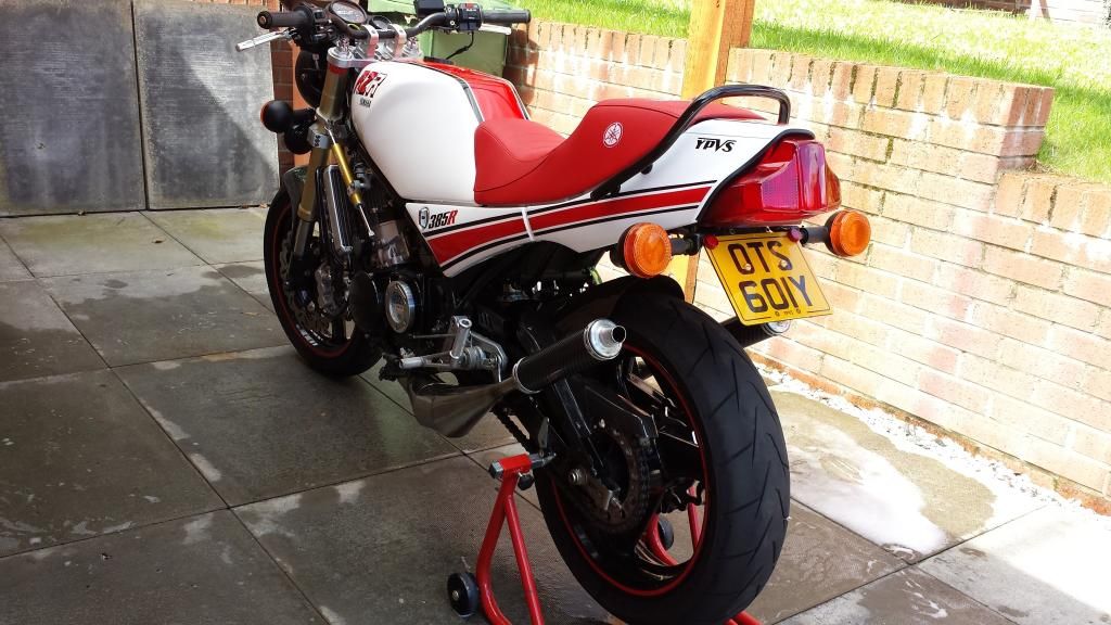

Wife away for the weekend so spent the evening in the garage. NK kit fitted swingarm fitted along with shock, picked the powder coated spring up earlier Hopefully get it back on it's wheels tomorrow and get the zeel fitted ;D Steve

very tidy bike good standard of hard work on this should handle like a dream Hopefully so, managed to get it back on it's wheels about 30 mins ago and had a sit on it. A lot firmer than before, if it's dry tomorrow I'll take it round the block and see. Can't do too much on it as just fitted the zeel so on a standard prog and not been checked with a strobe yet. Had a peek up the exhaust ports just to check if the 100 mile run then thrashed had been ok and glad to say pistons are perfect with no marks. Also swapped the pilots for 36's and fitted thum screw air scews so at least I can adjust without having to take the carb off. Steve

Cheers guys Had it out the other night, wow zeel makes a massive difference. Relentless from 7k till 10.5k rev limiter so has sorted the power tail off above 9k. Doesn't feel so good between 5 and 7 so going to keep valves closed a bit longer as they were starting to open at 4300. Hopefully get it out tonight if it stays dry, valves set at 5500 till 8300 now so time will tell. Suspension brilliant, no diving under braking and a lot more taught and precise. Actually feels like a larger modern bike now and the 36 pilots have sorted the stutter at light throttle. Hope it stays dry Steve

Finally back together after partial strip to get to the bottom of the rattle, solved now. Seemed a shame as the zeel had a shift output not to use it so made up another rev counter with a light in. Had a mark on the face but sorted with one of norbos decals and a pair of scissors Got the big rad on and fitted the 50 degree stat but not had a chance to try it out although before It came off the road again I adjusted the pv opening and got back the mid range. Also swapped the alloy cans for carbon, as has been said, once you put one bit on it's addictive. Just waiting for the RZR import painted tank to come back and it's getting nowt else spent on it. Steve

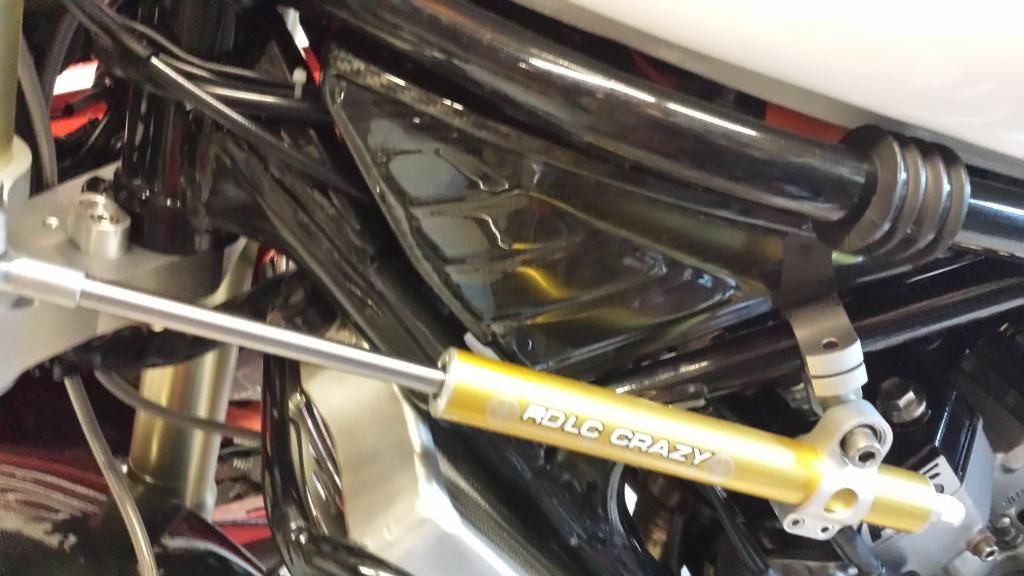

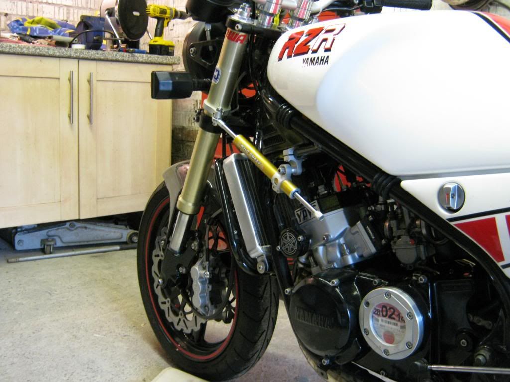

Post by midlifecrisisrd on Jun 15, 2013 17:21:35 GMT 1

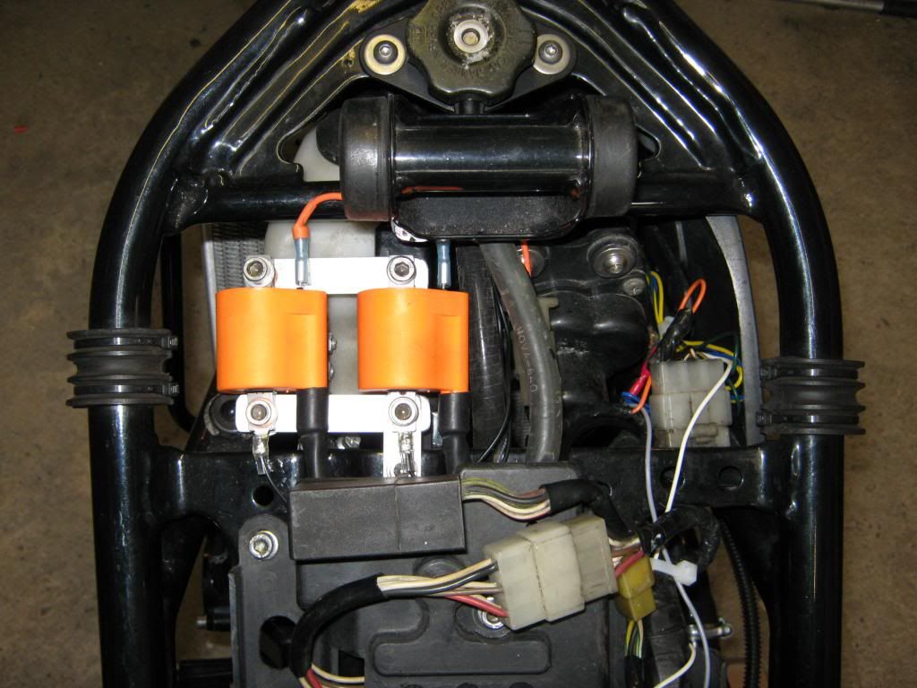

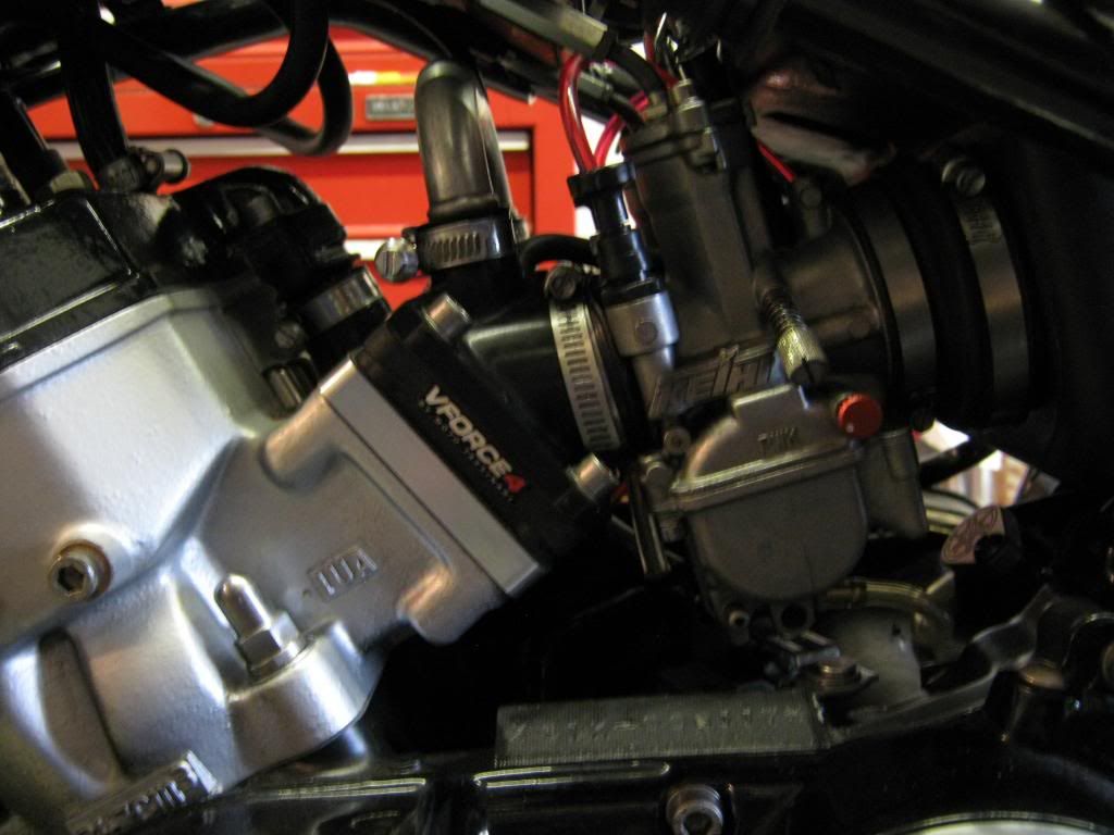

Got the 4 force 4's fitted with new spacers, 140 mains and the banshee coils. Steering damper should sort it's head shaking RZR Jap spec tank fitted and a bit of bling with a billet oil pump cover Mot'd yesterday so just need the rain to go off. Steve

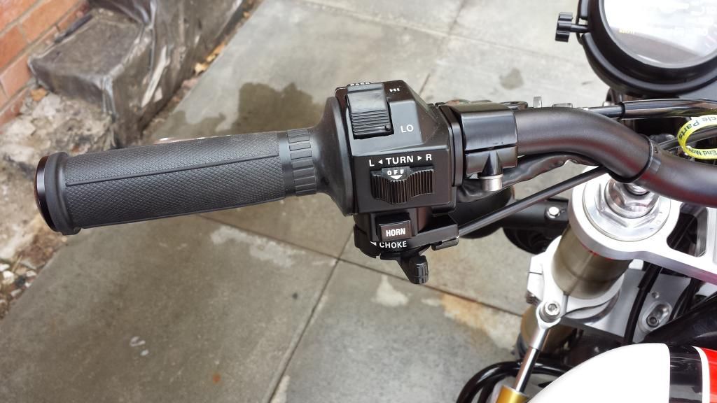

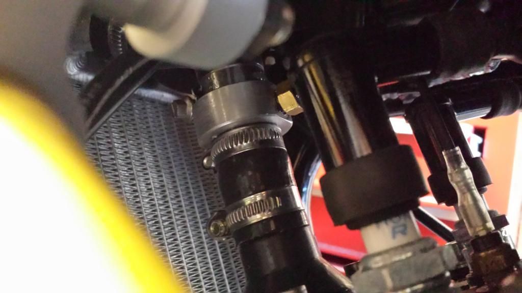

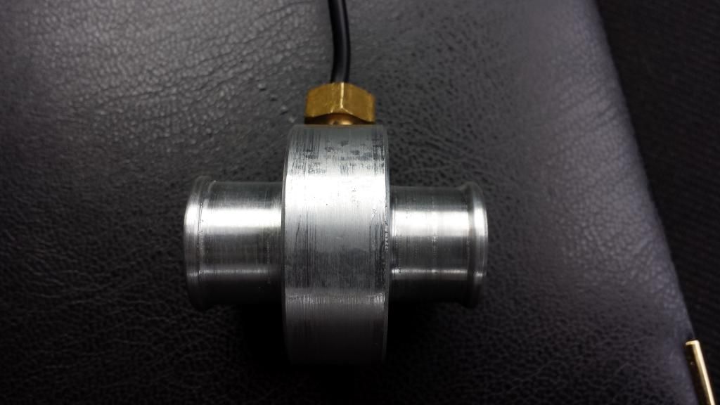

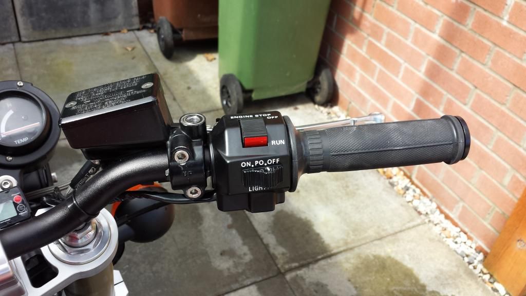

Post by midlifecrisisrd on Jun 20, 2014 17:38:39 GMT 1

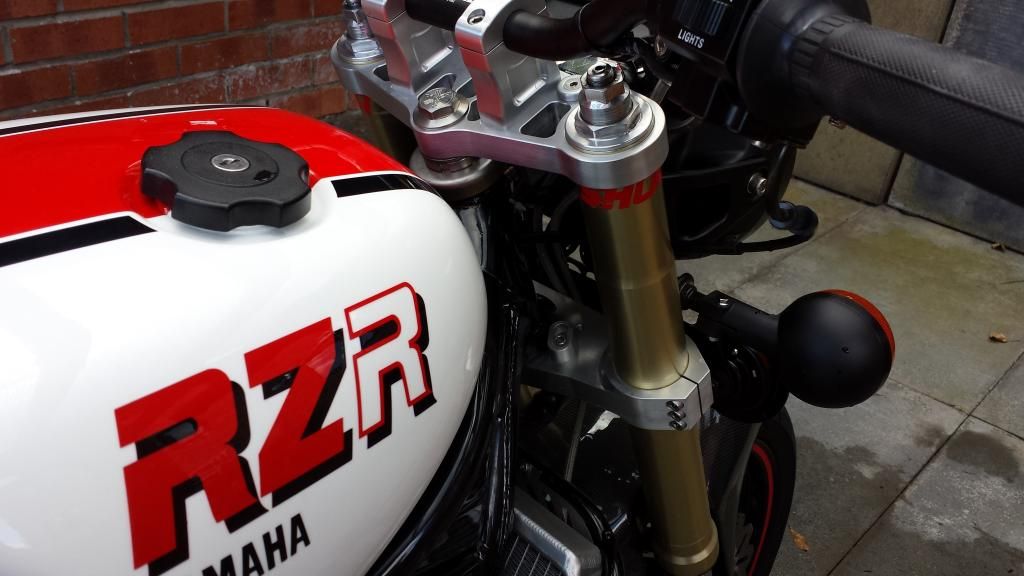

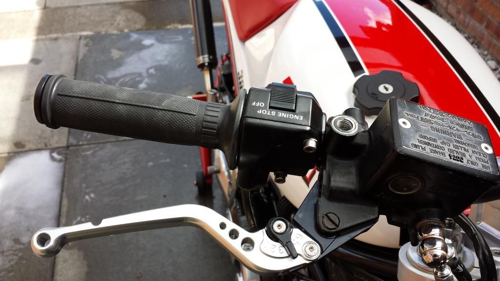

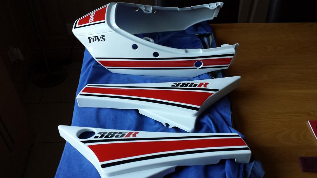

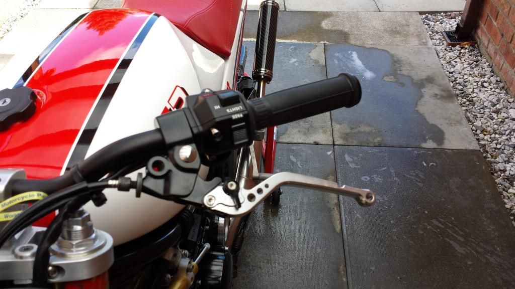

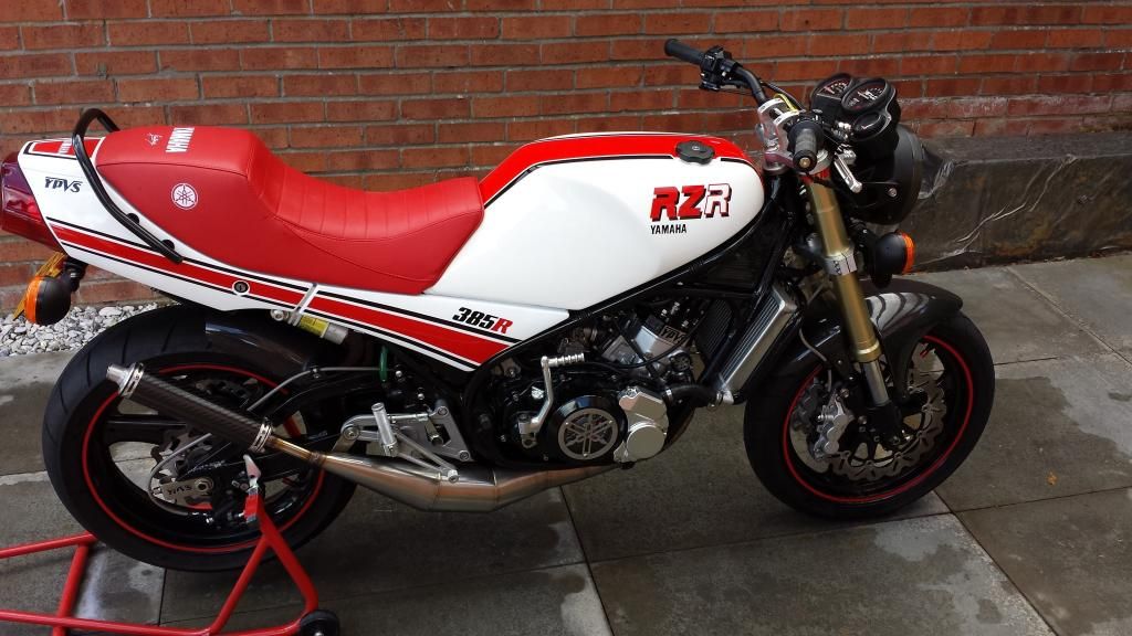

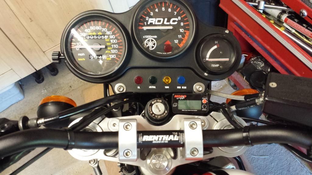

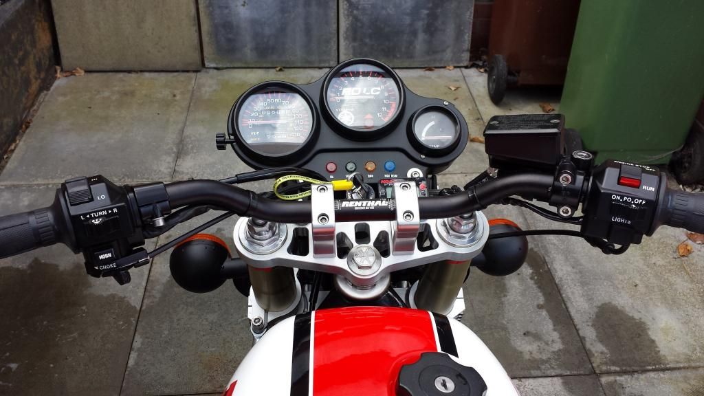

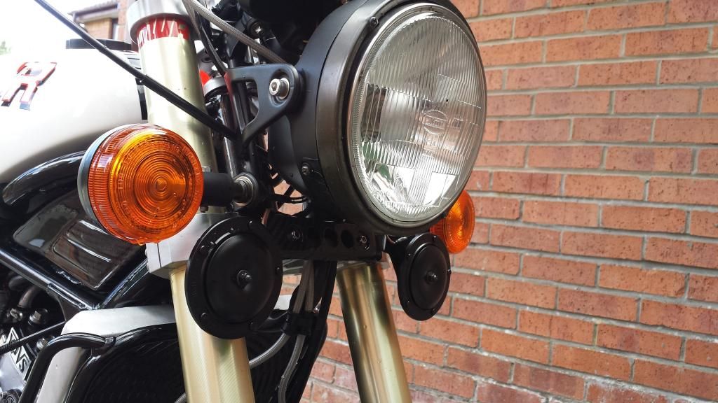

Done some mods/additions for 2014 so thought I better update the thread. Fitted the Mitaka basket, XS 750 plates, new gen springs and all bushes/thrust washers replaced. Even fitted a new idler gear while I was in there and took the chance to get the case powder coated as the paint had blistered at an edge. Took off the pattern N1 style indicators and fitted new Gen Yam Lc2 ones (ouch) Then eventually got round to fitting twin horns, Gen horns and new Lc2 brackets. Even a cheaky Lc carbon horn cover Then some NOS switchgear, LH from and XS to get the handlebar choke Got a billet brake lever for the Fazer Master cylinder and managed to get the clutch one to fit a NOS perch with stainless pivot bolt Then spondon440 off here sorted me with some yokes Carbon frame infills next Also wanted a more accurate temperature reading so got a fitting made to get it in the top hose And fitted And a Koso temp gauge Yokes look amazing Bodywork on the bike was done with hand cut vinyl which was not lacquered so got a set on new repro side panels from 14cheeks and found a NOS tail unit to get painted and decalled to suit the bike and show the engine size Finished for this year........................ ......................Maybe Steve
