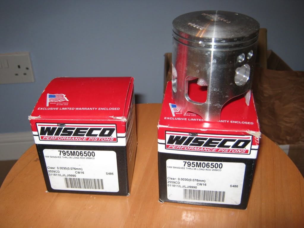

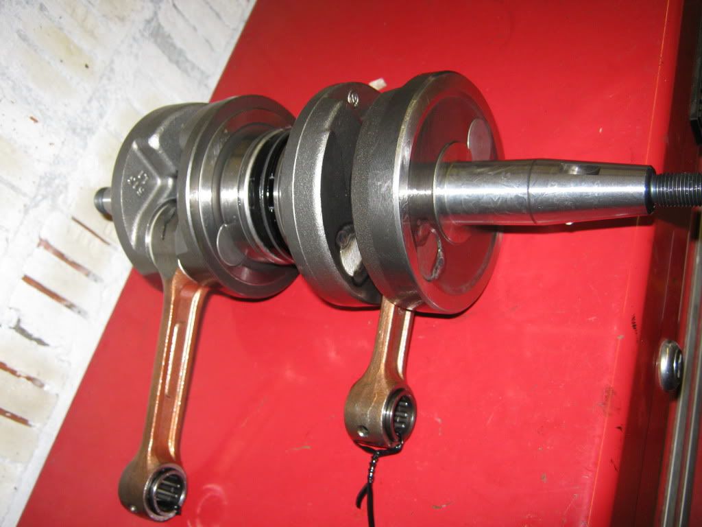

Hi, Was never 100% happy with the tuned engine in my Lc2/Vj22 hybrid, ran great but was a little noisy on the top end. Turns out it was on 1.5 oversize and although recent bore and pistons the clearances were a little on the large side so decided to do a complete new motor. Idea was to build another with new crank and tuned top end but got a bit carried away. Few emails to Tss later and a bruised paypal account and I'd ordered a +4mm balanced long rod crank with the uprated outer mains, a set of upgraded gearbox bearings and a set of 1UA pv's. Managed to pick up a low mileage RZ250 motor that looked like it had ran out of oil, original bores but scored and crank had a lot of heat marking and a melted LH seal. No worries as was only after the mint gearbox and unmarked clutch basket, managed to sell the rest for more than I paid so happy days. Got a second set of cases nicely matched to barrells Got in touch with Glyn at GPL racing (slinger) regarding the set up and he agreed to supply some Wiseco 795 65mm pistons to take up the extra 5mm rod legnth and machine me a head to take up the extra stroke and oring it. Got some PWK 28's for it with TZR reed blocks and Kenny is doing me a set of stainless matched stroker pipes. Just about to send the barrells to Mick Abbey to flow them and alter the port heights and floors as per Glyn's spec. Got a good set of 1UA 0.25 barrells but feel guilty boring these out to 1mm so waiting for rave to come back as he may have some more suitable others. More pics as I go, bring on next spring. Steve

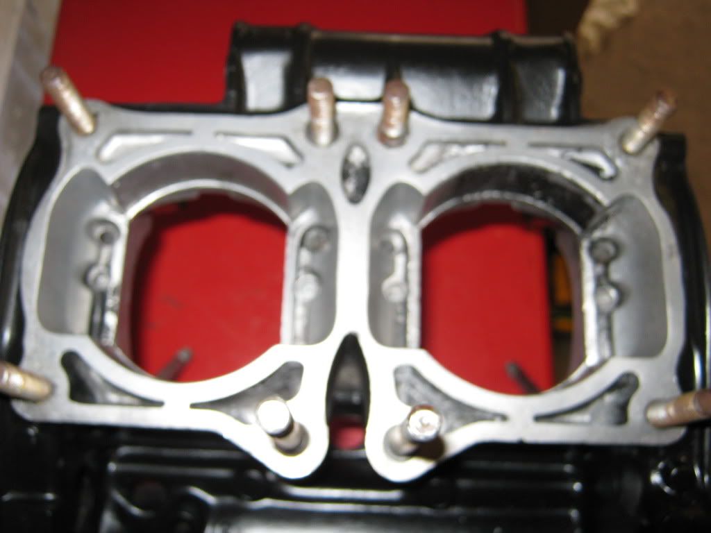

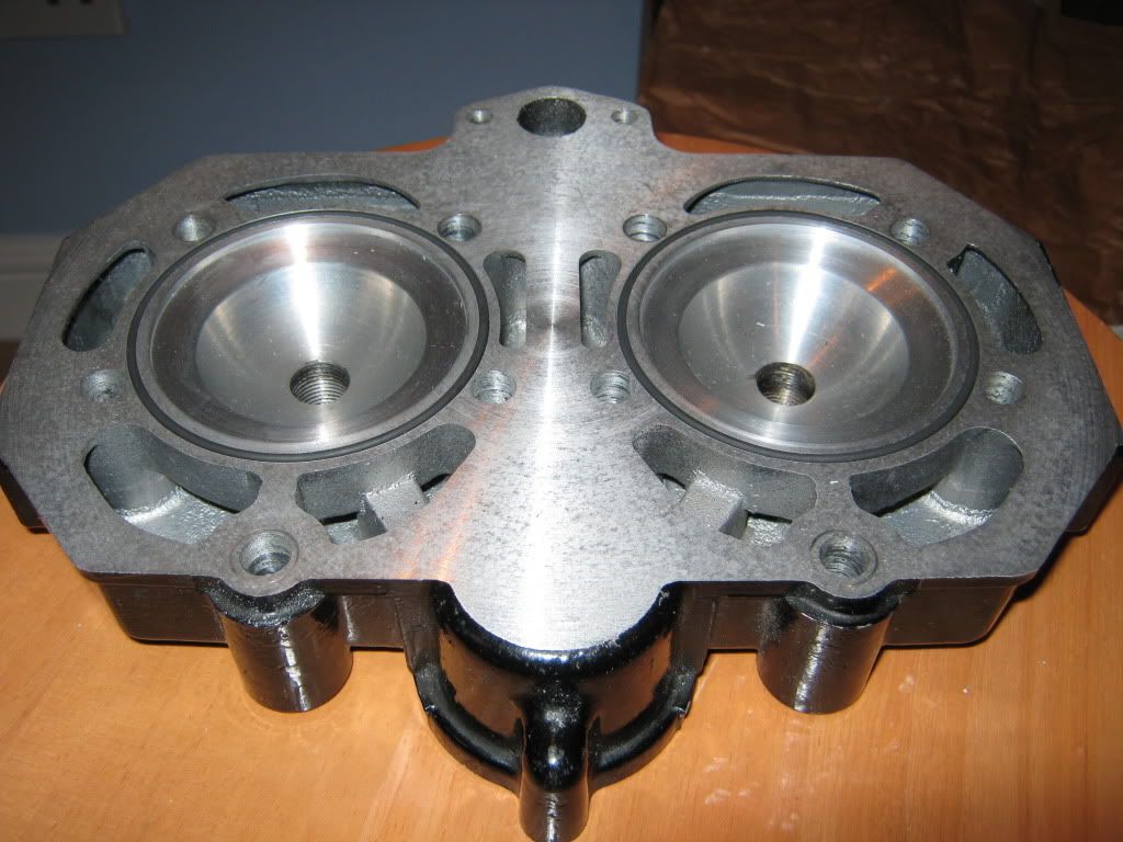

Post by Norbo on Oct 5, 2011 11:47:55 GMT 1
thats a grate start . Why did you O ring the head and not the barrels if you dont mined me asking . most do it the other way around.

Post by midlifecrisisrd on Oct 5, 2011 14:06:17 GMT 1
thats a grate start . Why did you O ring the head and not the barrels if you dont mined me asking . most do it the other way around. Mostly because that's the way glyn does it. O rings are a nice snug fit so don't fall out, think the head might outlast the barrells anyway. Steve

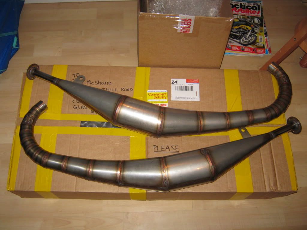

What pipes are you gonna run with? Kenny ( TSA ) has the measurements for the pipes to match this kind of motor so will be making them. Did have a set of Kenny's "Mick Abbey" design pipes that I was going to use which would have worked but the "stroker" pipes add 7 BHP accross 5k - 10K rpm and peak at 9900 rpm so don't have to rev the nuts off it. Steve

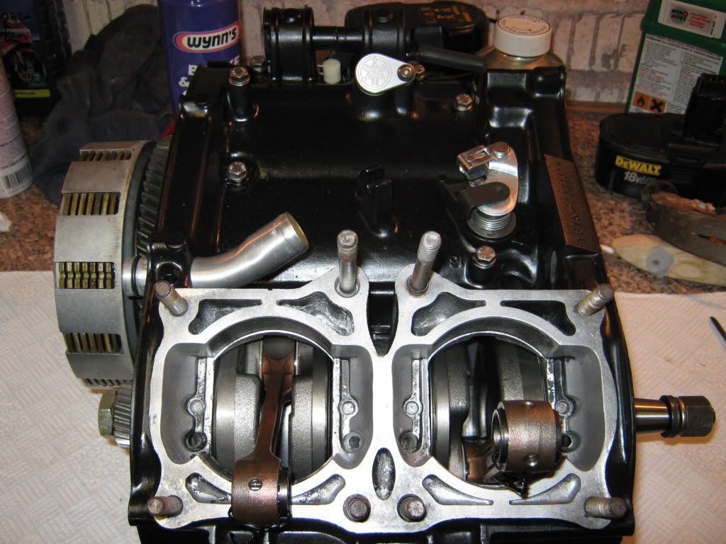

Bit of an update, barrels now with Mick Abbey for rebore and porting. Uprated gearbox bearings fitted, doddle as did not realise the big ones were not pressed on, simply slide on, was surprised sprocket shaft bearing is the same as the crank mains. Threebond from ebay finally turned up so new seals fitted and crank in and cases bolted together and even selects all the gears so happy days Hopefully get the clutch basket cleaned and fitted tomorrow. Now can't find the plastic spigot for the crankcase breather, know I had one but can I find it now Steve

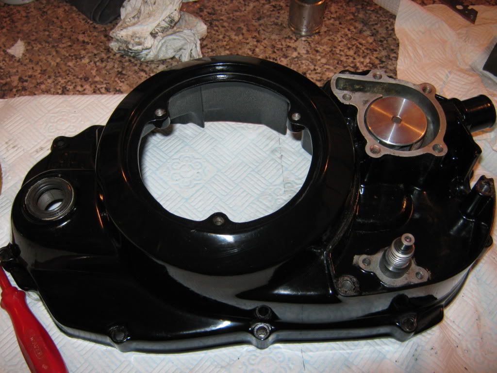

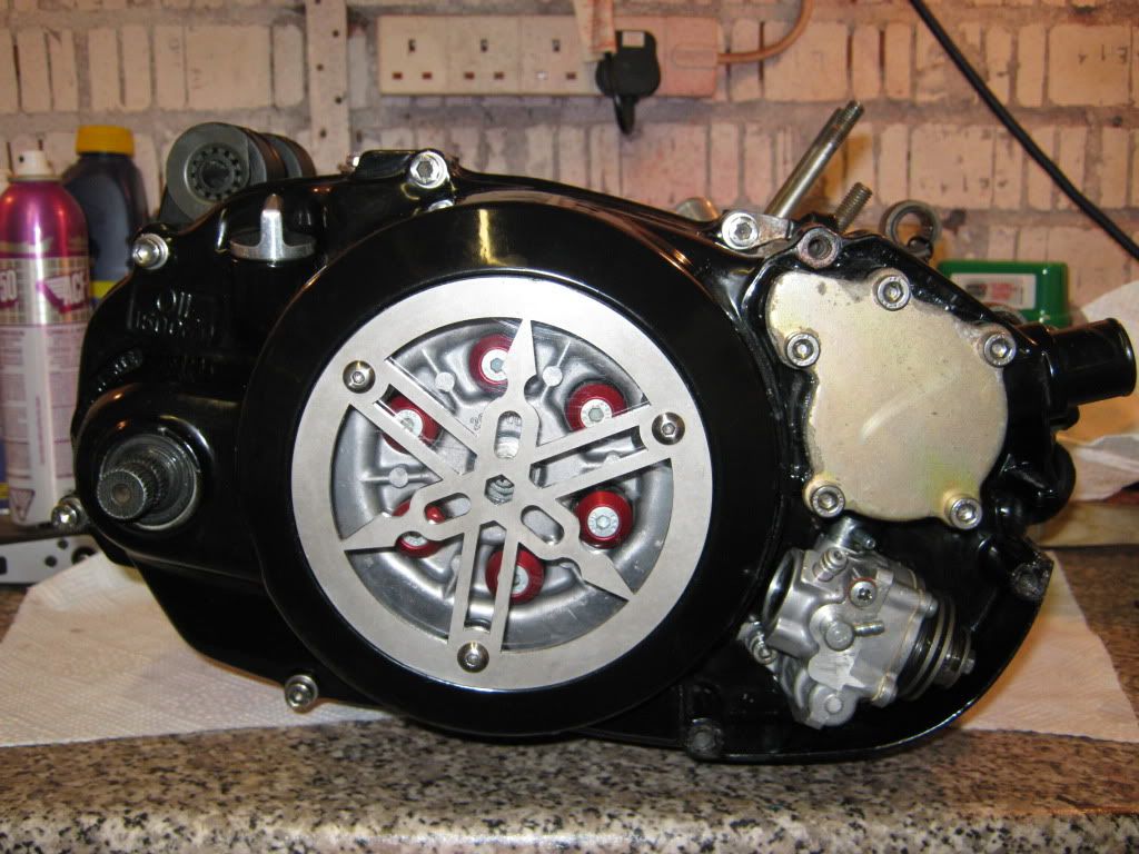

Got a little time over the last few days so been busy Pump stripped and rebuilt as per nik's thread Clutch built up using the good bits out of the other motor and the unmarked 250 basket with a set of norbo's clutch washers to finish it off. New clutch arm fitted along with tacho blank Clutch case ready with new water pump bearing, seal and a high flow impellar. Oil pump seal changed of course. All ready for the top end which should be ready next week Steve

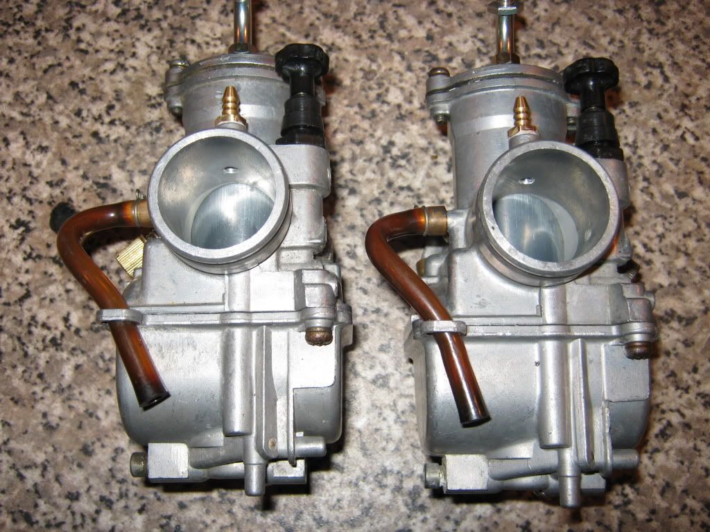

Got another couple of things done, carbs this time. Was going well till I knocked over a tin with the jets and stuff in it and managed to lose both needle circlips on the floor so f*cked now, will have to find somewhere to supply them. Got the pilots fitted along with the idle screw to replace the extended one on for the Kr1 and fitted the angled tops and the pull chokes Cut and drilled out the vac point and tapped it M5 along with doing the other carb to match. Found some nice fittings on the scottoiler site for the oil spigots, they do them in M5 or M6. Steve

Spoke to Mick and he should finish my barrels today so will get some progress soon. Got a very nice delivery from kenny today, pipe porn Put them against the bike and seem to fit perfectly even though he never saw the bike to get them to clear the rear end, top man. Been looking at the airbox as I'm using 10mm reed spacers, not too bad actually as the pwk's are 5mm smaller than the vm26's so going to move the airbox back to ease fitting the rubbers. I can feel some of rave's plastic welding coming on. Steve

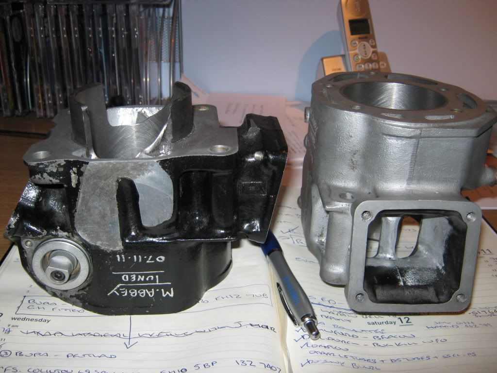

Another nice parcel on the doorstep when I got home. Barrels back, rebored and ported as per Glyn's port map and and about 6 hours of Mick Abbey's time. A really good price for the work that goes in to them. Need to get them cleaned and painted now, can't decide whether to go gloss black or silver. Decisions, decisions. Also got to helicoil one of the exhaust threads then it can go together. Steve
Post by portgrinder on Nov 11, 2011 10:54:48 GMT 1
That was 6hrs per cylinder Steve Mick
Post by lcowner on Nov 11, 2011 10:57:12 GMT 1
u musta went for ur lunch a few times
Post by midlifecrisisrd on Nov 11, 2011 11:35:40 GMT 1
That was 6hrs per cylinder Steve Mick That makes it even worse, that's child labour prices ;D Steve
