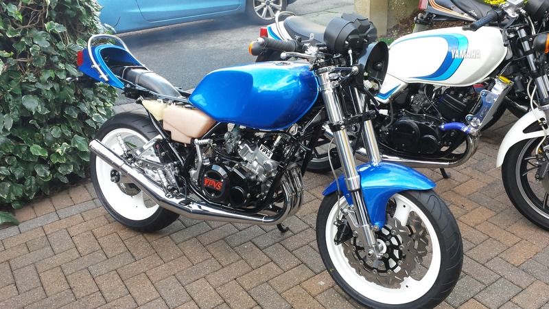

Cheers Gaz I had considered rearsets but I didn't want to mod the chrome brackets on the pipes, or make a decent looking bracket to make it all fit. If my pipes were painted I might have considered it. One thing I did notice is I will need an offset front sprocket. I only had a quick look but I could see the chain wont run straight - sort of knew that but it's the first time the engine has been in this frame. The Lc engine originally fitted had an offset sprocket, although it was running an Rgv "P" arm, so may or may not be correct regards the offset. I'll measure and get on to Talon I expect I've got most parts to finish - need a rad - was considering one of the Chinese rads on ebay - there is one fitted to my new Lc, but I may go with one of Norbo's or MBD do a nice one - there is one fitted to the 385lc I have and it looks excellent quality. Will also need to make a mount for the electrical boxes, but there is lots of room now the airbox is out. Regards Dusty

Regards Chain run I used a 6mm offset front sprocket and had 3mm machined off the sprocket carrier face that's using a 520 heavy duty chain.

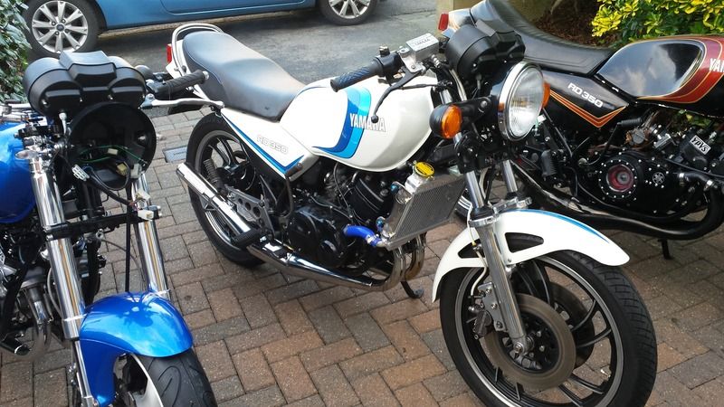

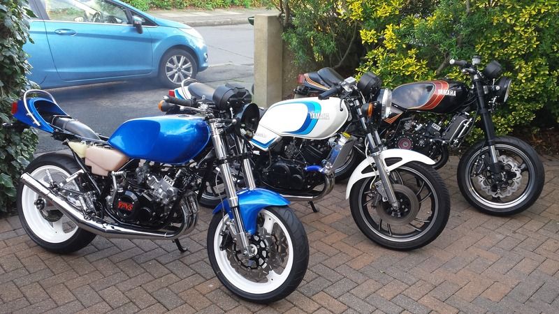

Post by dusty350 on Dec 31, 2015 13:42:39 GMT 1
Hi all After a long couple of months of home diy, I can start thinking about my bikes again !! Got them out of the garage today to start thinking what to do next; The blue bike is a work in progress - I now have a rad for it - a Chinese item off ebay for £50 which looks good for the money. Carbs and electrics are next; The white 350 is taxed and Mot'd. I have some Hagon springs and fresh oil for the forks and am hoping to get a Yss shock for it as the original is tired now; The black 385 hybrid is at the back of the queue, needs the Zeel setting up and some other bits - a future project; It's great to get back in the garage, and I hope to update each thread soon Dusty

Post by wallcraft on Jan 1, 2016 12:41:49 GMT 1
Hi Des Rad looks good value for £50 posted. I wanted one of Martins (MBD) rads, like the one on the 385, but what with Xmas and the kitchen, I couldn't stretch to that at the moment. Haven't fitted it yet, but hopefully it will suffice until I'm a bit more flush. That's the trouble with having a few bikes - any spare cash has to be divided between them Best wishes Dusty Very nice Dusty, it's like having a kids then,dividing between them but wanting to spoil hem all! Any chance of a close up photo of the MBD rad as it's wanted on my list. Happy New year. Mark.
Post by dusty350 on Jan 1, 2016 13:50:26 GMT 1
Hi Mark Don't think I have a close up of the rad, but I will dig the bike out and take some pics for you. It's a quality rad for sure, and I like the fact it has an extra spigot for the Ypvs bypass pipe from the head - saves drilling a 3mm hole in the thermostat. As the blue bike is next to build, I may rob the black bikes rad to fit to the blue one for the time being. Dusty

Post by wallcraft on Jan 1, 2016 15:32:52 GMT 1
Thanks chaps, Dusty has yours got the long grove in the header tank like in the picture?
Mark.
Post by dusty350 on Jan 1, 2016 16:22:59 GMT 1
Hi Yep, it's the same rad. Larger than standard capacity too. Dusty

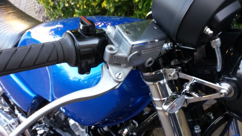

Post by dusty350 on Jan 21, 2016 10:44:29 GMT 1
Wheeled the bikes out yesterday and thought I would try the Gully seat out for size; Think it looks good on this build . I also swapped the Rgv master cylinder for the original that came with the bike; Due to the uplifted clocks, I think this master sits better. It worked well with the 4 pot Tokicos when I bought the bike so I think I will end up using this. I am going to research keeping the Lc loom - the switchgear is like new and looks less bulky than the F2 parts. It's tempting to swap all the F2 parts over but I will try and persevere ( electrics not my forte !!) Dusty
