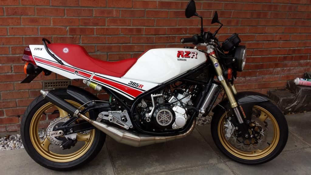

Just re read your thread, here is a link to a bike I started a few years ago, some similaritys. This same bike now has Kenny TSA Stainless pipes and is about to get some PWKs, are you running the KR1 N68x needles or have you gone the JJh route. PS nice bike you have there but I am amazed you are running cool enough temps with the standard RAD capacity, spose it's cool enough over your way. i1263.photobucket.com/albums/ii631/seahorse41/DSCF1792.jpgSorry mate, never noticed your post till I went back in to add some pics. Yes definitely some similarities, looking good. Standard rad binned and the first higher capacity one burst so running the alloy 40mm core one now. Maybe look at a fan as runs cool enough till I get stuck in traffic. I have JJH needles fitted but using the airbox. If using pods the N68's seem to be better Steve
Post by midlifecrisisrd on Sept 30, 2014 17:04:37 GMT 1

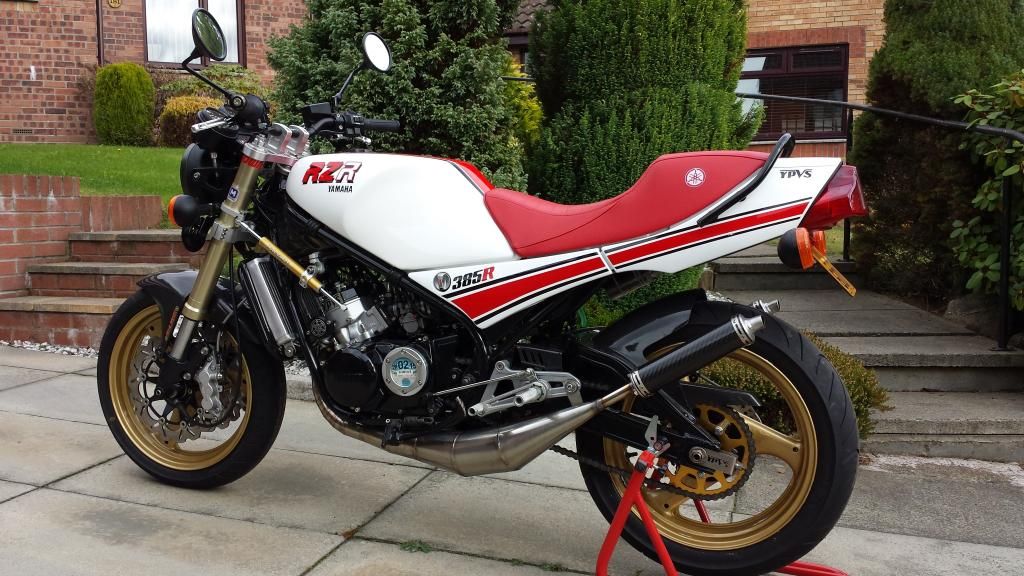

Finished for the year my arse!!! Always worried about the supposed fragile nature of the RGV sprocket carrier and the rarity of them so alternative wheels were always going to be on the list. I now have a GSXR 400 wheel in black with spacers and caliper mount made to fit but in the process also picked up a 400 bandit rear and 600 bandit front so modded them to fit and coated gold for a different look. Steve

Post by midlifecrisisrd on Oct 2, 2014 11:34:39 GMT 1
Cheers guys, had been deliberating the gold wheels for a couple of years now but glad I did them now. Not tried it on the road yet, dropped the rear from 150 to 140 to see if it makes it turn easier. Looks more egg shaped so should have a bigger contact patch on its side. Will see on Saturday how it does on the dyno Steve
