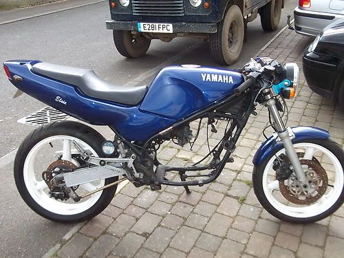

Hi all This is gonna be a real long term build, as I still have my Lc hybrid to finish, plus I have run out of funds . But, I have decided to strip it down so I can better decide what direction to head with it, plus what it will need, and also so I can do bits and bobs that don't actually cost anything. Here is the e-bay special that I started with; Sold to me as an "E" reg 350Ypvs with matching frame and engine numbers. Bike had seized on a ride out 2 years previously, engine removed, stripped, crank replaced and then interest was lost. Bores are on .25, but there are no pistons. Engine is complete otherwise. The wheels are Kawasaki Kr1, 17" front and 18" rear, Kr1 yokes with a stem swap by the looks of it and the swingarm fits in nicely. Wheels have been powdercoated and seem in very good nic. The seat unit is from a Cbr Honda, and from a distance looks really good. F2 side panels have been glassed in to the Cbr panels and some frame mods were done so it all fitted. It was far from perfect though; Its a shame because some areas of the bike look like they have had lots of time spent on them, whilst other bits look unfinished. I have decided, at the moment anyway, to go back to standard bodywork, ie side panels, seat and mudguards from an F2. I will keep the Kawasaki front and back ends, but will get the top yoke modded for risers and hopefully an Lc clock bracket. The turning lock is very limited with the clip ons. The frame is going to need some work. The area where the two rear mudguards bolt together has been bodged, so hopefully I will reinstate an original set up. I want to tidy up the bottom shock mount, plus remove the brackets for the F2 fairing mounts as they will never be used. First job will be to see if I can get the discs cleaned up; All the discs bolts came out with no dramas so that was a result !! More soon. Dusty

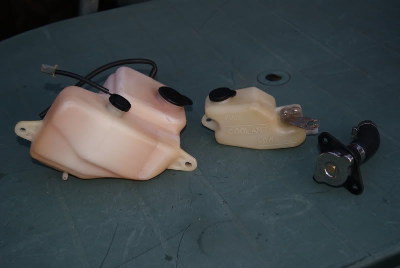

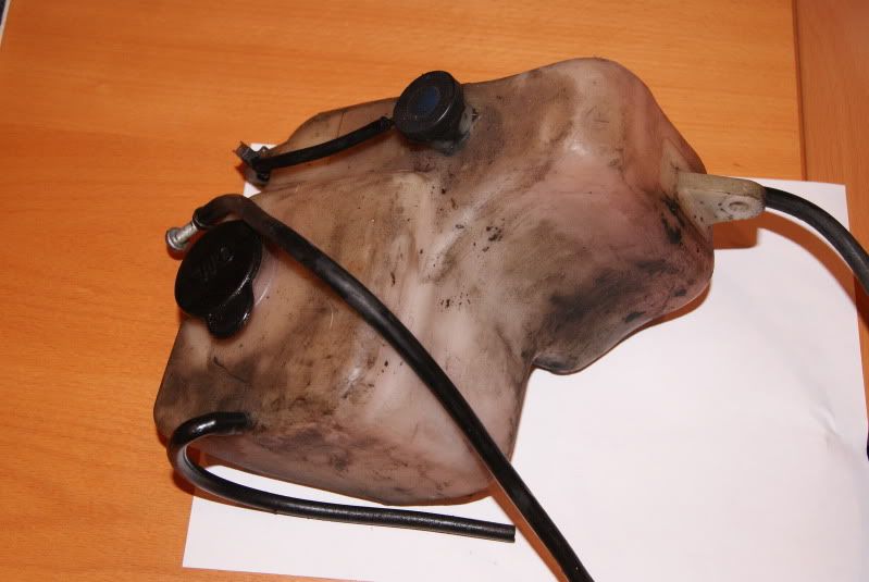

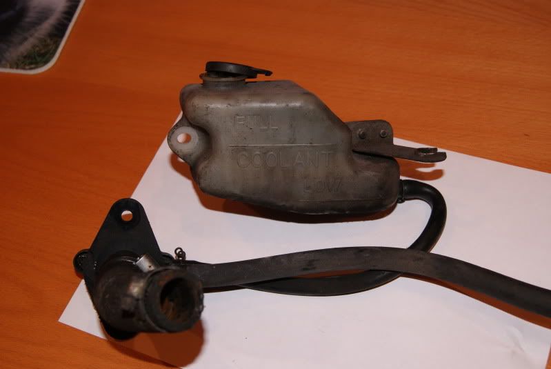

Made a start today on the long list of bits that just need cleaning up. Oil tank and coolant tank look like they had 25 years of crud on them; A combination of Cillet Ban, oven cleaner, cellulose thinners, bleach and a 2 hour cycle in the dishwasher( not mine) and they look a bit better; I will probably drill the rivets out on the coolant tank bracket so I can rub it down and respray, and fix back on with stainless button heads. Nights tomorrow, so if it's quiet then these are next; Dusty

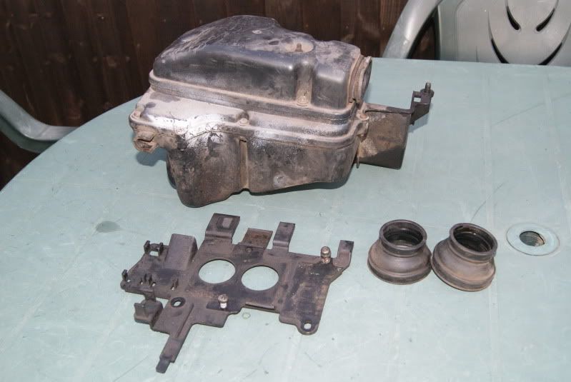

Just got in from an uneventfull night shift Airbox was stripped down last night, scrubbed to within an inch of its life then reassembled, getting some colour back along the way; Dusty

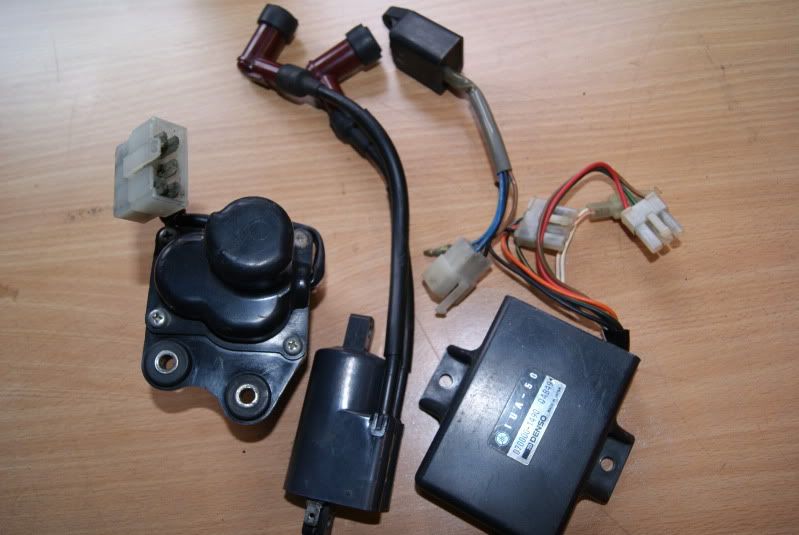

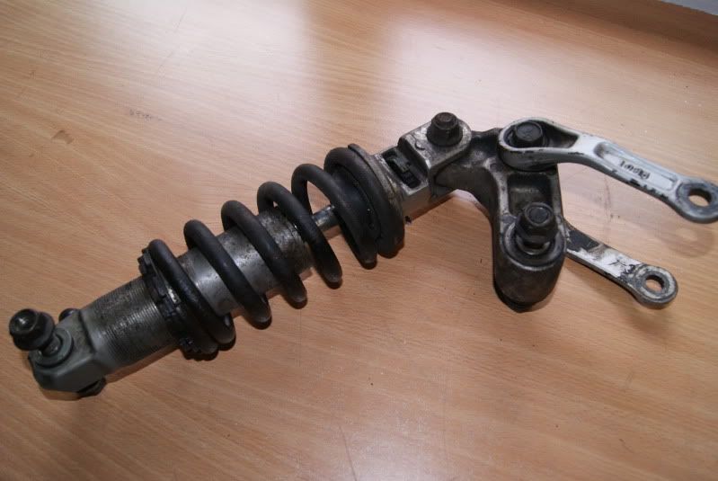

Cleaned the electrics up the other night; I also polished the Microns which came up pretty good. Shock has been dismantled today as it is filthy; I need to get the spring powdercoated but I can sort the rest myself as it is an ally body. I was in Aldi yesterday and bought an angle grinder and loads of cutting/sanding discs. Got carried away this morning and got rid of all the fairing brackets that wont be needed; I chopped off the steering lock boss as it interferred with the ignition switch. I never leave my bikes unattended so wont be using the steering lock. Must get back to the Hybrid Lc build and get it finished Dusty

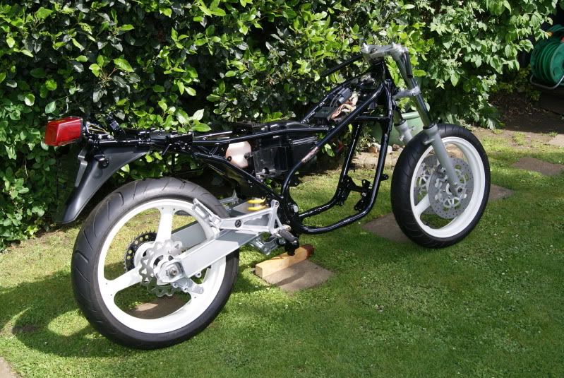

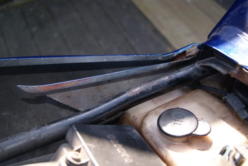

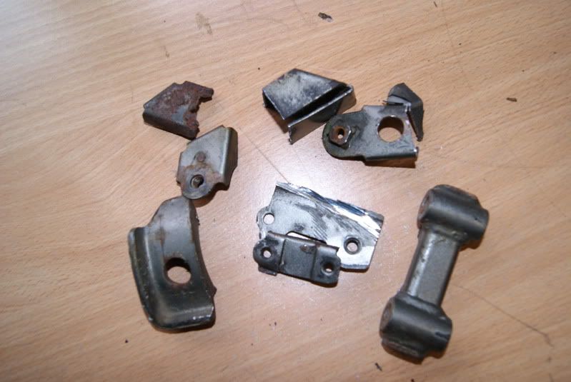

Update time ! Once totally stripped I found that the rear of the frame had been chopped off so the Cbr seat could be fitted . Also, the plates for the shock linkage looked a bit rough. After much deliberation, I thought it easier to get a standard F2 frame and start the rebuild with that. Only issue is that there are no numbers on the headstock I ground off all the fairing brackets again, and took measurements for the shock linkage plates. I bought some heavy duty metal plate, cut and shaped it and got my local engineering firm to properly weld it in. Then the frame, side stand, replacement rear light support, tie bars, engine mounting plates and a couple other bits went off to Microblast for powdercoating in gloss black. I bought a good F2 rear mudguard and rear light, and ebay turned up some standard side panels in very good condition. The swingarm was stripped and resprayed along with the rear brake carrier, the shock was stripped down and polished whilst the spring was being powdercoated. I had to replace one of the needle bearings in the linkage but thankfully the others were fine. I had the footrests vapour blasted, plus I had the discs blasted clean too. I did have it on ebay at one point as I got a bit bogged down with it, but I removed it and am perserveering!! Lots to do still. Fork legs need paint removing so I can get them polished. All brake calipers need the paint stripping off them, and I have rubbed down and primered the front muddie ready for a red/white speedblock design. I bought a good F2 seat and the tank is in really good nic so that's a bonus. The plan is for risers to be welded on so I can use Lc bars, plus I want to use Lc clocks. I sold the Microns to fund the powdercoating, but pipes will be one of the last things on the list !! I will try and update this one a little more often Dusty

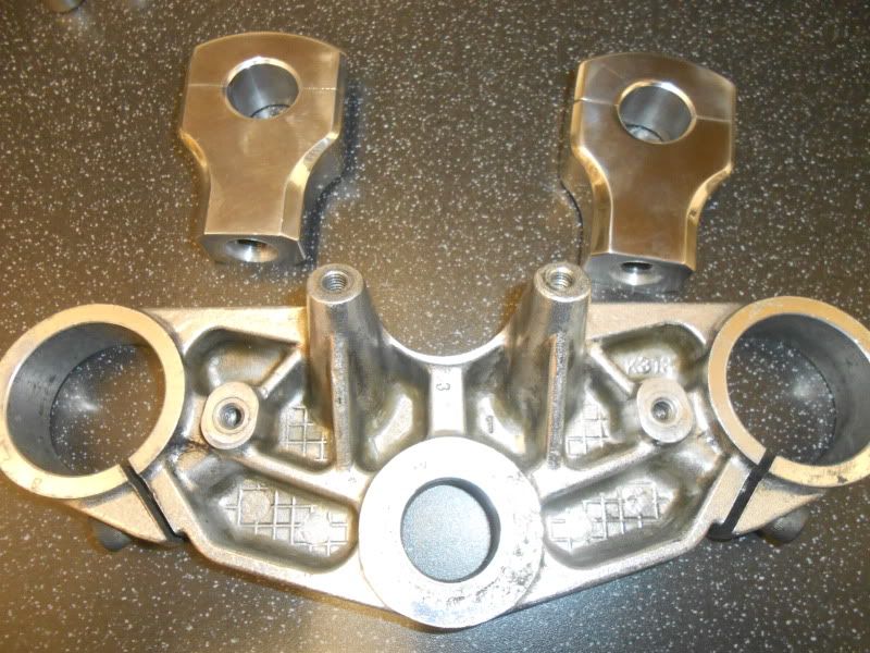

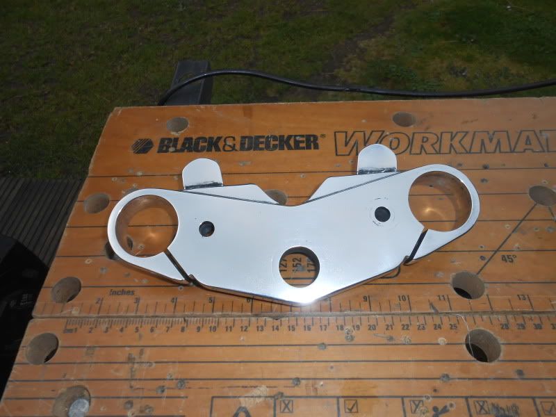

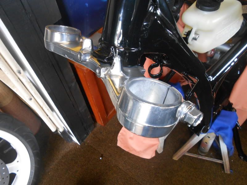

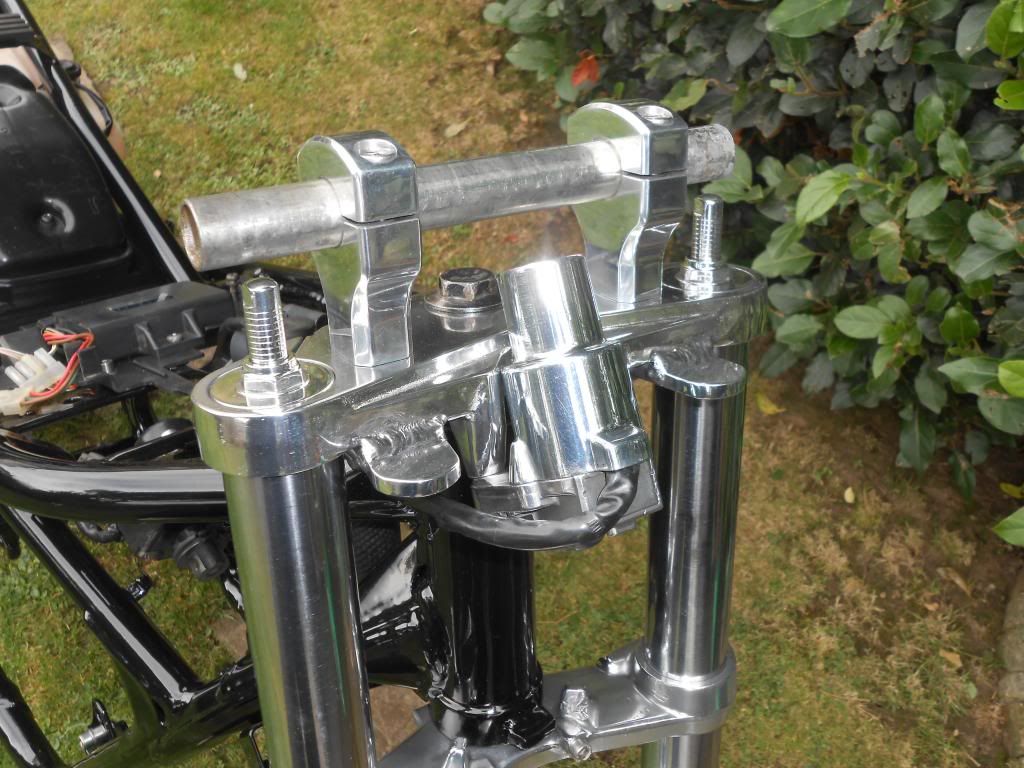

Hi, Forks are now polished and I have some fresh oil to go in them. I have also binned the idea of using the Rd400 bar risers as they wont elevate the bars high enough to clear the fork adjusters, so I got some nice custom risers off ebay that will do the job. I am going to drill through the two threaded bosses you can see on the underside of the yoke. This means the risers are spread a little further apart than I would have liked, but this is the strongest part of the yoke to take the M10 riser bolts, plus I know the bolt holes will be in exactly the right place; I am also making some brackets that will allow fitment of the Lc clock bracket. Hopefully post pics up of those in the next day or so. Dusty
Post by dusty350 on Sept 28, 2012 13:27:37 GMT 1
Hi, I made the tabs for the clock bracket out of 6mm ally, and got my local engineering place to run some weld along the front edge of the yoke to make a nice strong bracket. The bolts for the risers pass through the back of the brackets too; I also removed the anodised finish off the yokes and polished them up a bit. Trouble is, once you've got a polishing kit, you can get carried away. The paint was manky on the ignition housing and it was easier to polish it than paint it . Forks are done, with new oil and stainless bolts; Bottom yoke had been vapour blasted previously, so gave it a quick spruce up; The risers bolt up nicely giving plenty of room for the fork preload adjusters; And here's a rough mock up of the clock positioning; I haven't tried to mirror polish any of the components as I know that it is harder to keep them scratch free in the future. I want to give them a going over with Solvol every now and then, so wont be after a perfect finish. I also cleaned the surface rust off the front discs. They are cast iron PFM discs, so will rust a bit, but i will give them a light coating of oil whilst I am building the bike. Must give a quick mention to my faithfull assistant, who keeps me amused by running off down the garden with my polishing mops Dusty

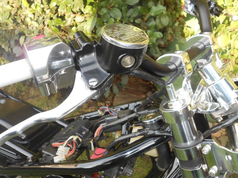

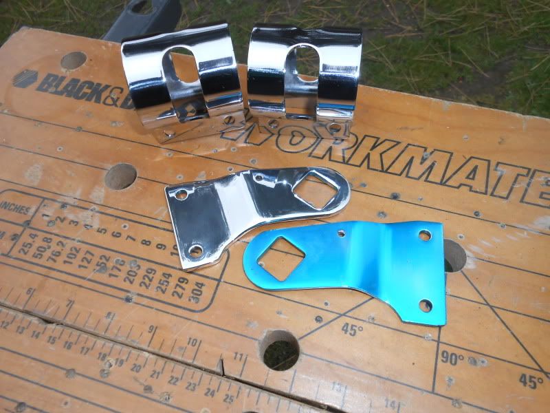

Got some more done recently. I was going to invest in new headlight brackets, but decided on salvaging my originals to save some money; The clamps had light rust forming but the polishing mops got them back. The blue anodising took a bit more effort but got there eventually. I rubbed down and resprayed the clutch perch and master cylinder and polished the cylinder lid; I polished the levers too, the Kawasaki brake lever took ages as it had a really tough anodised finish. I did fork out on some nice Renthals. I took the switchgear apart and couldn't decide wether to paint or polish. I thought paint might wear too easily so a bit more time with the polishing mops. Next job is to offer up the headlight shell and get the brackets bolted up tight, and then I will fix the instruments bracket. Dusty

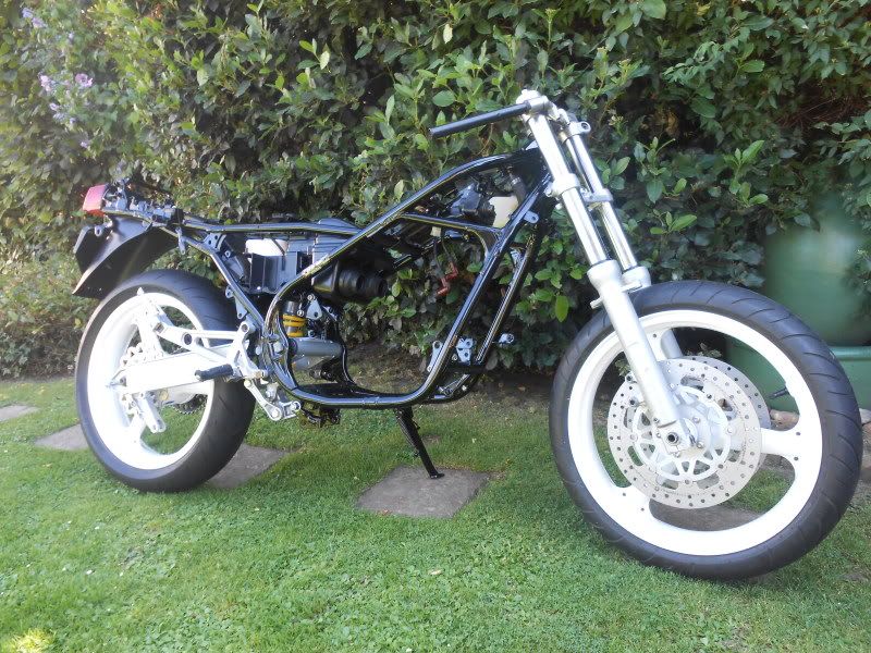

Post by dusty350 on Oct 24, 2012 18:30:28 GMT 1

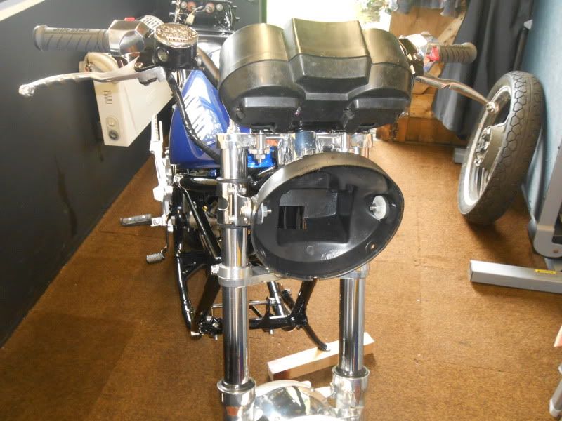

I have sort of achieved my target for this project for this year. I wanted to get a rolling chassis together which I have managed. I hope to get a new headlight, twin horns and indicators sorted out in the next few weeks, plus there are some small jobs to do to existing parts. I want to make up some decals for the front mudguard, plus polish the petrol cap and rub down and primer the tank. I have resprayed the rad but I may do it again as I used a gloss rather than a satin, and I think a satin would look better. More soon.
